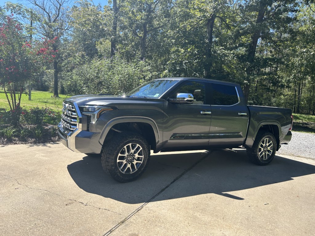

    I did RC 1.75 on front and nothing in rear on my 24 Limited. Only needed alignment, & upsized tires to 285/65R20. It sits 1/2 higher in rear. I also put sumo springs in rear to keep rear from sagging while towing. I'll see how this setup works & may add a half inch or so to rear only if I need it. 20241011_155426.jpg

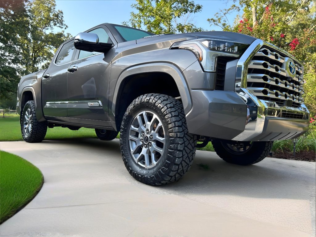

    I’m sure you’ll love the kit you’re considering. I went just a little higher and went with the RC 3.5” kit and 35x11.5. Just in case you might be wondering what a little more lift looks like, here’s how mine looks…

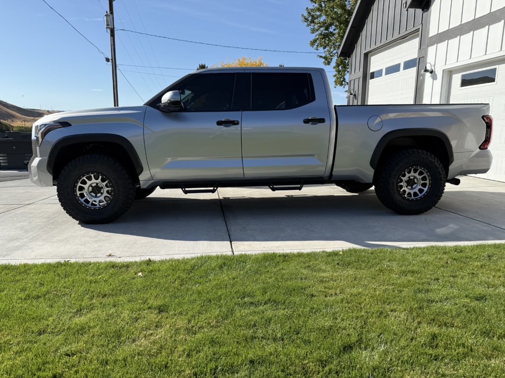

    1.75” front nothing in the rear. 35X12.50X17 0 offset. Slight rake not towing.

    Fair point. Just a thought… My wife and kids (they’re grown) have to use the step bars even at factory height, so it didn’t matter for me. And the tires really are the only factor in your mileage, and going to LT tires won’t matter between 34” and 35”. In fact, I lost about 3 mpg going to these tires (remember to correct for the diameter change — a lot of people forget this), and it is the exact same amount I lost on my last truck going to LTs, even though I stayed the factory size with them.
