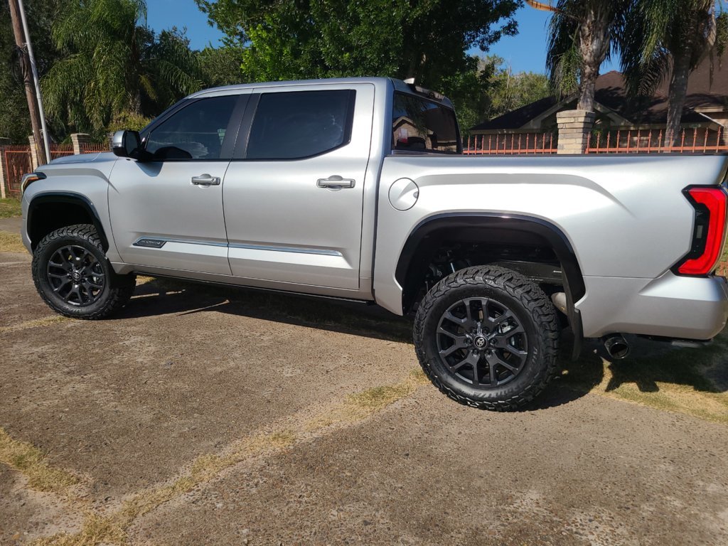

    I recently purchased 2025 Platinum with rear air and AVS and installed lift, 3" SST Lift Kit With CV Axle - 2022-2025 Toyota Tundra Rear Air 4WD with KO3s 295/60/20 on stock wheels. The ride is great, I do notice a small rake, but I'll leave it that way for now. Still in the first week, have to try towing, some 4x4 and longer drives.

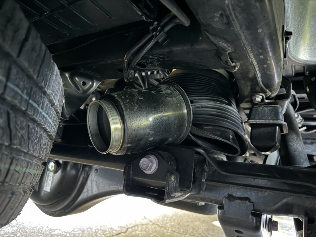

    I would try the ready lift after my 23 plat with avs leveling rear bag popped towing my airstream. The other lift did not use rear spacers.
    Long story short I would never own a factory air bag system for a towing truck again! Bilstein 61’s all the way around with an aftermarket air bag system that is much more reliable and controllable!

    did you have a lift that over extended the bags vs spacing them?

    Airstreams vary for tongue weight 27-28’ are less than 25’.
    That said 25’ is what popped the bag.

    Had spacers up front but did not need the rear arms to level. OEM arms were on the truck when air bag popped.

    Yes warranty covered but dealer had truck for over a month while parts were on order. Hmmmm.
    With a bag popped you ride on the bump stops then which did damage to airstream grrrr.
    Traded truck in for 25 without avs
    I will say dealer tried to wiggle out of warranty tho but knowledge and firmness prevailed
