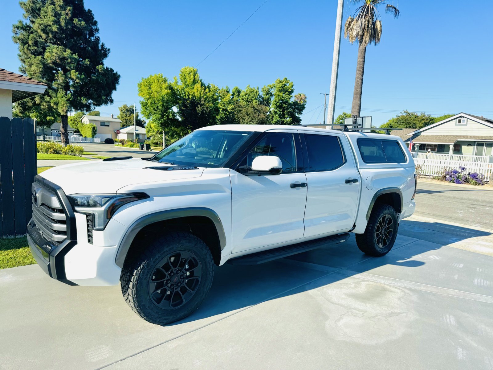

  27. Jul 19, 2024 at 6:00 PM
    #597
    JMitch
    JMitch New Member
    Feb 16, 2023
    #92173
    20
    James
    2023 Tundra Limited 4x4 Hybrid
    Put it in What have you done to your Tundra today also. But wanted to put it here as this is where I did a bunch of reading/research before pulling the trigger.
    Added a 2” Front and rear lift to my 2023 Limited Hybrid Crew with AVS. Now on 34” Nitto Recon Grapplers. Used the Readylift SST 2” lift for the rear, but replaced the shock rather than using shock extensions with an N3 from Rough Country. Added the N3 strut from Rough Country up front. Everything is an even 2” higher and has about 1” of rake. Rides same as factory as far as I can tell. I thinkit’s a nice proportion for these trucks.
    My bad - not AVS - load leveling.
  28. Jul 19, 2024 at 7:32 PM
    #598
    DaveE
    DaveE New Member
    Dec 8, 2022
    #88089
    66
    2023 Platinum Hybrid, Magnetic Gray
    so you no longer have AVS since you placed the “adaptive variable suspension” strut?
    ziznack likes this.
  29. Jul 19, 2024 at 7:33 PM
    #599
    ziznack
    ziznack New Member
    Aug 24, 2022
    #82383
    531
    Texas Y'all
    2024 Lunar Rock Platinum
    At least not in the back lol
    DaveE[QUOTED] likes this.
  30. Jul 19, 2024 at 8:38 PM
    #600
    eddiefromcali
    eddiefromcali New Member
    Mar 14, 2022
    #75818
    2,982
    Eddie
    2022 Tundra Platinum
    100% Stock
    Maybe he just had load leveling? Looks like a lower trim
