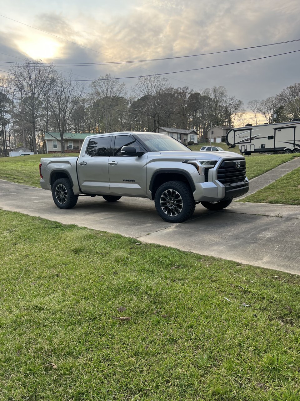

    I did buy spacers from spydertrax just to make sure my tires would fit, which does put the tires about even with the fenders but I didn’t have to cut any inner fenders or anything. No rubbing at all
    ziznack[QUOTED] likes this.
  12. Apr 29, 2023 at 7:18 AM
    #462
    ziznack
    ziznack New Member
    Aug 24, 2022
    #82383
    539
    Texas Y'all
    2024 Lunar Rock Platinum
    Looks great!
