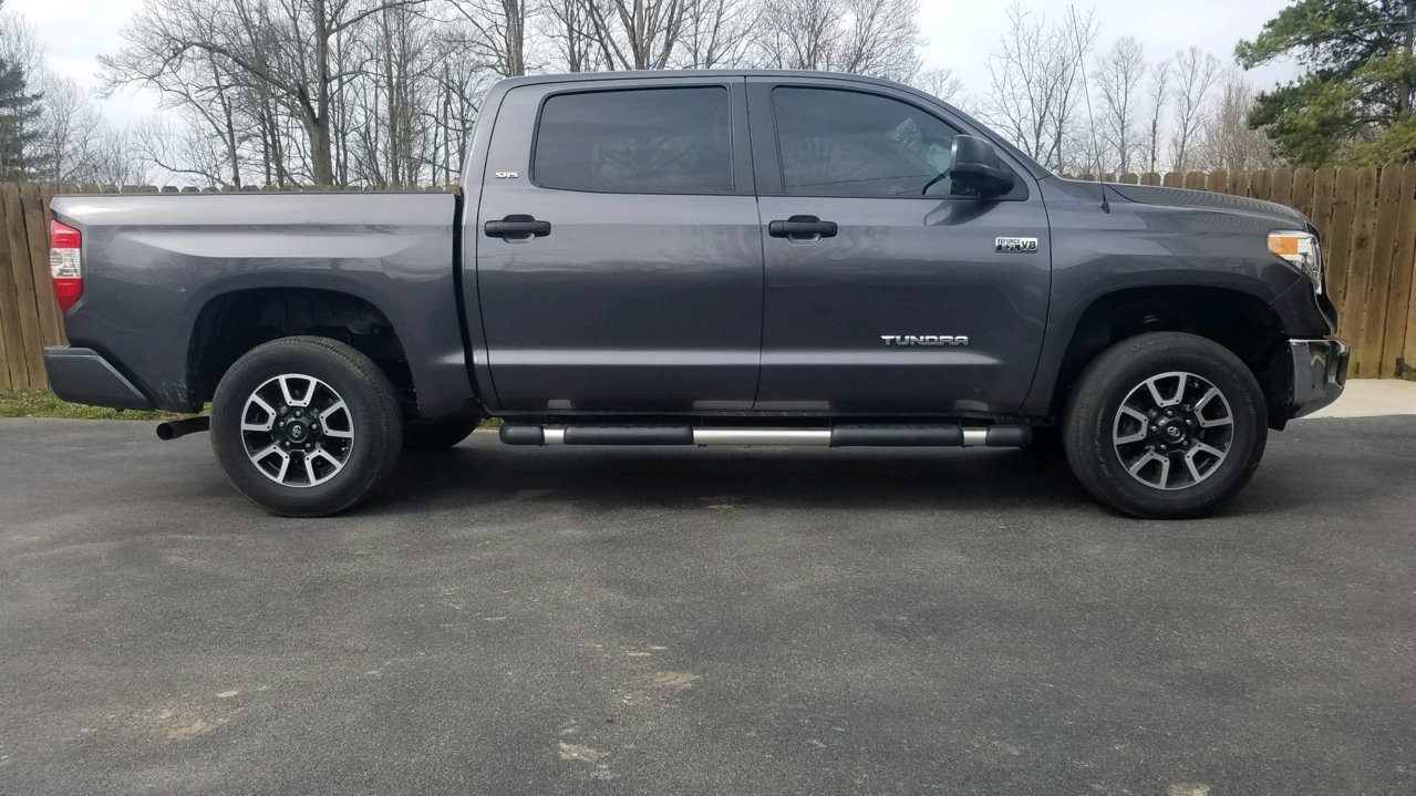

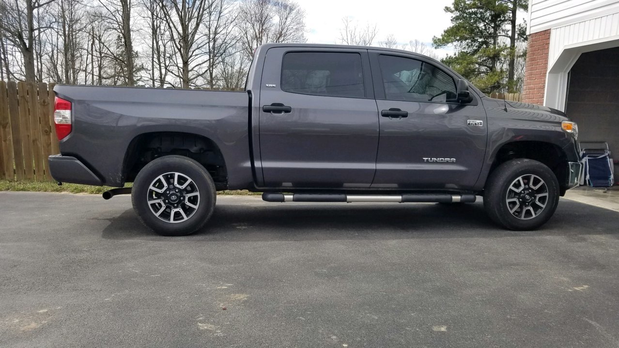

    I recently installed the eibach /toytec coilovers set at 2.5" (1 coachbuilder shim on the driver's side) with a 1" block in the rear. I stuck to 2.5" instead of 3" simply so I could avoid getting ucas.
    The truck doesn't sit exactly like I wanted. With the block it's too high in the rear and without its too low. With the block the measurements from center of wheel to fender are 24.75 in the rear and 23.75 in the front.
    My question is should I install another shim up front on each side to level it out and hope I don't have alignment issues or take my 1" block and have a machinest friend of mine machine it down to 1/2 "? I'm looking to run 295 70 18 on stock trd wheels fyi.

    With and without the rear 1" block

    Obviously different angles on the pictures and my driveway isn't exactly level. But I did the measurements on the garage concrete so they are correct.

    I like it with rake personally...but it is your truck. You can add another shim to ds and one to pass side. I would call toytec to confirm. i did mine at 2.5 6112 one driver shim and added diff drop... but stock uca and all is well.

    Get a +1 coachbuilder shackle. Although I think it looks good with the block in. Once you get some better tires you might like it.
    I’m lifted only 2 inches in the front in my truck sits pretty much completely level. I’ve been thinking about going with +2 coachbuilder shackles.

    I don't know why... but to me that does not look like 2.5... not calling you a liar. jus sayin. looks like 1.9 to me.

    Honestly it doesn't look like it to me either and I've leveled every truck I've ever owned. Dummy me forgot to write down my before level measurements....i ordered these straight from toytec though.

    It does look like 1.9 or 2 inches.
