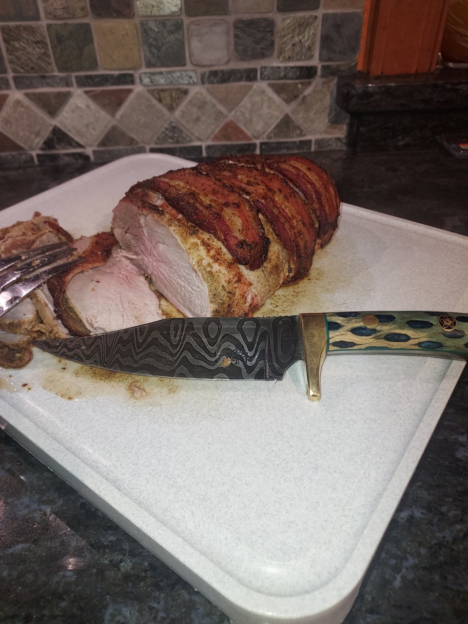

    RT doing its job. As much as I like the paring knife, this one is definitely a favorite.

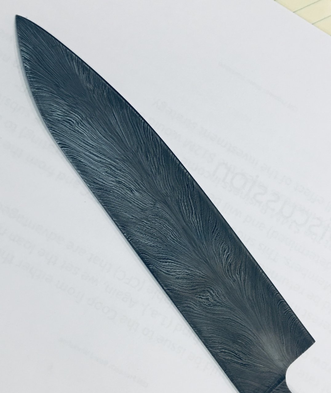

    Etched this chefs knife today. Working on the handle tomorrow E061234E-4BBB-4FE6-94B0-7D1802DCDD1A.jpg

    Holy Moly Ray!!!:) Love that pattern from the steel you put together?? When you say etched you mean just the logo part or no?? That looks amazing!! That is a great piece of work right there for sure!!!! Nice stuff Ray! Very NiCE!
    You have a talent Ray!
    I’d be afraid to use that one! It would just sit as a center piece:)

    Etched the entire blade today. I’ve been working on the edge bevel and preparing for the etch for several days since I completed the heat treatment. I finish the surface to a mirror finish, usually around 3,000 grit, before etching.
    As for function, it will be a high performance chefs knife. No need to baby it.

    Love that pattern.

    How many layers is that?
    what you did there is something else!
    I get it now! Ha!! Really like how that turned out, definition!

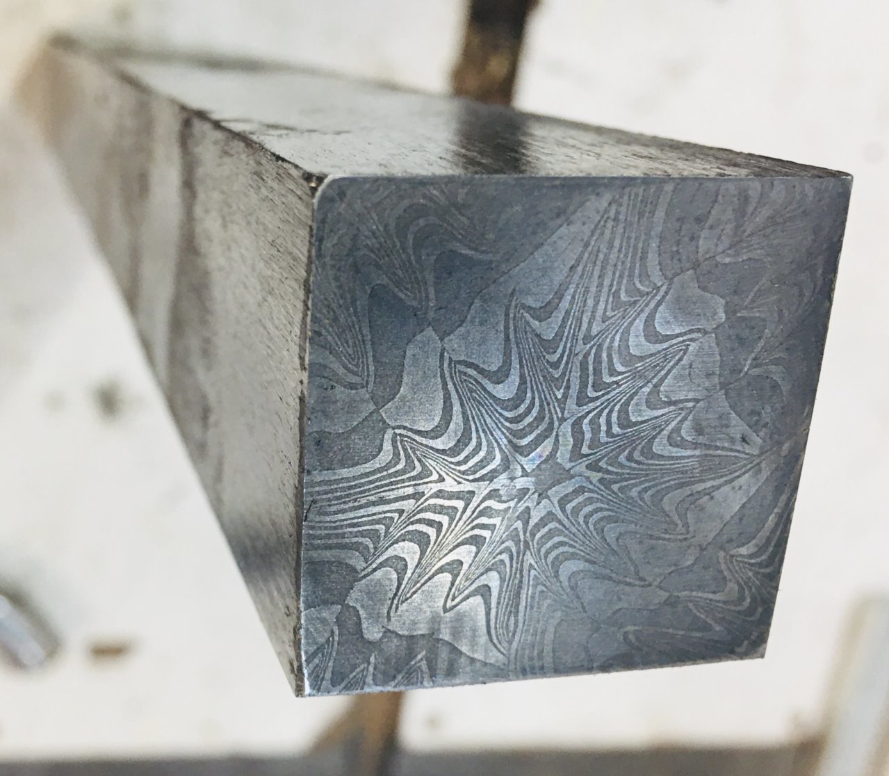

    FC068D5A-D7A3-46FF-93D1-C433F1E031F5.jpg As for the layers, the bar stock, before slicing, is 176 layers. This knife required 6 slices of the bar that were forge welded together , so I guess 1056 layers, although about a third of that is ending up hidden in the handle

    The time and the talent to get that bar like that is fricken awesome!!

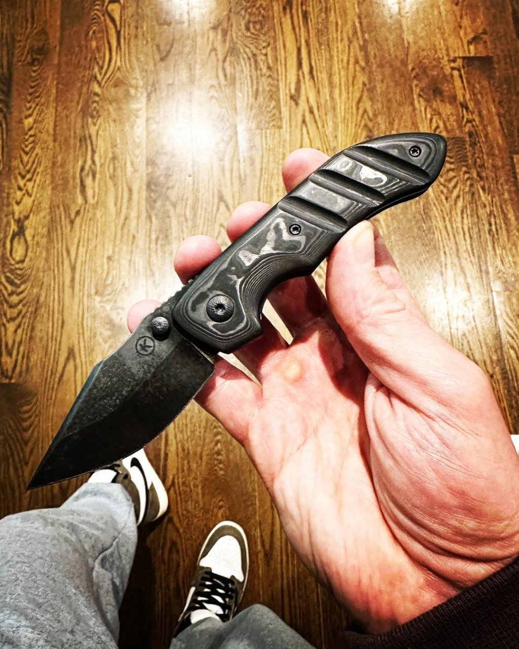

    Kendrick Ruiner....IYKYK

    Last one of those I saw sold for over $3,500. Pretty high for my blood. Definitely quality custom work!
