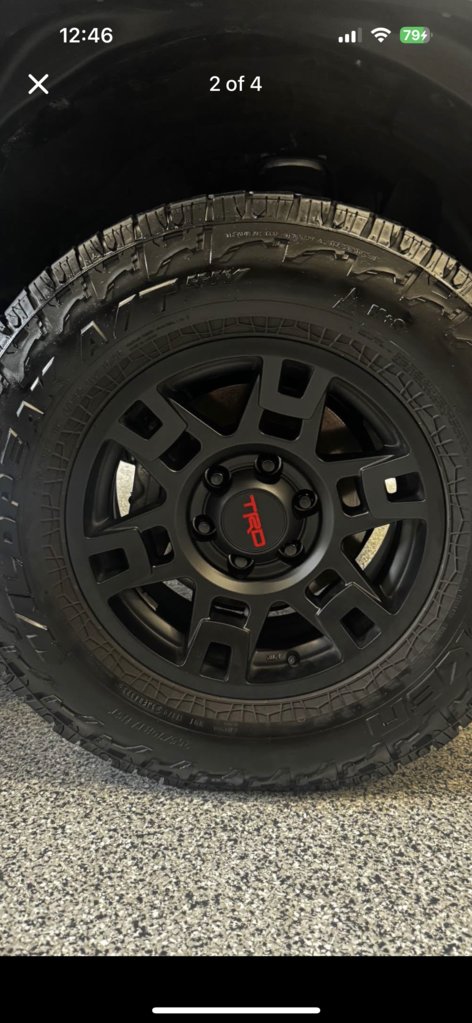

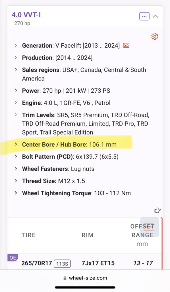

    So I know the 2024 Tacoma wheels won’t work due to hub bore size. But will the 2024 4runner wheels work. Because the 5th gen of the 4runner went from 2009-2024 vs the 3rd gen tacoma going from 2016-2023.
    The reason I ask is I found some trd pro wheels with wild peaks on them for around $1200 off a 2024.
    I’ll attach some screenshots of the wheel specs and part number. All the specs look correct, but I can’t seem to find the bore size. I also checked the wheel website and it said 2024 4runner was 106.1.

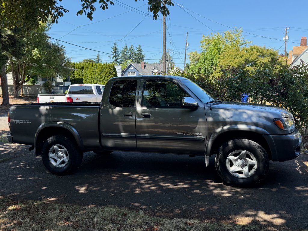

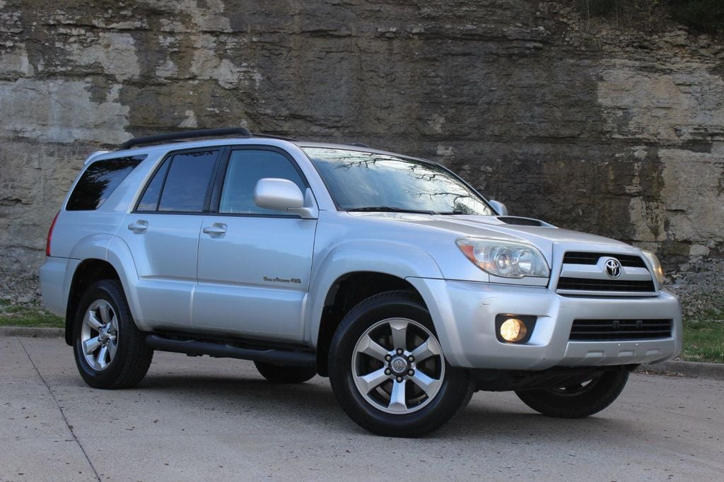

    I'm sure these would rub with stock ride height, and I haven't bothered checking the offset, but I keep looking at these 33" pizza cutters on craigslist. The snow flakes are really starting to grow on me.

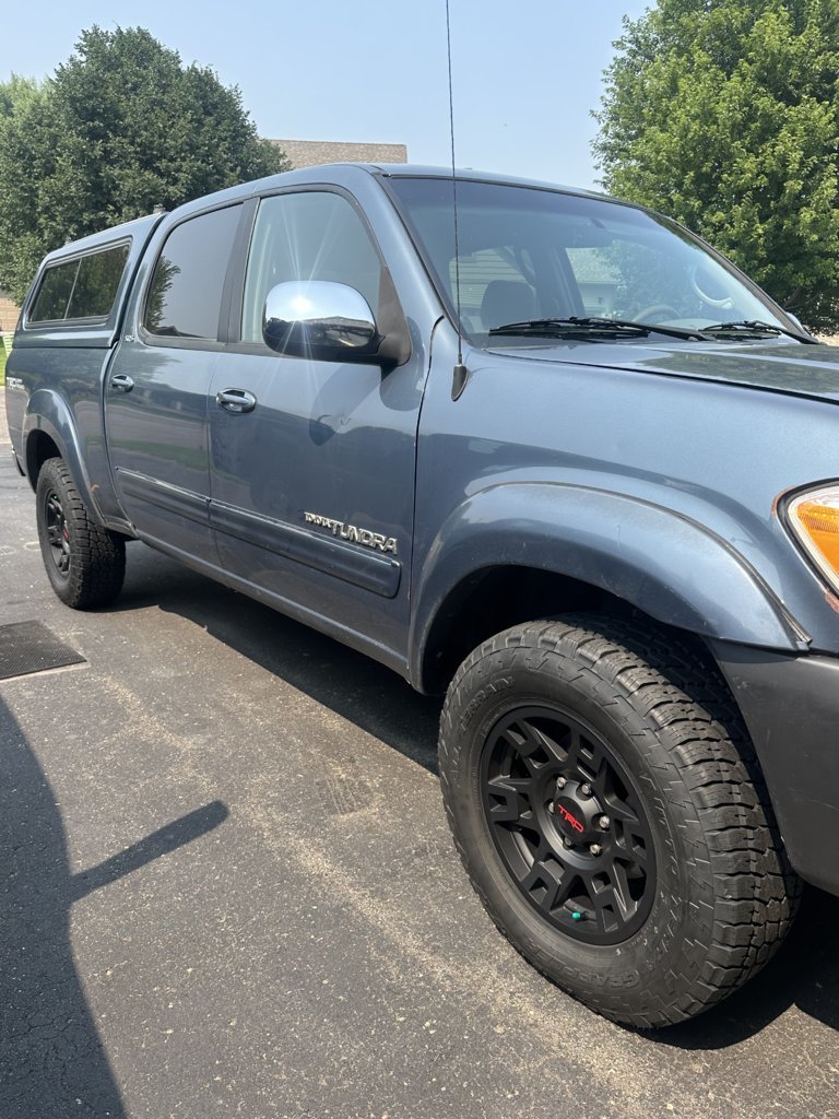

    6112s up front w/ 650 lb springs, 5160s in the rear, JBA UCAs, Suspension Maxx Links, ATS leafs w/ Wheeler's AAL and overload spring, Toyota Gloss Gunmetal TRD Wheels, Toyo Open Country AT3s 275/70/17

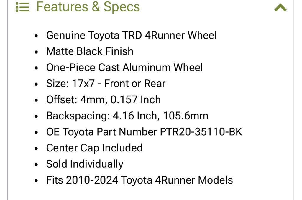

    I've got these and they fit. I think they technically are 5th gen 4 runner. See my profile pic. Here's the Part No.
    17" TRD Cast Aluminum Wheel - Gloss Gunmetal Gray
    Part Number: PTR20-35110-G4
    Website doesn't give bore size on mine, but it does give this:
    BOLT CIRCLE / P.C.D. 6x139.7

    yes these fit fine, i "think" off memory they stick out like 0.3" further than the OEM wheels but the hub and lug spacing is the same.

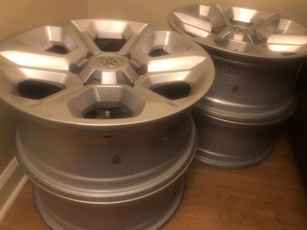

    Found a set of 4runner snow flakes for $180. Pretty tempted to go grab them and sit on them until it's time for new tires.
    Maybe hold on to my starfish in case I ever decide to get a set of proper winter tires.

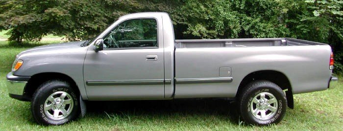

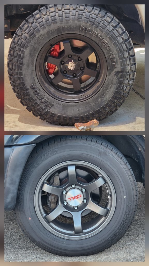

    My wheels in 2003...
    today's wheels.
