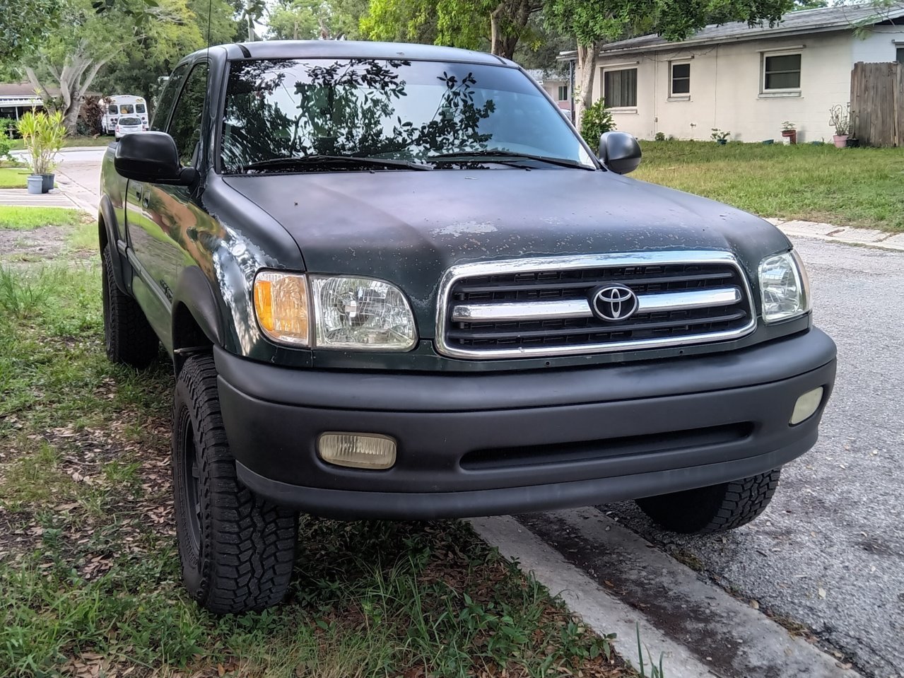

    I like them shifty. What are you thinking of swapping too?
    OP, here are my cheap pro comp 69's. 16X8.5" with -4.5. MT Baja EXP 265/75/16

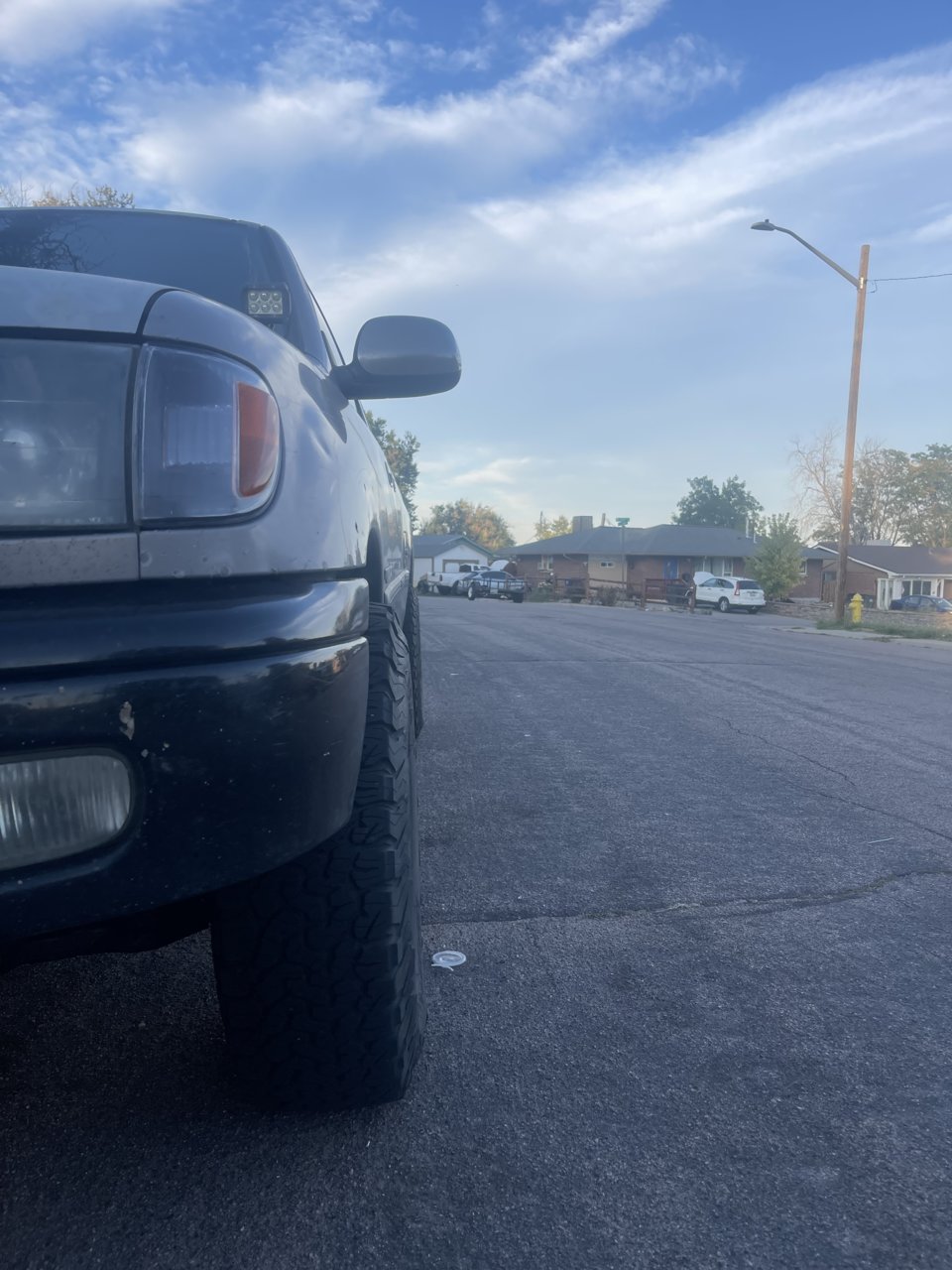

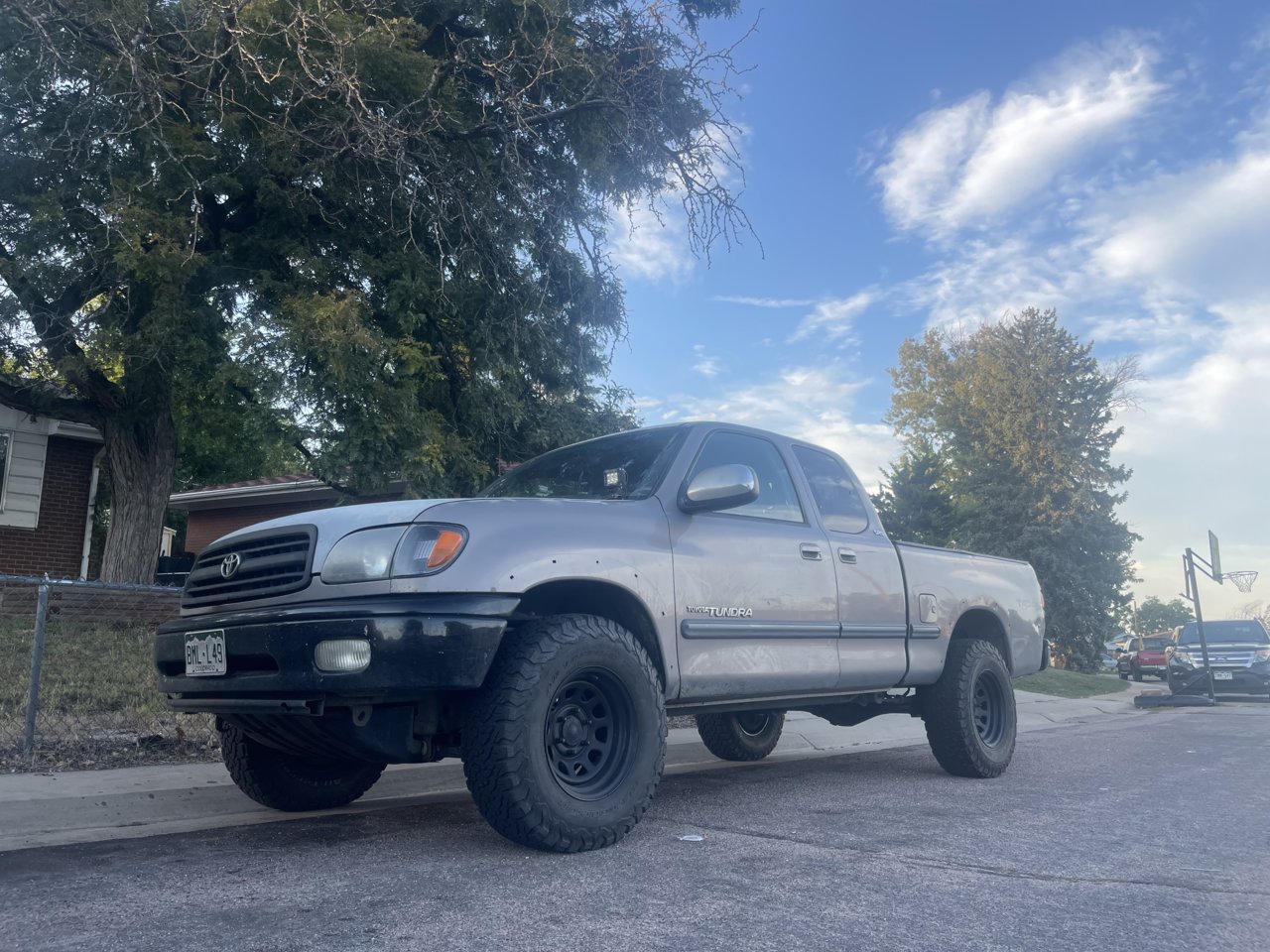

    A Set of Random steelies I found on facebook for cheap!
    Im running 265/75/16 Ko2's on 16x8 with 4.5 backspacing and no spacers

    No rubbing at full lock in either direction, while in forward or reverse?

    Thats same size im running in theory, and surprising no rub, even when flexing. It is close, i will prob look for slightly more narrow tire next go around.
