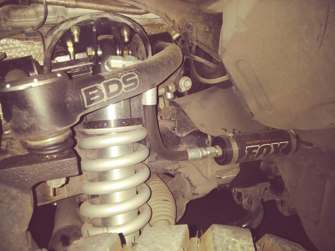

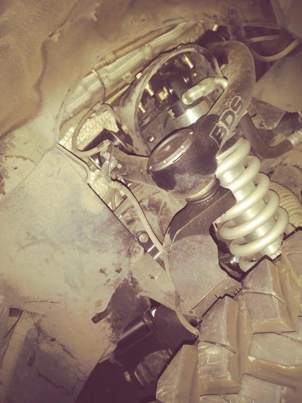

    I don t understand the part about the reservoirs. It s a flexable hose. If they are in the way it can be bent and mounted so as to not be in the way. My lift probably helps but the line is not near the tires. Even if it was I could tuck the res into a spot that would be out of the way.
    In my case there are no problems with the brake lines either. But those too can be moved out of the way. If you are talking about using stock geometry brake lines maybe, but if you are lifting truck re routing brake lines are probably a good idea anyway. In my case; a necessesity.
