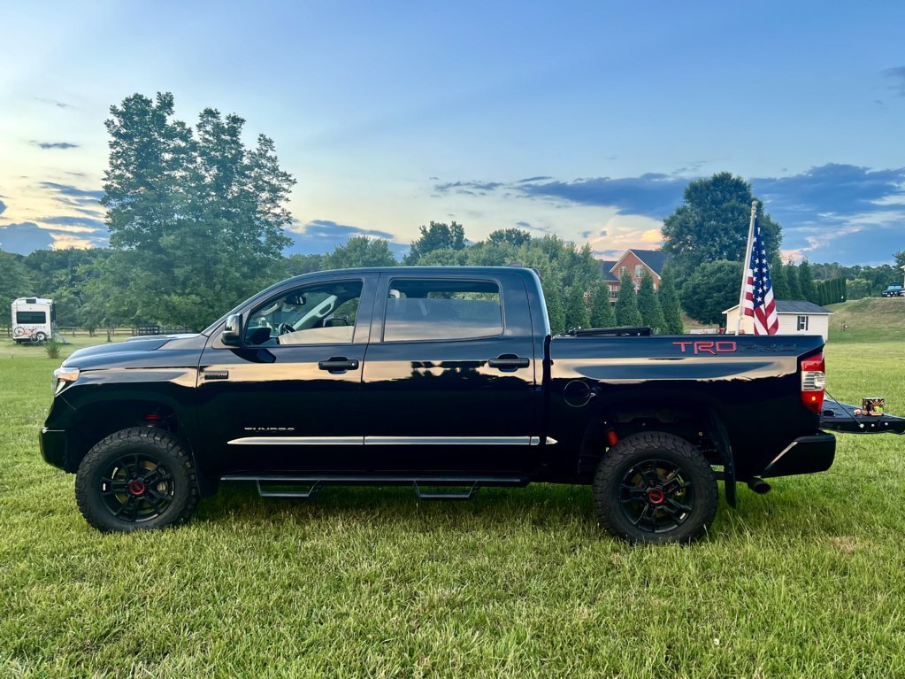

    Thought I'd post an update here... Not a Pro, but she's leveled so essentially the same height as a pro. And she's got the pro BBS wheels. :cool:
    2021 Platinum with new BFG KO3 in 295/70 R18.
    My thoughts after about 100 miles... I upgraded from stock size street tires, so keep that in mind.
    1. They're smaller than I anticipated. BFG's website has them listed at 34.3" tall and 11.8" wide. Mine are nowhere near that. Only about 33" tall and maaaaybe 10.5" wide? This is at 42 PSI right after Discount Tire installed them. (And yes, they are 295/70/r18.) I honestly thought Discount had installed the wrong size when I first saw them because I expected them to be wider. But in all honesty, I think they look perfect.
    EDIT: WhiteSR5 made a good point that the vertical measurement will be off as the tire is under load. When measured horizontally, the diameter is much closer to the advertised 34.3. Hard to tell exactly but it looks to be spot on.
    Width-wise, the tread itself is not the widest part of the tire. By my eyeballs it's about 11.5" or so at the widest point.
    2. On the road, these things are sticky. Feels a little more sluggish than the stock tires, but I expected that.
    No balancing issues so far.
    Impressively quiet, I must say. The increase in road noise over stock is marginal if any.
    Haven't driven enough to report on MPG.
    Also haven't taken them off-road (I don't do much of that with this truck anyway), and it hasn't snowed here yet, so I can't speak to that. We're supposed to get some storms this week though, so if that's the case I'll report back.

    Yep! The KO3’s are supposed to have much better wet traction. We did get some rain here last night. I will say it wasn’t easy to break them loose.

    You can always bring a tape measure with you and if you don’t like the way they look then say it’s not what you ordered.
    Discount tire and BFG websites both list the height at 34.3”.
    For me, the size is actually perfect. But I was shocked at the difference between what was listed and what they actually are. Maybe 34.3” is the height with an unmounted tire and no load? :notsure:

    try measuring across the tire horizontally. Your vertical measurement will be off because the tire is compressing under load.

    Ah, you are correct... Why didn't I think of that? :facepalm:
    Roughly 34" across and about 11.5" wide at the widest point of the tire. As mentioned above, the tread itself is not the widest point of the tire.
    Still - all smiles here so far!

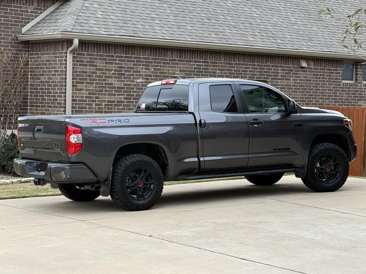

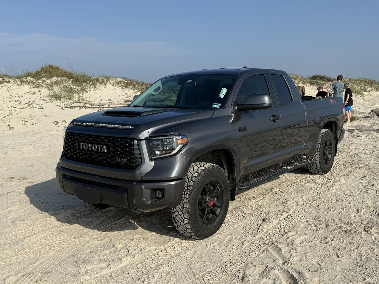

    #197 2021 Tundra TRD Pro Double Cab ordered in it's final model year. You could only get a TRD Pro double cab in 2021 buy ordering one. I ordered five weeks before Toyota closed down orders for that year. I would argue my TRD Pro is one of the rarest Tundra's ever made. 285/70/18 Nitto Ridge Grapplers. RCI rock sliders Leer Tonneau Cover NSV Hood Mounted Lightbar. Genuine Cooling Systems Transmission Cooler (FU Toyota for taking the coolers off in the 1st place WTF) Suspension air bags for better towing.
    I run 285/70/18 Ridge Grappler's on my 2021 TRD Pro. A big reason why I run that size is they are 19 lbs. a piece lighter than the 295/70/18 version, and my cousin who has a 2019 Tundra with the 295/70/18's gets 2-3 MPG hit, while in my 2021 I don't believe the 285/70/18's impact my MPG at all. IMHO the 4.30 rear end does really well up until you get to the weight of the 295's, and then 295 and bigger it starts to impact the MPG quite a bit. My wife and I just went to a wedding in Louisiana last week (we live in Texas), and I got 17.4 MPG the entire trip. For a truck rated 13/17 that's pretty dang good. In town I typically average about 15 to 15.5 mpg.
