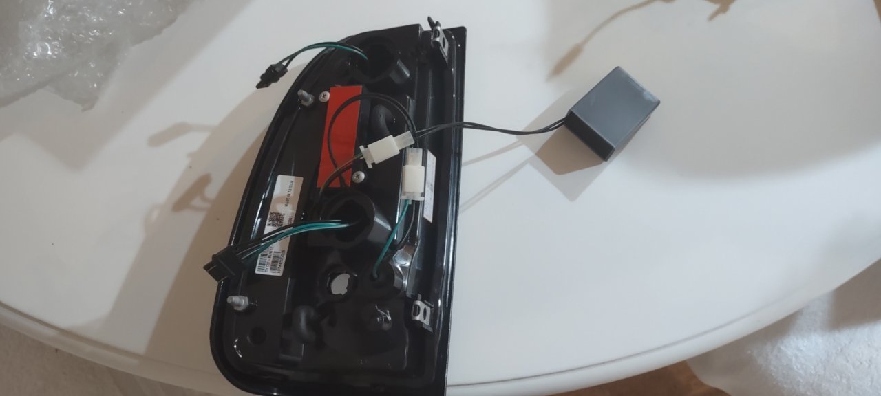

    I bought some led c style bar tailights the other day and there was a problem I ran into where the brakes and everything would work fine until you turn on the running light. Once the running light is on everything but the brakes would work even if you have the turn signal those same LEDs would turn on unless you're trying to use the brake light. im suspecting it is something to do with tailights wiring harness connectors being damaged or burnt. i dont think i have any blown fuses if that helps.

    I ended up cutting the wiring on it trying to wire it to the harness last night but I don't think they'll take them anymore. The part number for it is
    03-TR00TLEDAC-C and they are made in Taiwan

    Another thought is unlike incandescant bulbs, LED only work with correct polarity. Try reversing.

    2002 tundra limited
    I just got the ones off Amazon and this time only one came on but the brake light goes off after a minute or so. I'm wondering if I should replace my connectors and see if that works
