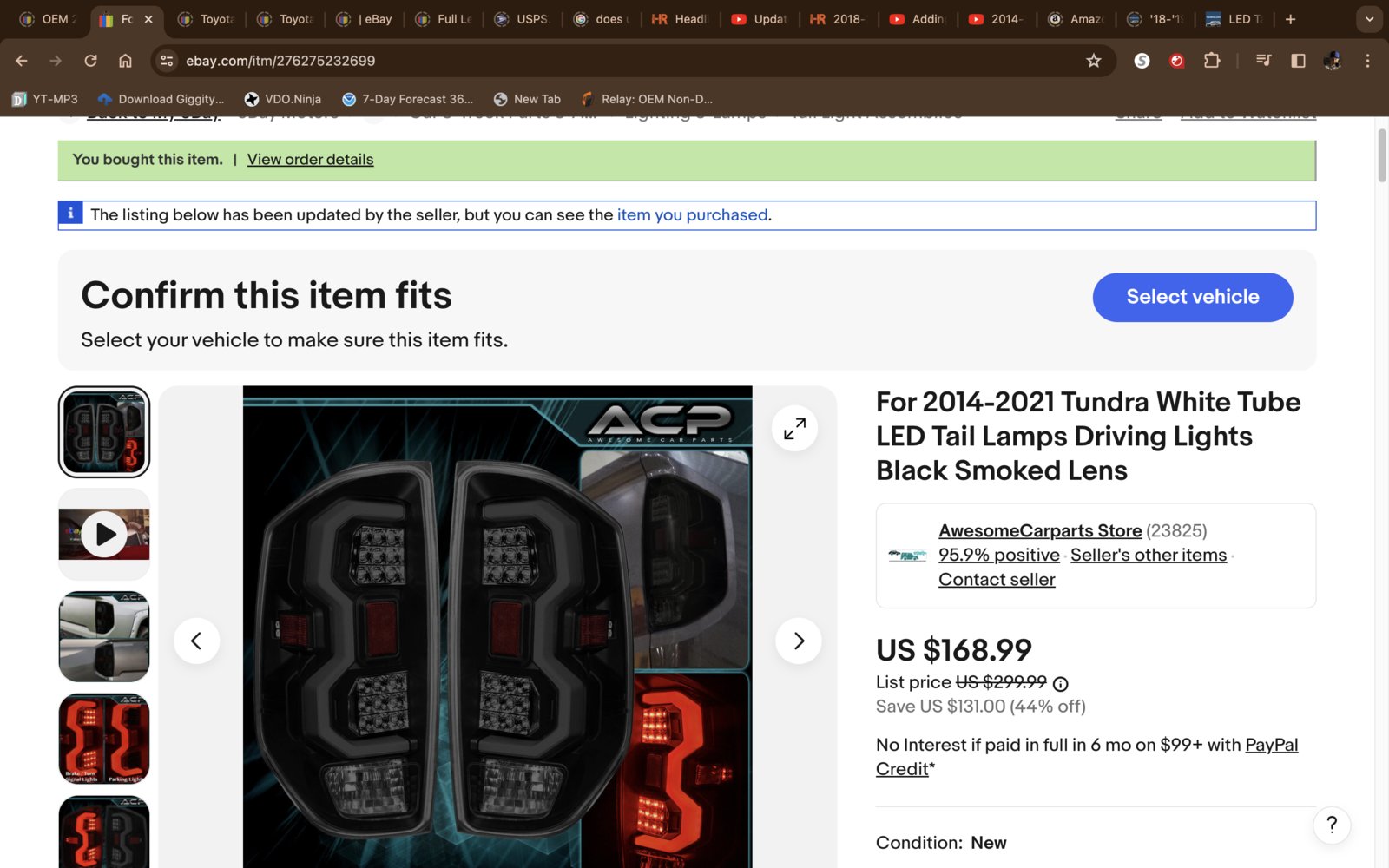

    Please dont kill me for asking rookie questions, but I have never had a newer truck and I am new to the LED game lol
    I ordered these the other day off of Ebay. I want to swap out the regular bulbs for LED's but I am lost in the sauce as to what I will need. Again, Im new to LED lighting so can someone point me in the right direction on if I will need resistors or any special harness? Just whatever I will need so they work right and doesn't hyperflash.
    Also, what are some good LED's that wont break the bank. Are the Sylvania ones any good?
    Thanks in advance!!

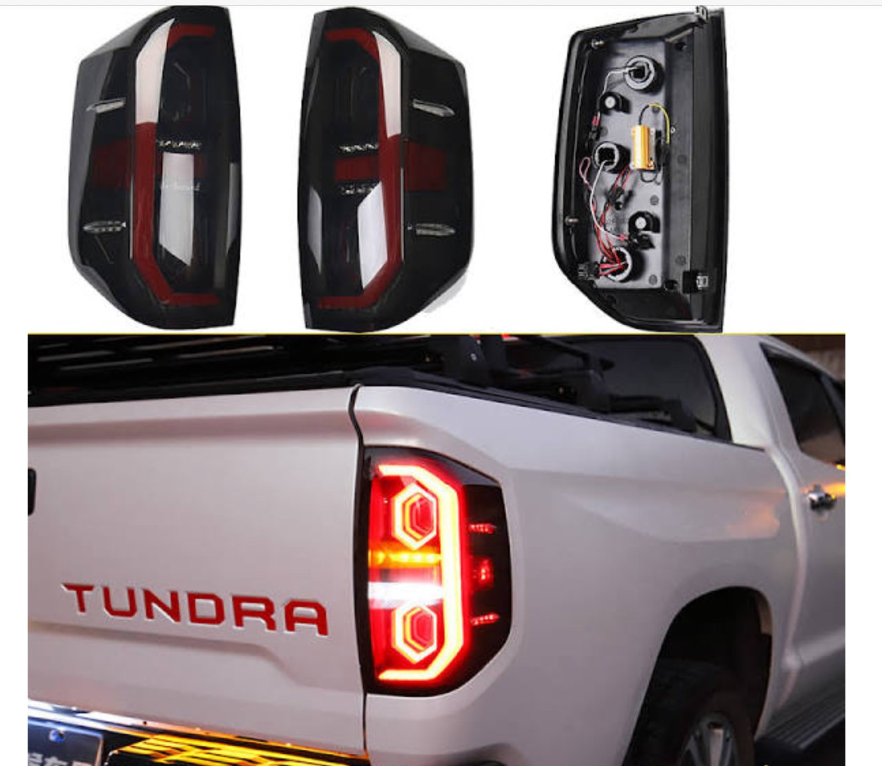

    Upon looking at those plugs, they probably just plug into where the bulbs plug in now.
    Some aftermarket tail lights still use a bulb for reverse, but these don't seem to be that way.
    It doesn't say anything about internal resistors, you'll just have to install them and see if they hyperflash.
    If they do, VLEDs make some nice resistors.
    You can mount them behind the tail lights.
    g0uw0iy9_cb97e2ca21c32f29848c5903dea93b9505ce7a8c.jpgwnmu2z5a_cbfd61148927f48fe11b9e53938f0477943ae036.jpg
    Just for rears.
    2 LED TURN SIGNAL HYPERFLASH FIX (vleds.com)
    You might consider getting this one if you have any intention of putting LED turn signal in front and rear.
    4 LED TURN SIGNAL HYPERFLASH FIX (vleds.com)
    Good luck

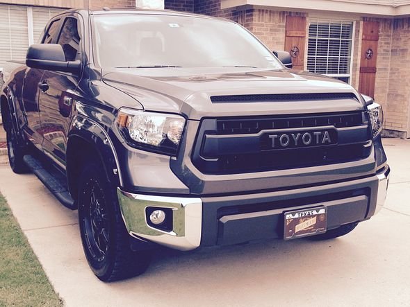

    From this..
    94B1C49A-A66D-4F31-99DA-6BD45F492426_zps_1880508731d819dfee9b9f1441c35f1a10921424.jpg
    To this.
  15. Feb 25, 2024 at 8:41 PM

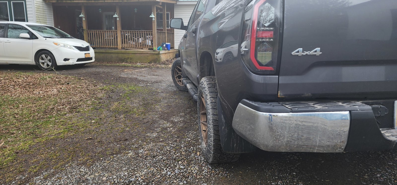

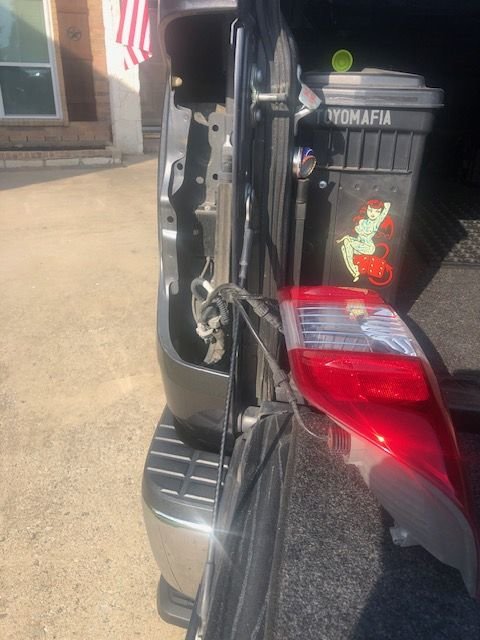

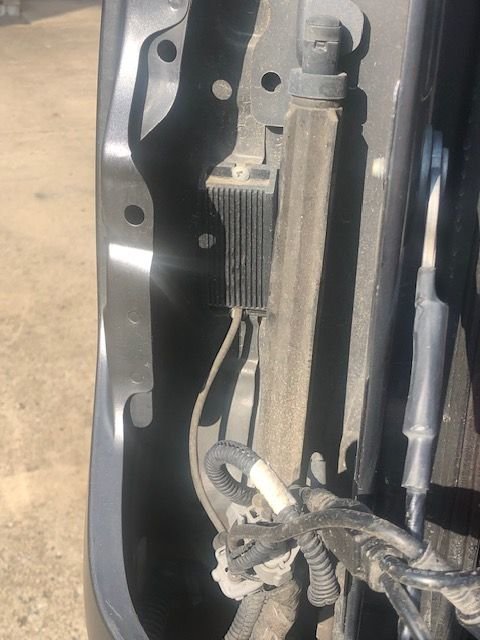

    So I got those tail lights in and that connection that is the 2nd connection in that picture is for a resistor that came with it. I havent been able to install them yet with work but I was planning on doing it tomorrow.
    I got the VLEDs 4 bulb resistors in as well. Obviously those are better than the cheap little gold resistors they sent with the tail lights. Should I just use the VLEDs on the back or save them for the front if I need them for the headlights and if so, will that mess with the ones on the back?

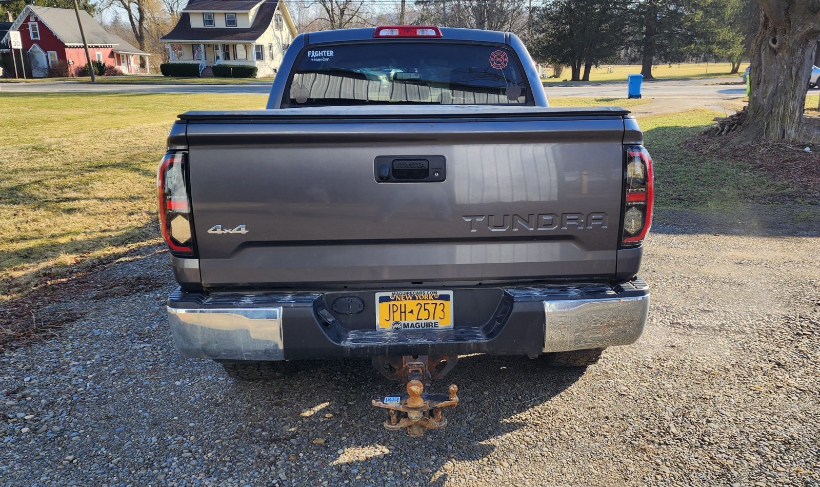

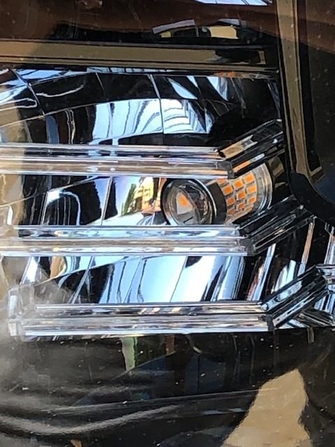

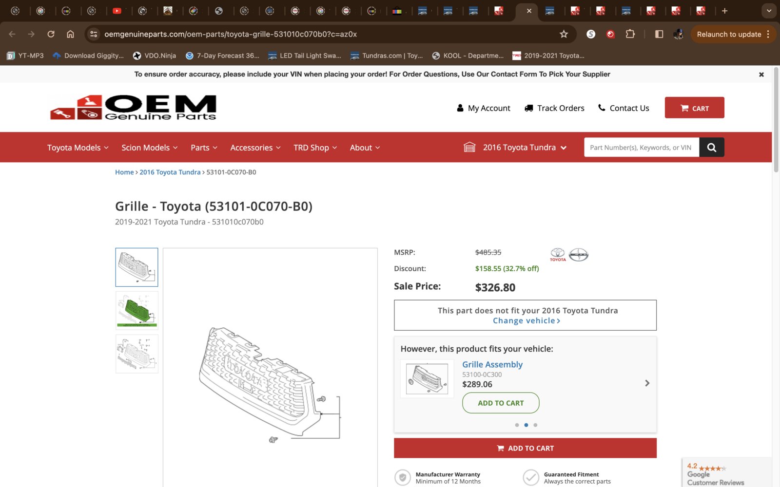

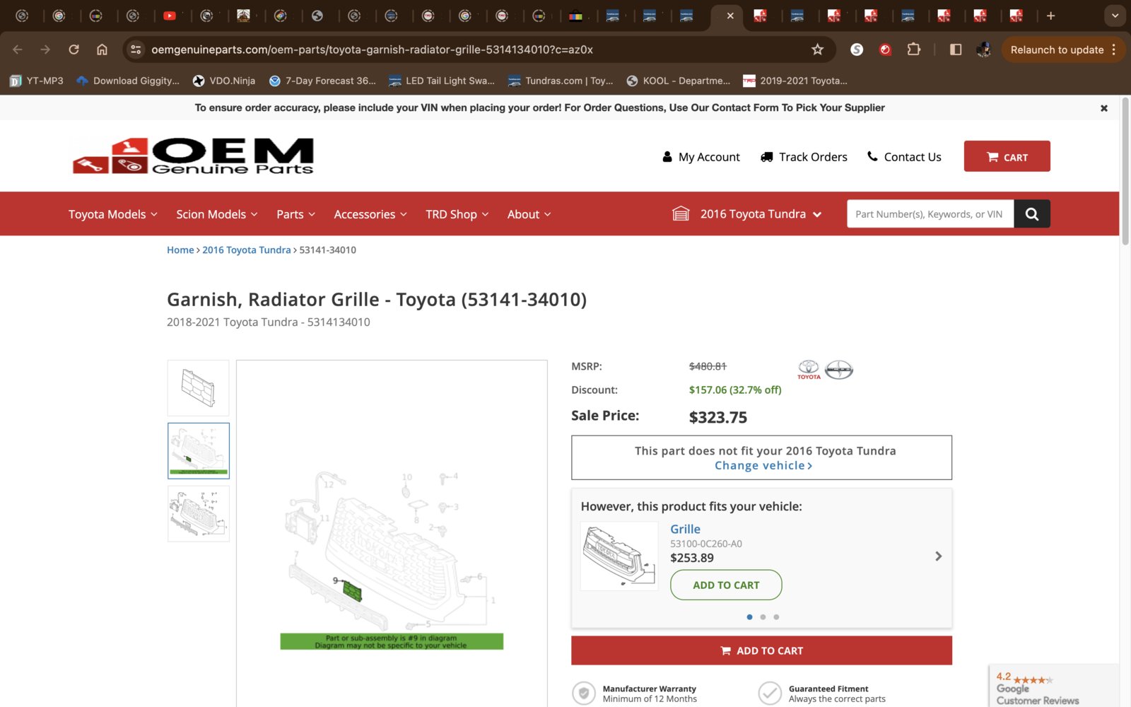

    Got my headlights, tail lights, the harness from @iHacker, LEDs and VLED resistors in and got it all installed and they gave my truck a whole new look!!
    Bumpershellz for the front and back are ordered and now Im moving on to the grill. I ordered the OEM hood bulge to color match and now I am hung up on the grill. Im thinking about getting a 2018+ TRD Pro Grille and I am finding mixed answers about it fitting my truck. The website in the pic below says it doesnt fit but is that because the 2016 doesnt have the TSS and thats why theyre saying it doesn't fit? If thats the case then obviously that's not an issue, I just cant find anything definite on whether it will physically fit my truck. It looks identical in overall size and holy shit, why is that garnish the same price as the grille? I found one on ebay for 17 bucks and it will just be to fill the square hole in the grill and I wont need it for what the garnish is actually intended for with that sensor.

    Glad you got it all installed.
    Yes them saying a grille wouldn't fit your 2016 is because of the TSS stuff.
    You'd be better off finding an old-style MGM TRD grille without the TSS stuff..
    53100-0C260-B1 - TRD Pro Grille - 1G3 Magnetic Gray - 2016 Toyota Tundra | Sparks Parts
    Do your research and see who has the cheapest shipping cost.
    Code - TUNDRAS.COM at Sparks gives some kind of discount, I can't remember if it is off the shipping or parts.
