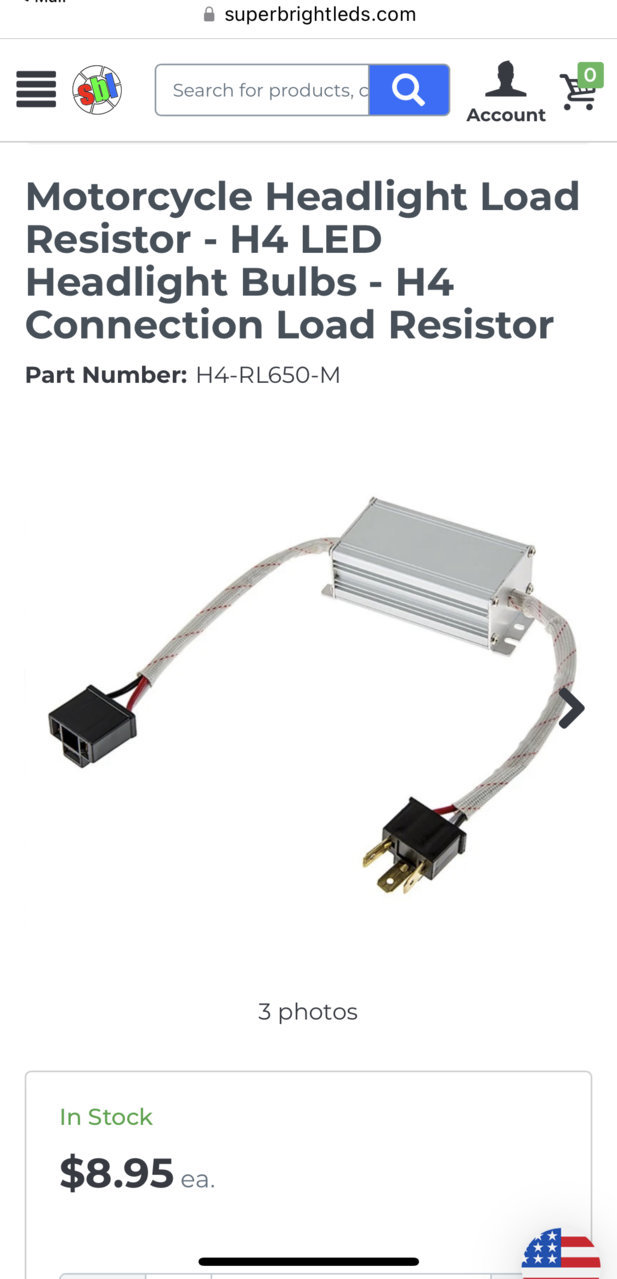

    BTW in case anyone else has this problem.....
    After installing LEDS, My high beams would not come on. When I pressed the button for fog lights the fog lights didn't work and my high beams came on. I did some research and there is a Motorcycle headlight Load resistor ( part # H4-RL650-M) that you install and it resolves this issue.
    Purchased for $9 from superbrightleds

    Yup, the need for a resistor is covered in most of the LED threads, and the general info thread stuck to the top of the thread list.
