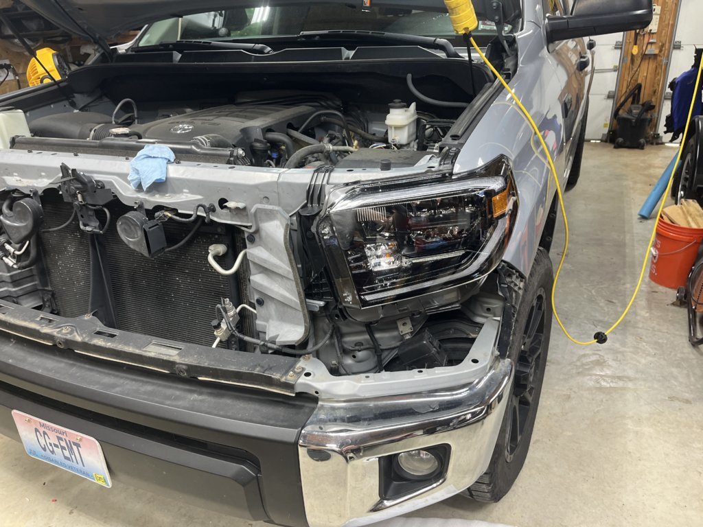

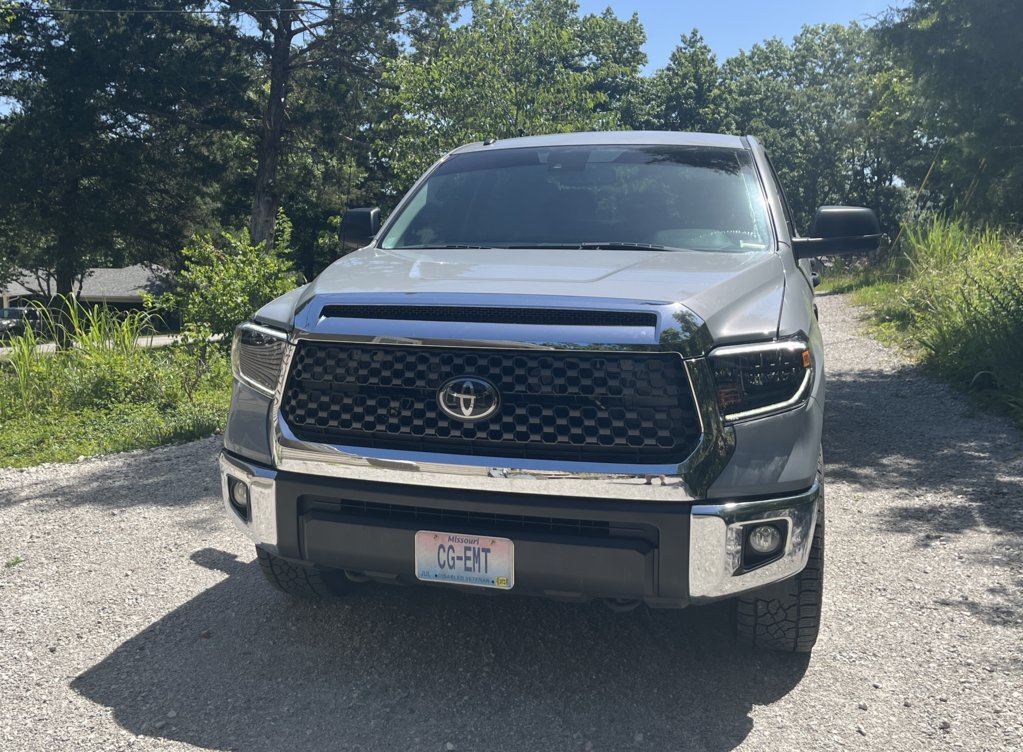

    I did the same....excellent upgrade and well worth the cost/effort! Post above has lights, then contact @iHacker for the harness- 2 differrent ones available I think, one dims the DRL when lights are on, other keeps DRL bright. The harness that keeps DRL bright is easier to wire, does not need an extra wire going into the cab.

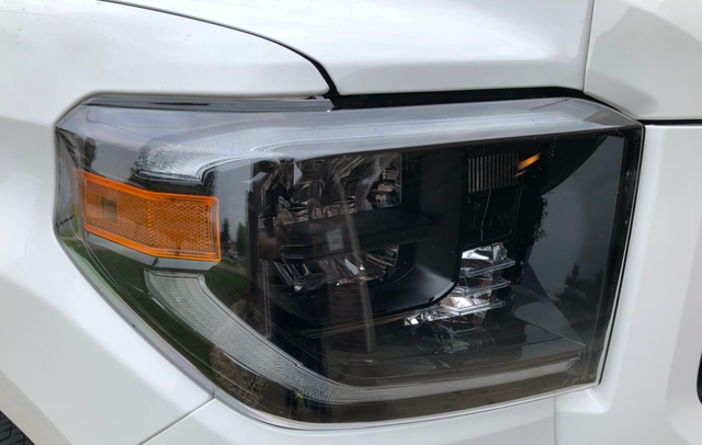

    Not sure if you have amber DRLs that are your parking/turn signal lights, or the white LED strip at the bottom of the headlight for your current DRL.
    The white LED strips on the top and bottom of the OEM LED.
    The factory setup is:
    With parking/headlight off and engine running, they are bright DRLs.
    With parking/headlight on they are dim.
    IMO - You need to wire them so that the bright circuit has an IGN feed and the dim circuit has a parking light feed to take advantage of their greatness.
    Some guys just run them bright, but they are pretty bright at night and could drown out your turn signal.
    If you contact @iHacker through a PM he can give you your options and answer your questions.
    There are usually some variables on how he makes the adpater.
    I had amber DRLs on my 2014 and I liked them.
    I didn't like the bright white DRLs, because for one thing, everyone has them.
    He was able to make my adapter so that I retained my amber DRLs during the day, and I have the dim white strip DRLs at night.
    With my truck and what I wanted, my upgrade was plug and play, no extra wiring or repinning of connectors.
