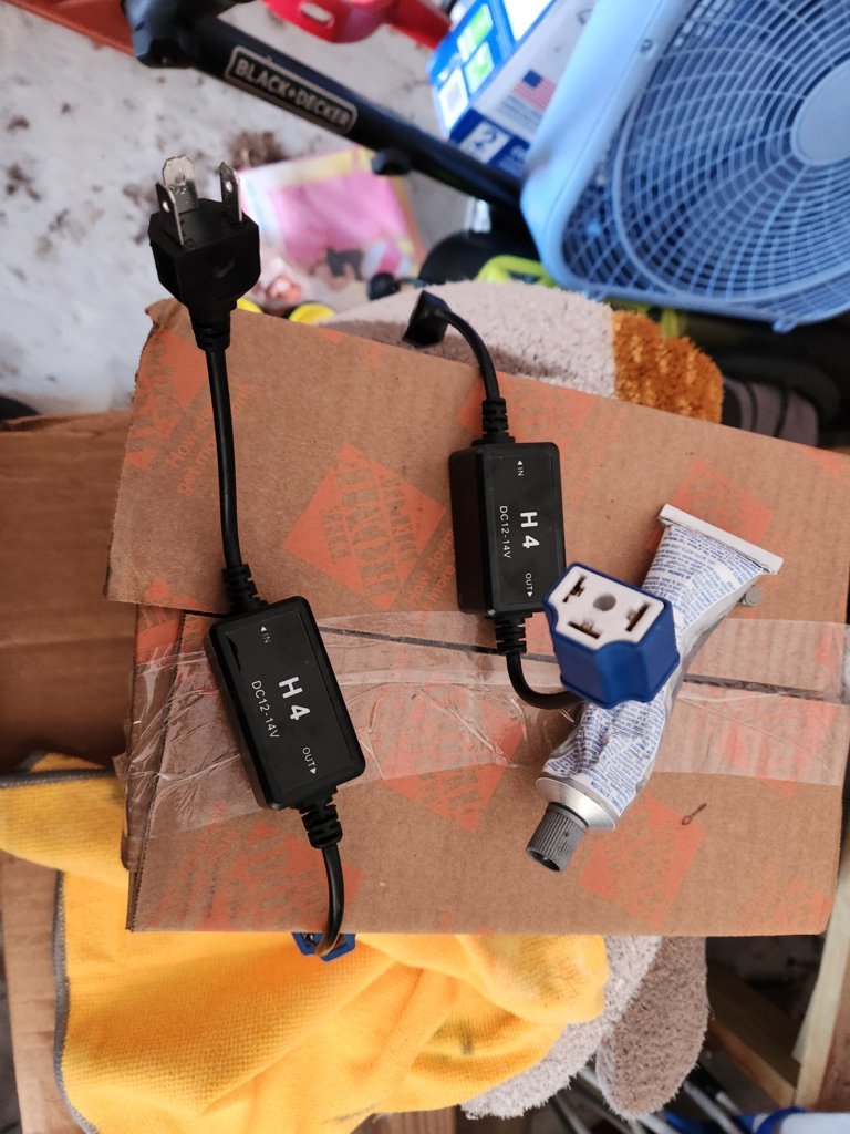

    Thank you! I'm having the same issue on my 03.
    So to be clear I need the resistor inline with one headlight plug or one fog light plug?

    I had the same problem. This is what I used with good results. The build quality is good. I think any of these products would work though.
    Xprite H4/9003 LED Canbus Decoder Anti Ficker Harness Error Free Resistor Capacitor for LED Headlight Bulbs, Pack of 2 https://www.amazon.com/dp/B07SGCHF5B
    I installed both in line with the headlights but I've read that only one would work. I forget if it was right or left side.

    Got these auxbeam resistors from scamazon yesterday night. Installed this morning.
    I tried one and then both of these and it didn't work. I sent them back this afternoon.
    I'll give the ones you said a try.

    I have the exact ones @G_unit3000 suggested, you should be good.

    I found that I have to use them on both sides on my truck, one wasn't sufficient. Without the second one (on the driver's side) that bulb would flicker between low and high beam when the fog lights were on. Weird.

    They worked flawlessly. Thanks everyone.
