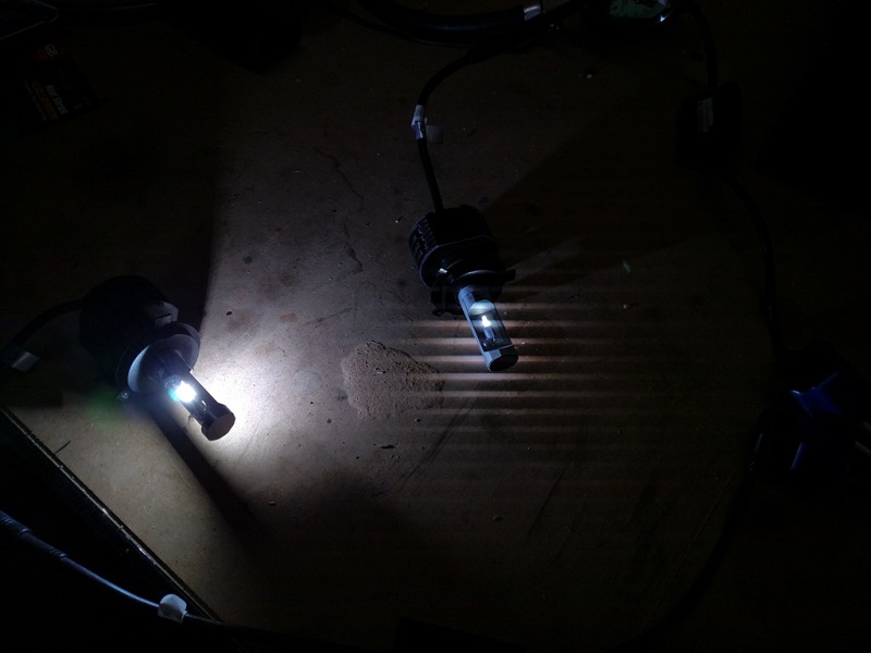

    If you live where it gets cold, I mean really cold, I would stay away from the GTRs.
    Late October I switched from the Philips Ultinons to the GTR Gen3s.
    Everything was fine until late January when the temps here dropped well below zero. I had one lamp go to low beam only, and the other lamp flickered on both beams. I swapped the drivers lamp to lamp and the problem followed the drivers.
    The vendor I bought them from was helpful by email and exchanged the lights no charge other than return shipping.
    Early February, after four or five weeks of steady below zero temps in the negative twenties, the second set of lights failed. One lamp was no high or low beam. Again, the driver swap from lamp to lamp moved the problem.
    I then put the Philips lamps back in the tuck.
    Out of curiosity I made a test rig with a couple of H4 connectors and one of my 12v power supplies.
    The lights sat on my room temperature table for around a week. I powered them up and all was fine.
    I then put both light assemblies in the bottom of my freezer for a week. The temp on the drivers was -11.
    Quickly powering them up on my bench, one lamp was fine, but the other barely lit the high beam, and had some strange output from the low.
    Drivers swapped lamp to lamp and the problem follows.
    These drivers just do not like extreme cold.
    They are bright when they work, I'll give them that. But as I posted in another thread, the beam pattern is really crappy, with lots of scatter.
    This is all my personal experience and findings, but I won't recommend GTRs for headlights.
