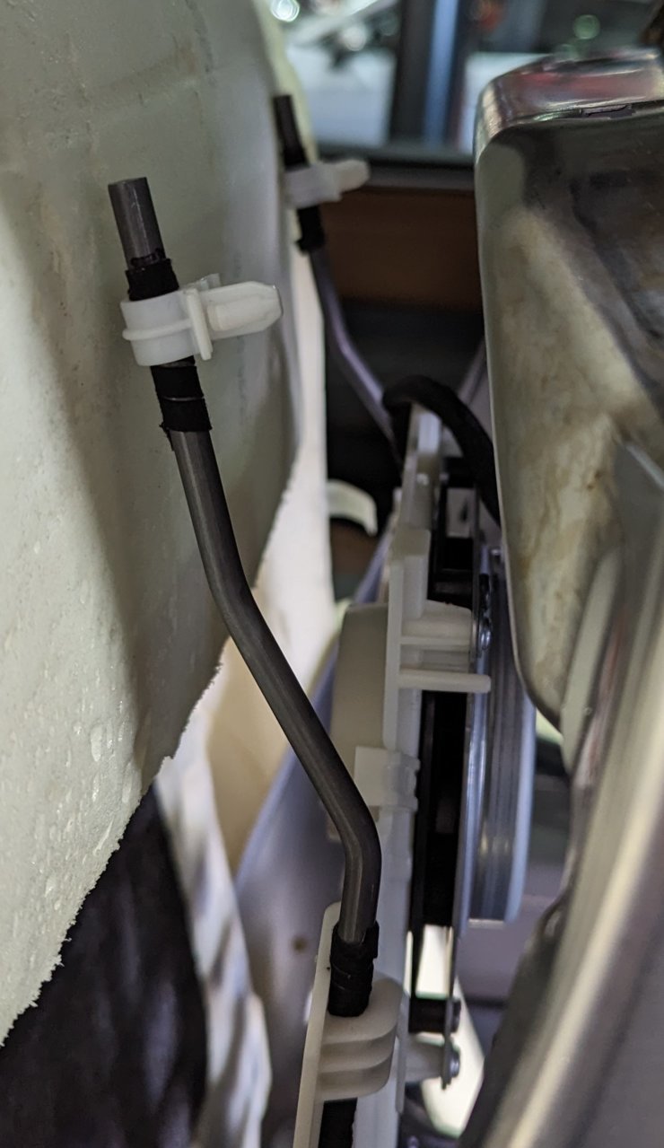

    My limited does the same. I have had it in 4 times for this issue. Idiot dealer thinks it is normal for leather seat or they can’t hear it. It is the mechanism that holds the lumbar support and the fan for the ventilated seat back. Took me 5 minutes to isolate it at home. They have allegedly spent 6-10 hours trying to chase it down. I am going to carry it in again this week and shown them how to do their job.

    I picked up a 23 1794 last night and, after a few miles, started having the same issue. It seems to be localized to the seat ventilation stuff so my money is on needing a little silicon on a union somewhere in there. I've contacted the dealer, we'll see what happens.

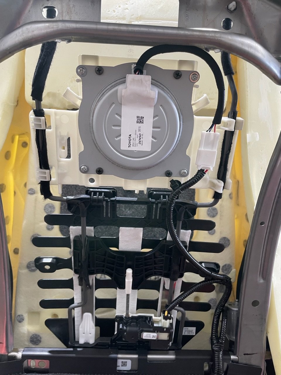

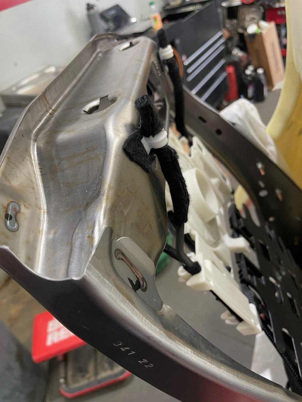

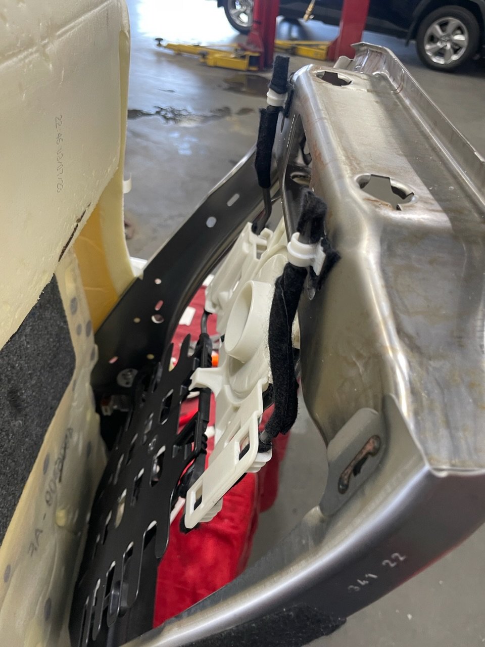

    My dealership got me sorted. There is a plastic retainer for the lumbar that has the two metal guide rods going through it. It seems that is either made of the wrong plastic or not sized correctly and creaks for taller drivers. They wrapped it with some felt tape and added a few more pieces on the bare spots and it's nice and quiet now. This isn't the official toyota fix, but they got me into a quiet cab until one comes out.

    IMG_6799.jpg IMG_6798.jpg IMG_6799.jpg Took my tundra into my dealership and they stated that Toyota U.S.A. recognizes that there is a problem with the seat and are currently working on a solution. As of right now, Toyota U.S.A. has advised my dealership to insulate the the lumbar support rods as a “temporary fix.” Noise has been reduced by about 95%
