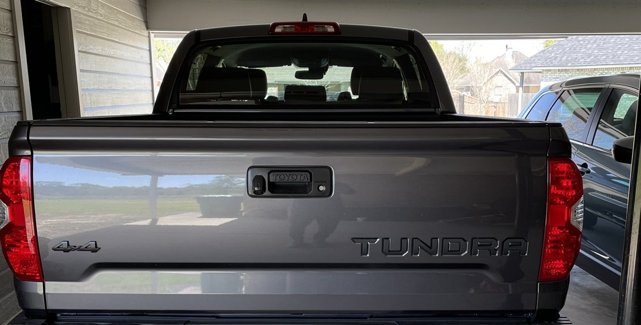

    Not sure how well it shows in the photo, but I’ve noticed a slight droop on the right side of the bed (vs the line across the cab)
    what causes this? Is it related to the shock swap or is it something that just happens over time?
    I thought it might be a low spot on the concrete but I’ve looked at it at 3-4 different locations now and it’s there.
