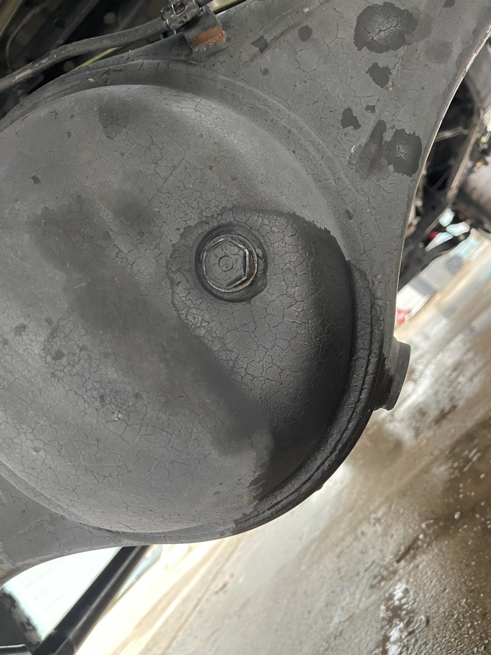

    Hey guys maybe someone can help me out.. does this leak seam to be coming from the fill plug I haven’t tried to take it off or anything yet. Any suggestions or experiences would be helpful Thanks!

    Thought I might add doesn’t seem to have anything coming from front side of the diff

    Spray it with brake cleaner and see if it’s active or just a lazy fluid change. If you haven’t changed the fluids recently, might be a good time to do so, and get new crush washers

    Was recently changed and had grip pro installed about a month ago I have the oil and was about to do a oil change on both diffs and transfer case

    That’s what I was thinking maybe they were just lazy

    Get new crush washers and torque properly and you should be fine

    That's more of a seep than a leak. Did you get your oil changed recently? Sometimes they check your fluid levels and a few small drips can cause what you are seeing. FrenchToasty has the idea though ^

    So after I made this I actually got down under there the guy didn’t put a crush washer on and it was only hand tight changed the oil cleaned it up new washer seems to be holding now!

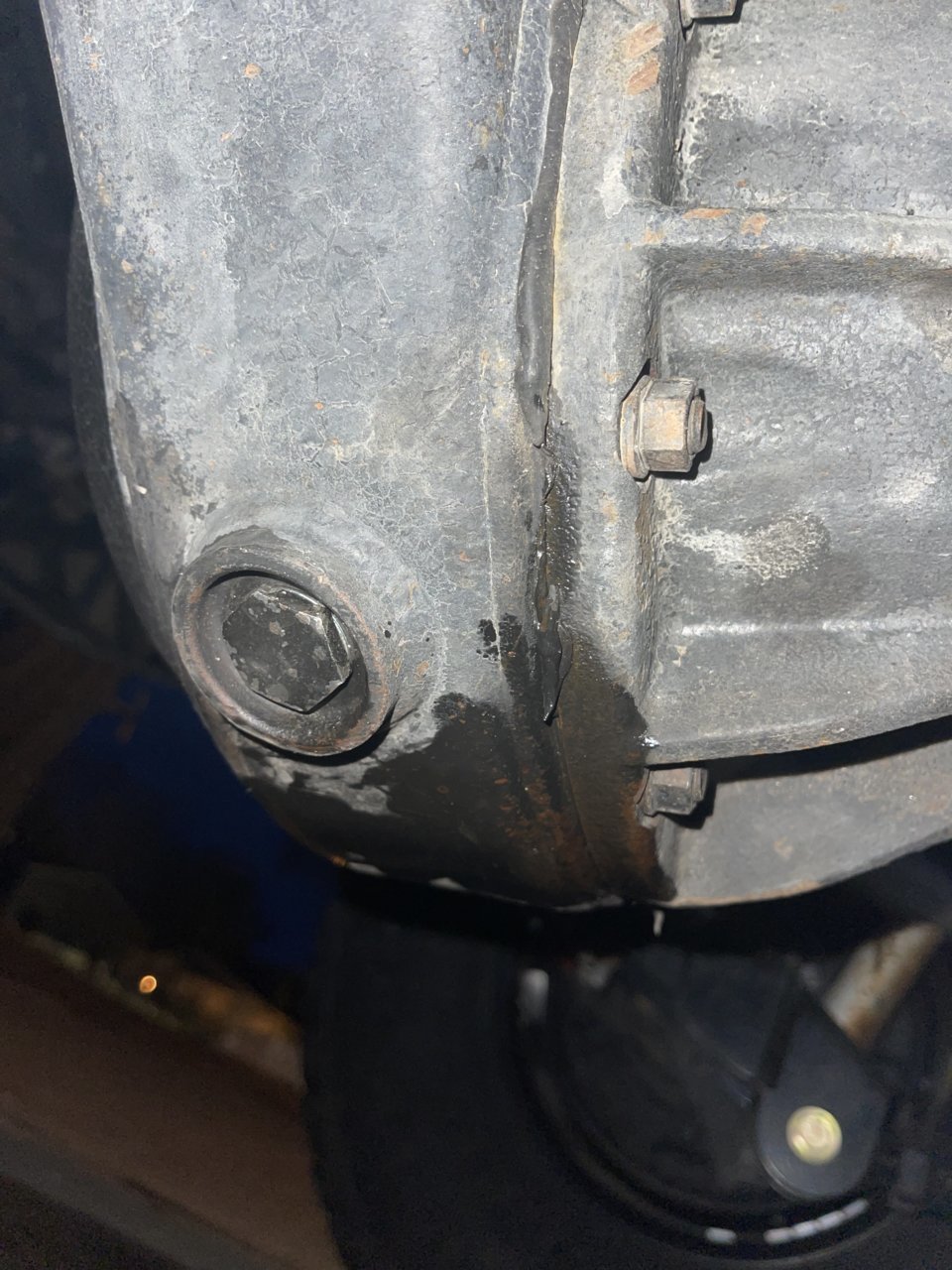

    So I’m back with an issue seems to be leaking from the bottom of the diff now curious what caused the seal to fail.. vent plug is clear only thing that scared me is the drive shaft not being aligned properly had to replace it while back because my old one broke and I was not able to mark lines to put new one on the same I kinda guessed from the indention made by the old rear drive shift when I bolted it up would that be a issue?

    Almost looks like the seal the guy used isn’t coming out the bottom like it does all the way around

    Sounds like whoever did the install needs to pay for someone else to do it properly before your rear is wrecked.

    Yeah I got under there and the nuts holding the cover on were loose so I tightened them and the bottom stud just spins so quessing its stripped like come on..
