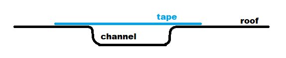

    Yours is coming in while driving, that's weird, but also an 'AHA!' for me. That it's entering at the A-pillars makes me think the source could be your roof channel, or even better yet, from your side trim, and have nothing to do with your windshield.
    Just give this a shot before you pull the headliner - or don't, just skip to the possible solution below. Your call.
    Get some clear packing tape like I mention above. Tape both roof channels like you see here, and make sure there's a 1" overlap ONTO the windshield, making it impossible for water to enter that channel.
    If you're still leaking while driving, do the same across the top of the windshield seal, from passenger A-pillar to driver A-pillar, like this:
    If you rule out the above, you know 100% this probably has nothing to do with your windshield.
