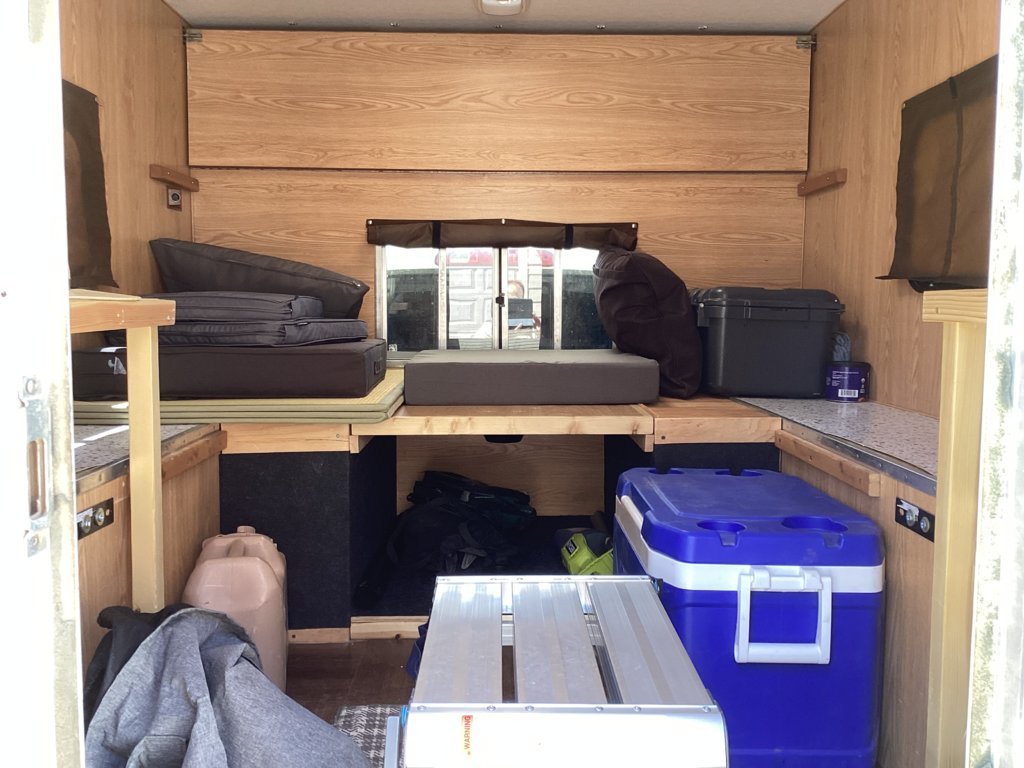

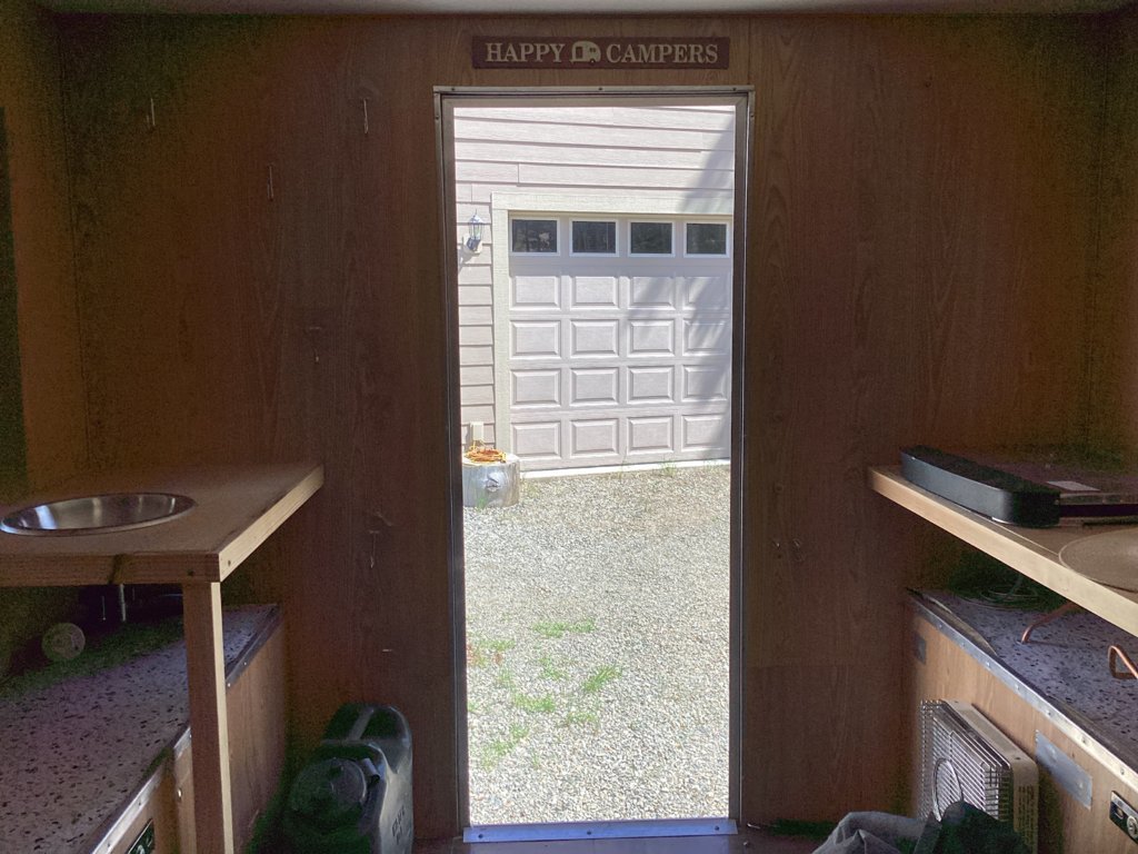

    Not sure, but ballpark 1,000lbs. It was 860lbs when it looked like this
    Now it looks like this
    I haven't weighed it since building out the interior, and I don't weigh my stuff, but I'd say ~200lbs added to the original 860.
