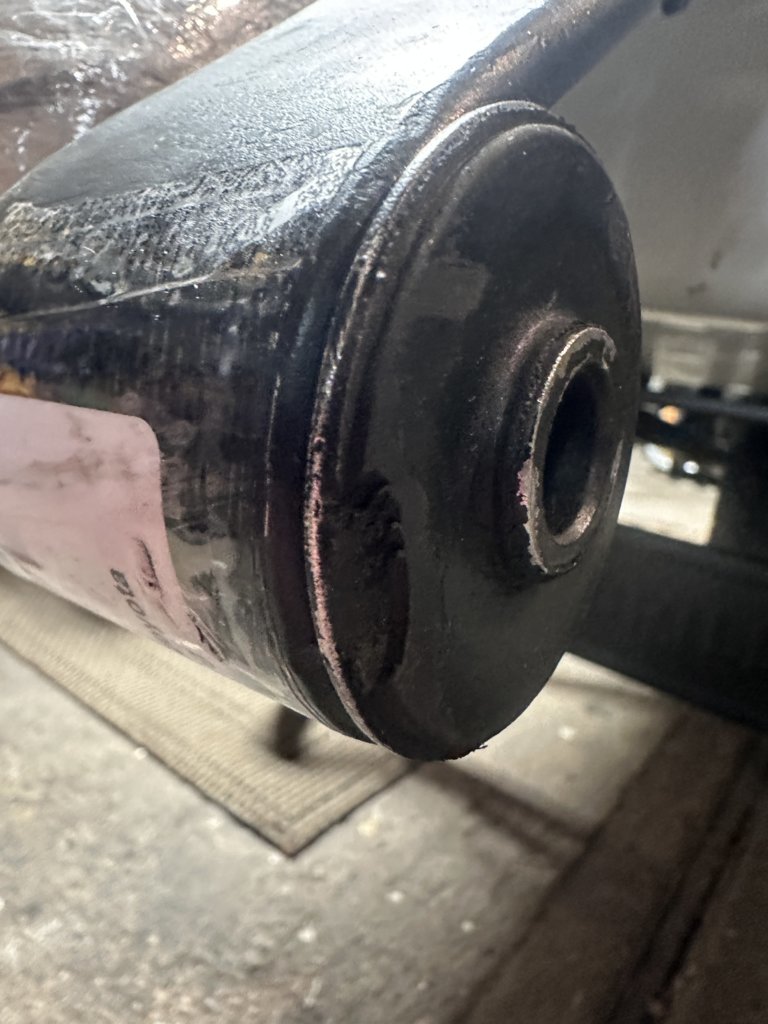

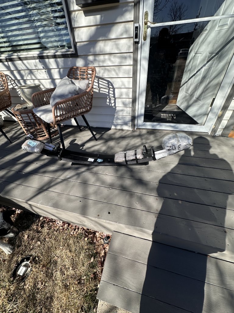

    My springs did come a little banged up from how Fedex handled them, one of the bushings has a chunk out of it. They don't come in a box. I talked to someone at ATS and they said the missing chunk won't compromise the springs at all. Mind taking a look?

    I'm no expert, but I wouldn't worry about it.
    I bought HD leaf springs for my Tacoma from General Spring, and they came the same way. Just wrapped in plastic wrap. I prefer perfectly clean, un-banged products, but I guess with something like leaf springs, they'll take way, way more abuse once you install them, so it shouldn't matter.

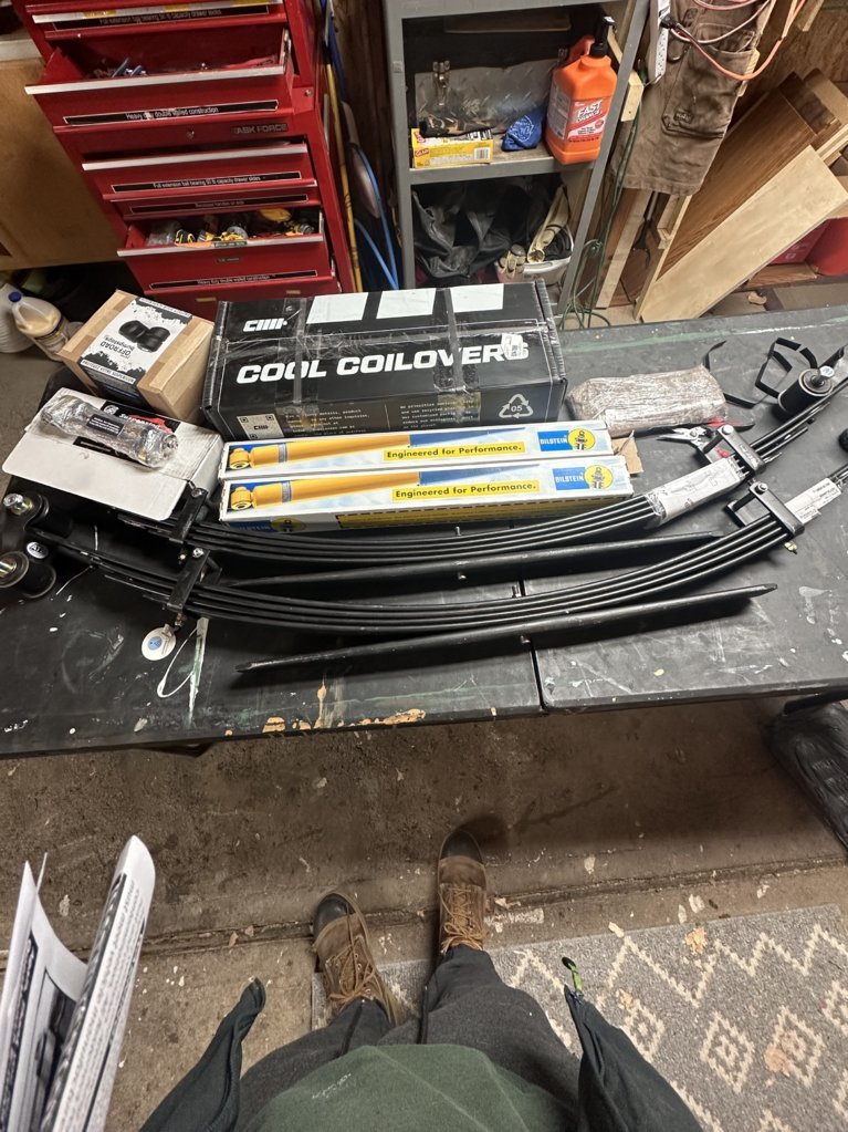

    Just wanting to provide an update. I received all the parts and have just been waiting for some warmer weather over this past weekend. When I removed the spare tire I noticed a few rusty spots, nothing dramatic or too concerning. I started prepping the rusty parts of the frame with a wire brush and it looks like a previous owner painted over the rust. There's no holes or weak spots, it appears to be all surface rust, so I'll be tackling that alongside the install on everything.

    Nice looking pile. I've got a similar one!
    Cool Coilovers? I haven't heard of them.
    I'll have all the parts to do my suspension by the end of the week. I kept adding more...

    They're the old man emu coilovers! I think Cool Coilovers is the company that installed the coils?
