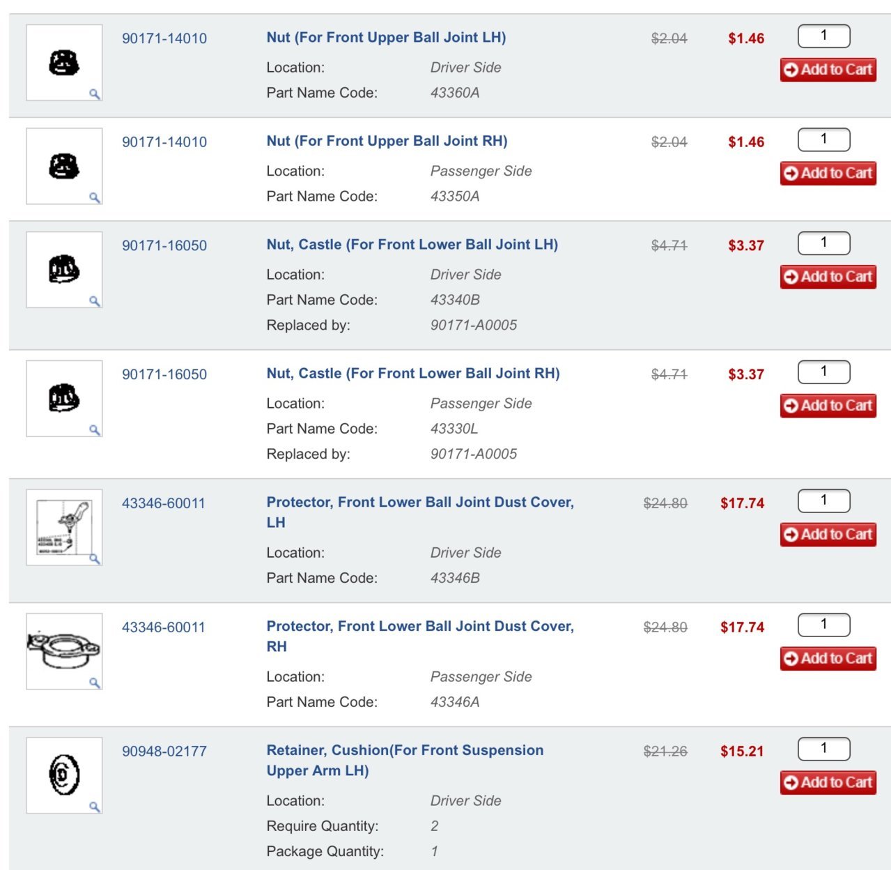

    Maybe the original cotter pin and castle nut?

    If the original castle nuts are the same thread, use them. Always better to use new cotter pins, but not necessary. They can be hammered out straight. If not, just go to a local parts place, or Toyota, and get new cotter pins.

    You should always use new cotter pins and castle nuts. They are so cheap. Can you reuse the old? Sure can, but not recco’d. These parts are for 2002. Double check for your year.

    Castle nuts are always reused, you do however always replace the cotter pins.

    I just replaced lower ball joints, I didn’t know about a “kit” but the new oem ball joints came with new castle nuts and cotter pins.

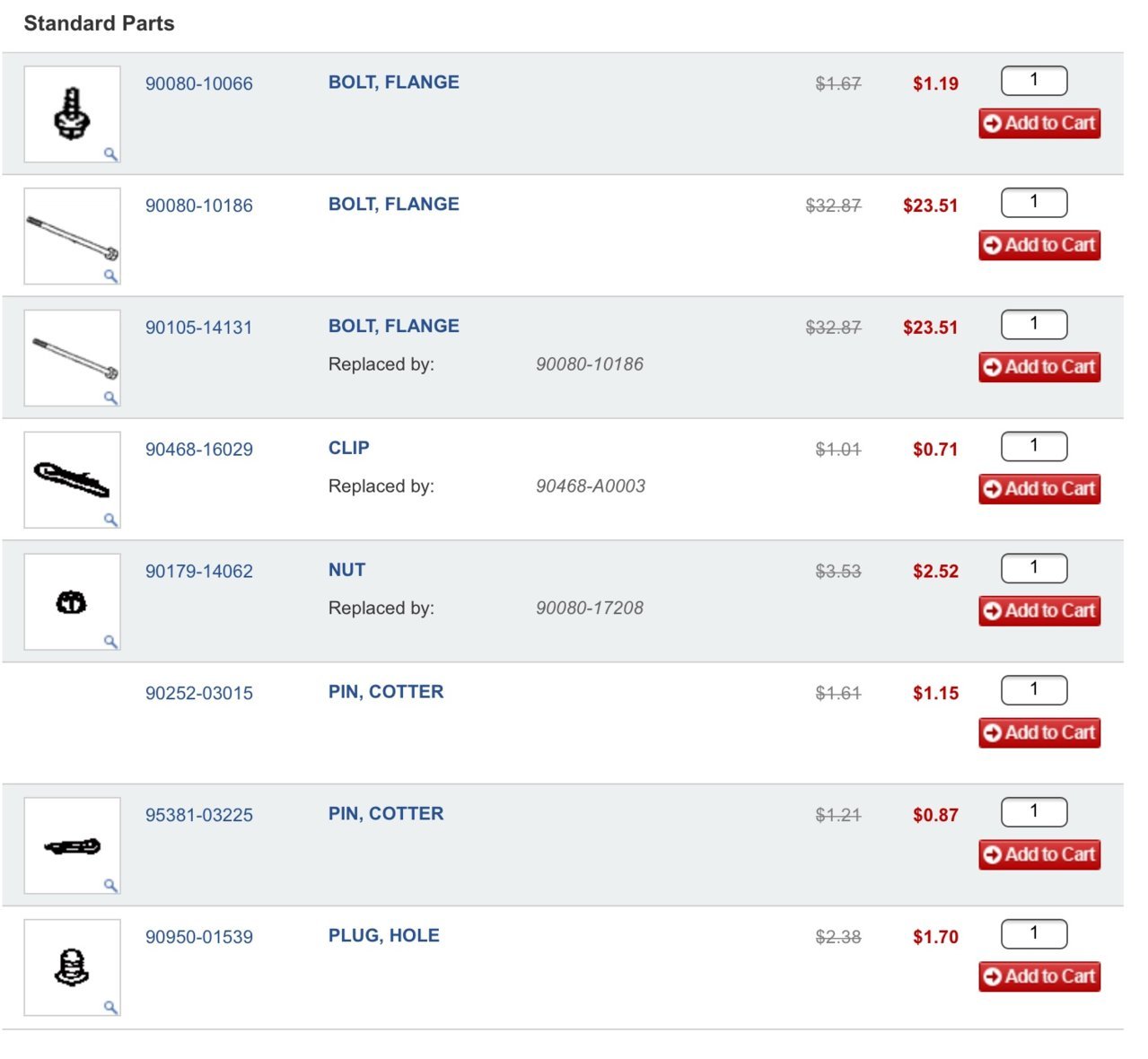

    Did the kit come with the bolts? I'm ordering my kit now, not sure if I need to order new bolts or just the two castle nuts and two cotter pins?

    I didn’t order the kit, but the 4bolts per side were not included when I bought my sets. #9010512316 x 8

    Thank you! Looks like I'll wait for the kit to come in and then order the 8 bolts, 2 nuts and 2 pins if they aren't in there. Hope this helps someone else down the road.

    Not needed. Just new cotter pins. Kit doesn’t come with any of the above mentioned items.

    While it's true the 8 bolts are technically not needed (you can reuse the ones there) it's only $12 in bolts from Toyota, so if the Toy mechanic says get em, it's seems worth it to me...

    In the world of Tacoma’s the lbj bolts are known to sheer after reuse on lifted trucks. It’s cheap insurance to me. I know the 05-06 tundras use larger bolts though, but for the price it sure beats possibly losing a wheel.
