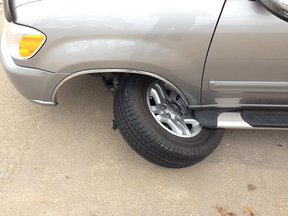

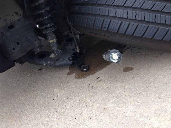

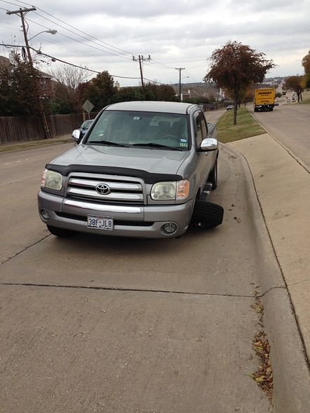

    My lower ball joints didn't fail on my 2005 (did the recall shortly after it was issued), but it did come apart.
    It's a long story but someone (NTB) did work on my driver's side front end.
    They forgot to put the cotter pin back in the LBJ spindle nut.
    This happened 45 days later when I hit just the right bump in the road after the pin and nut fell off..
    That was the last day I drove my 2005, I still miss her..
    Jack McCarthy and BobbyRaids like this.

    Brutal, thanks for showing pics though.
    A LBJ in compression may have never had that failure.
  11. Dec 11, 2023 at 8:11 AM
    #41
    KNABORES
    KNABORES Sarcasm incoming
    Jan 1, 2020
    #40572
    13,943
    Arkansas
    While I generally find you to be a toxic prick and pavement princess, I actually felt bad for you looking at these photos. Could happen to the best of us. And it happened to you too.
