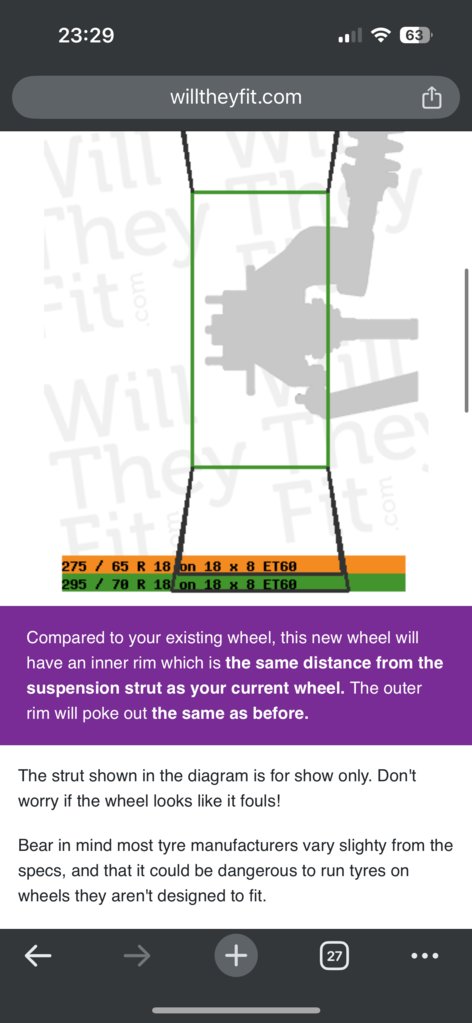

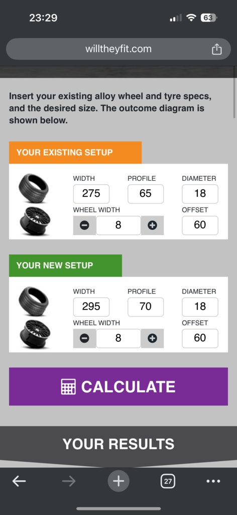

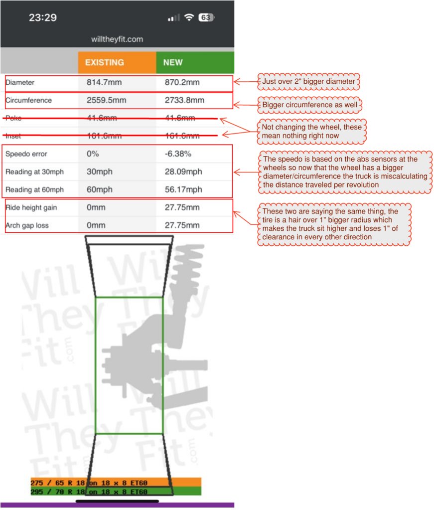

    Well I guess I’m gonna be that guy. I went to “will it fit” and can anyone explain the numbers and what it all means please? Im good at math, he’ll, I LIKE math, but wheel math hurts my brain. I have a 19 trd pro, currently on the stock 18” wheels so I’m assuming +60 offset based off what I’ve read? I’d like to try and put 295/70/18 Wildpeak AT4/W’s on the stock wheel. Most other forums I’ve read mention people remove mudflaps etc but I just don’t understand what the websites telling me. I’ve tried watching videos on offset and backspacing etc and nada.
    Can someone explain to me like I’m a five year old please?

    Since you are not changing wheels in this example, this website is not telling you that much. Offset and backspacing are a little more complicated, but until you start looking at different wheels, it does not really matter yet. The most important metric on this page is the 'Arch gap loss', if you have a minute to just sit back and look at your wheels I would encourage you to turn the steering wheel back and forth in small increments and identify when the tire is the closest to various components, then with the tire in that position, imagine that it is about 1" bigger radius and about 1/4" wider as well. It is very possible that you can slap the bigger tires on your truck and you won't have to do anything, every truck is just slightly different.
    More specific info marked up: (FYI, I dismissed it, but 'Inset' below is the same as backspacing and 'Poke' + ' Inset' = wheel width)
    HondaDad, Rdh1223 and Lucress[QUOTED] like this.

    Thank you very much! I'll take you up on your recommendation to go look at the wheel wells and identify any areas of potential "interest" so to speak with moving to a larger tire.
    APalmTree[QUOTED] likes this.

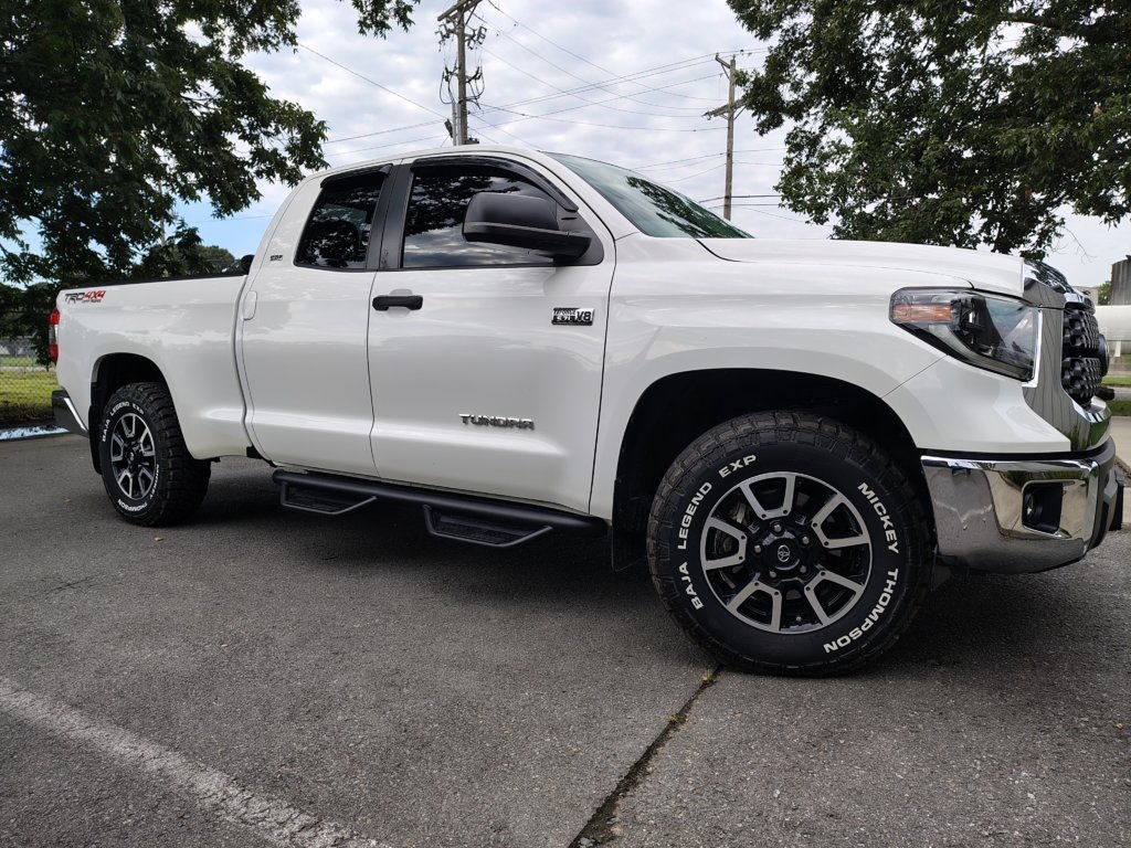

    Thanks for the reply. I was looking at the tires in your pics from this thread and I found them in both SL and E, how do you like the E rated set ?

    They were fine. I'm no longer on this setup. I went bigger. But E rated is all I ever buy. I'm not worried about weight, gas mileage, rough riding, loud, or anything else that some people are concerned with. I just want aggressive tires that can take lots of abuse.

    This looks great. How far past the fenders did the tires poke out ? I have a TRD sport with the oem suspension & am looking to ditch the 20s.

    I believe it was about even with the fenders, maybe inside the upper fender slightly, if I remember correctly. One side more than the other, because that's how Tundra's are. Here's a few old pics that shows that a little better.
    HondaDad[QUOTED] likes this.

    Thanks ! The truck looks great with that setup, almost perfectly flush. I may grab a set of oem 18s to put these tires on.
