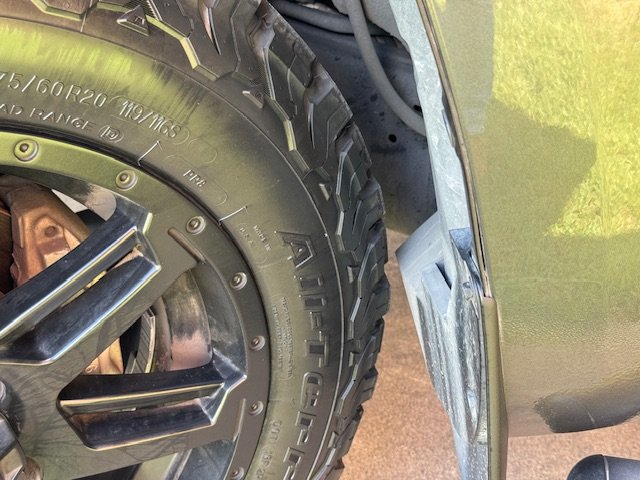

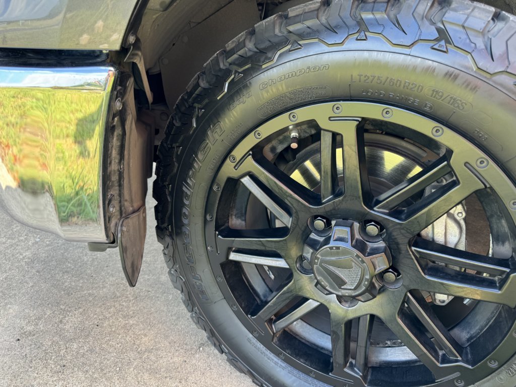

    Purchased Nitto Ridge Grappler (16/32 tread depth) LT275/65/R20 in 4/2021 (factory size P275/55/R20), leaves 1/2” clearance between sidewall and UCA. As of today, 12/2023 & 26,857 miles later with consistent rotation/balance, 8/32 tread depth & all around even wear. Pics just off the lift. Doesn’t really leave pavement & no towing yet.
    FREEK and rruff like this.

    you sure you purchased 275/65s your photos show 275/60?

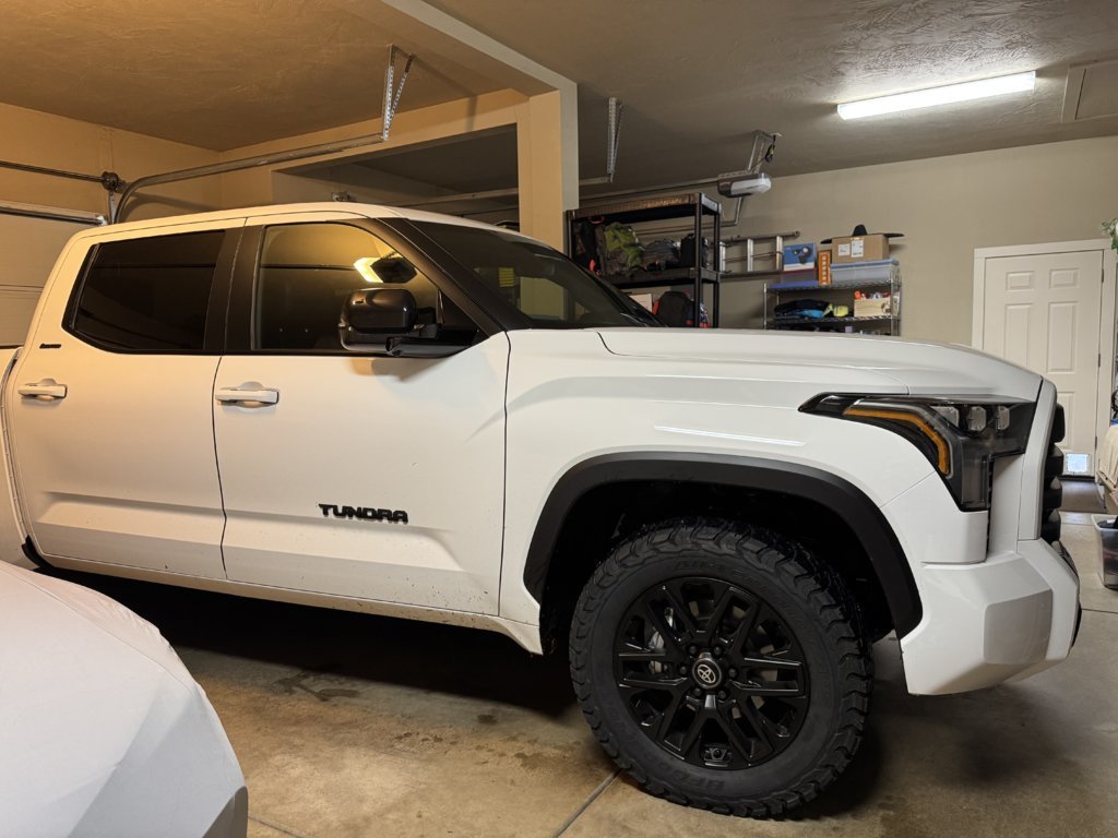

    I was looking for the largest tire size for my 2024 trd pro tundra? I have heard so many people say different things, imagine that. Any pics would be helpful.
    drewpweinerMD and Flynn47 like this.

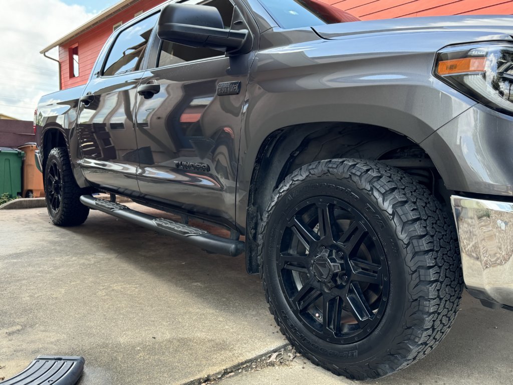

    IMG_2007.jpg IMG_2004.jpg PSA for anyone here…
    2020 SR5 4x4 with TSS Off Road “Texas Edition” - whatever BS you wanna call it. Stock was 20in wheels and 275/55/20 DuraTrac - no added lift.
    Today I swapped for BFG All-Terrain TA K02 and went with the taller 275/60/20. Notice the clearance. Decent difference in filling out the wheel wells too - gains about an inch in height. Hope this helps one of yall.
