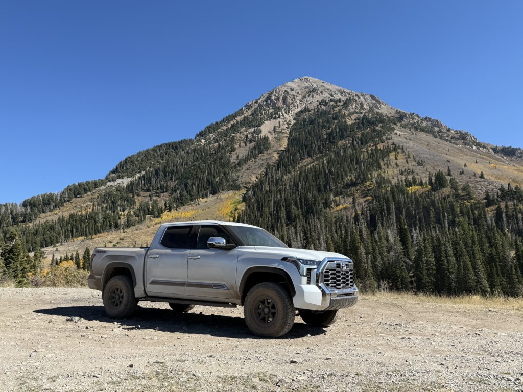

    Thank you! Unfortunately my Falken wild peak AT4w doesn’t fit without rubbing on the pan hard bar. I looked into it and that Toyo is dimensionally 34.5” and my Falkens are actually 35”. I lose that 1/2” that you have to spare. Now I need to figure out what to do with my 5th wheel set up… IMG_1805.jpg
