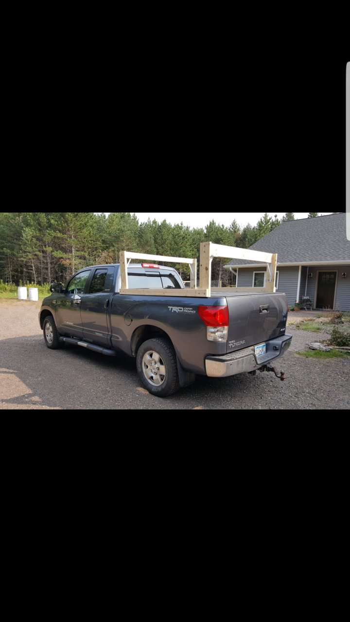

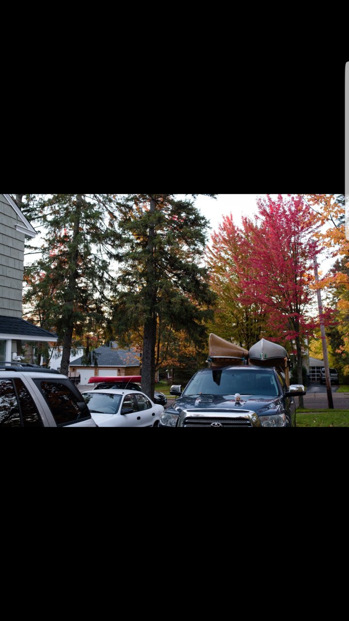

    I used some dimensional lumber and garage shelf brackets. Knotched the 2x6's to fit into the post holes and it is really easily removed. I have it wide enough for 2 canoes for boundary water camping trips with the whole crew. I think it ran me about $50 in materials. Screenshot_20190202-110622.jpg Screenshot_20190202-110700.jpgScreenshot_20190202-110644.jpg

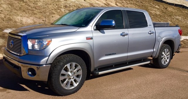

    I finally got some additional pictures showing how I store the trusses for the lumber rack when I am not using them.
    Here you go:
