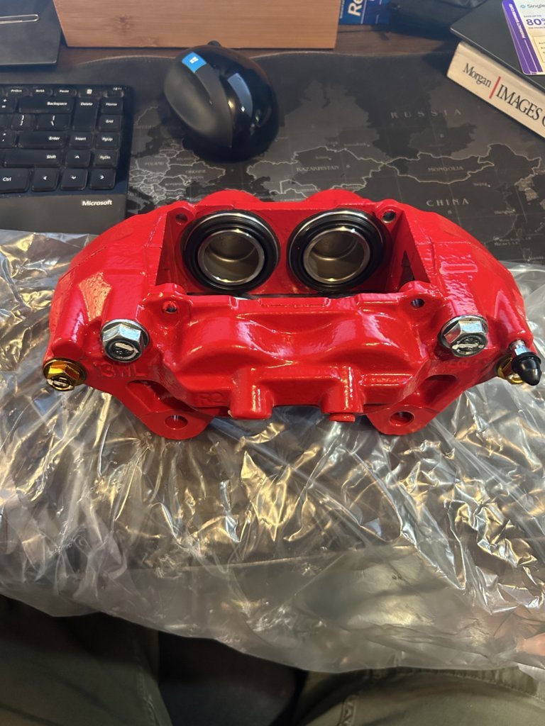

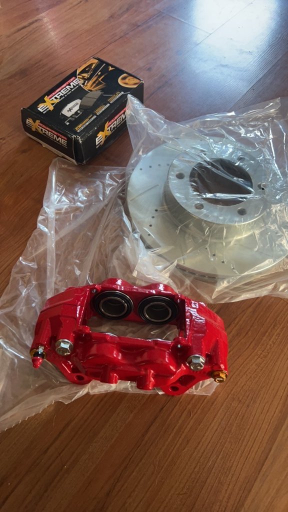

    Great info for the brake system thank you! I'll have to take a look at my booster to make sure nothing leaked into it. I'm assuming the full MC assembly from Toyota is close to $350-500 so I'm really hoping that's not the case. Hell when we're talking money like that doing the big brake upgrade or trying to figure out how to make the bigger Sequoia MC I've seen mentioned on other brake threads work might be worthwhile...
    My truck does not appear to have VSC and it does have the 13WL calipers. Yes already purchased the Power Stop Z36 kit from RA. With no core charge and a $50 mail in rebate it was hard to pass up. Calipers, rotors, and pads for about $325 delivered.

    Quite welcome! For a new booster / master cylinder from Toyota it's closer to the $900 / $1000 mark. Like Shifty said, if you need it, now is the time to buy it.
    Sounds like you have the exact same brake setup I do, no VSC.
    I think an issue with the Sequoia MC on the Tundras is the Sequoia's rear brakes (disc) operate at a different pressure range than ours (drum), so you'd have to figure that out. One benefit of having a double cab is the width of our rear axle is the same as the Sequoia, which would make a rear axle swap (for discs) easier, and swapping to a Sequoia MC at that time would be easier. I'm no expert on that process though.
    And unfortunately, if you need a MC, you need a MC, and the Big Brake Kit (to my knowledge) doesn't involve replacing the MC.
    jdsmit36[QUOTED][OP] likes this.
