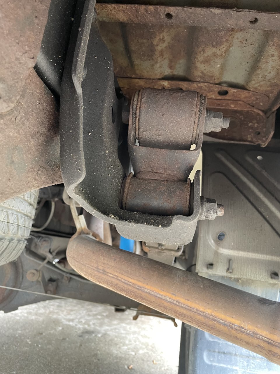

    I’ve got a persistent noise at slow speed, most often when starting and stopping. From in the cab it sound like it’s coming from the right rear. After some inspection, I’m quite certain it’s coming from the leaf spring hanger at the rear of the leaf spring. I assume you can buy the rubber bushings and just replace them.
    Has anyone done this? Does anyone have a part#? Toyota or rock auto?

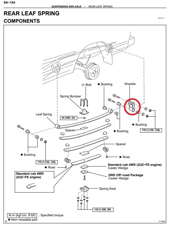

    I believe this is what I’m looking for. Has anyone replaced this? I couldn’t find just a bushing on Toyota’s part site
    I wanted to replace fronts as well, but haven’t found those either?

    04 double cab lists:
    8x 90389-14051 is needed for the leaf springs. (2 per leaf spring 'eye'.)
    4x 90389-14053 is needed for both shackles.
    05/06 access cab lists:
    For springs
    90389-14051 (08/2004 - 11/2004)
    90389-A0007 (01/2005 - )
    For shackles
    90389-14053 (08/2004 - 11/2004)
    90389-A0006 (01/2005 - )

    Has anyone changed these before, I popped one end of the leaf off yesterday and it appeared to be more than a quick 30 minute job, so I aborted for a weekend when I can devote some time. Whats the best way to get the old bushings out?
