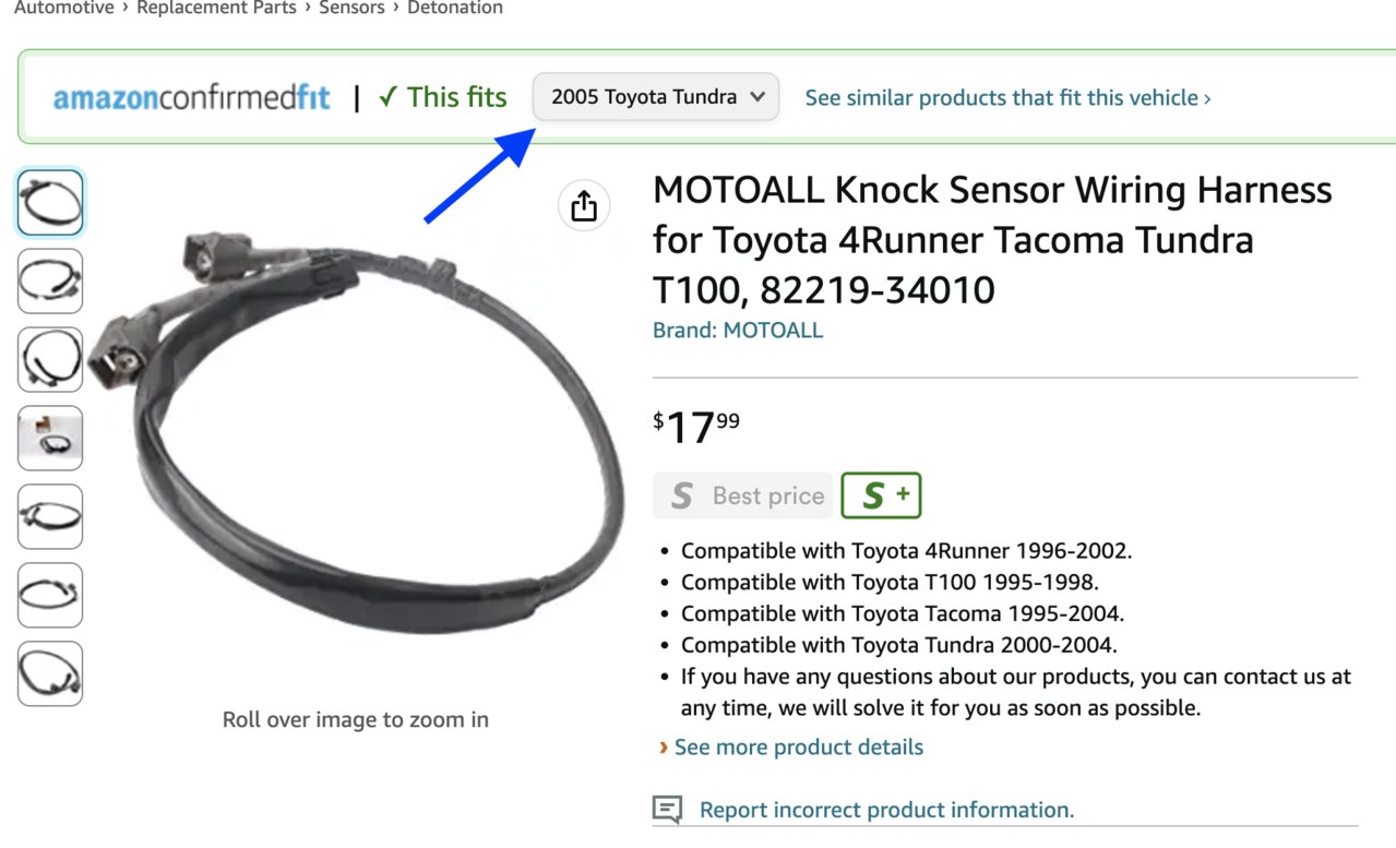

    It does say 2004 and I have no idea how big a difference it would be. I think my biggest need is getting the water resistant wiring and then being able to waterproof the connections.
    Trying to save money by finding a pick a part by me means any of those savings disappear in the gas I'm gonna spend to drive there.
    Just trying to figure out the smartest way to do this and avoid as many repeat trips after I start tearing things apart.
  10. Apr 20, 2023 at 11:56 AM
    #70
    Brad Majors
    Brad Majors [OP] Life is just a Tire Swing...
    Jan 21, 2023
    #90667
    79
    The Swamp
    '05 Tundra Double Cab Limited, 2WD 4.7L w/Factory Tow Pkg
    It does say in the drop-down that it is compatible to a 2004 and I do have a 2005, but this thing at the top is confusing me...

    I found the one for the2005 VVTi V6, it's legacy part number. 8221935020 which translates to 822190C010.

    Never trust scAmazon's part finder.
    2000-2004 was non-VVTi. 2005-2006 added VVTi. There are some somewhat significant differences in the two.

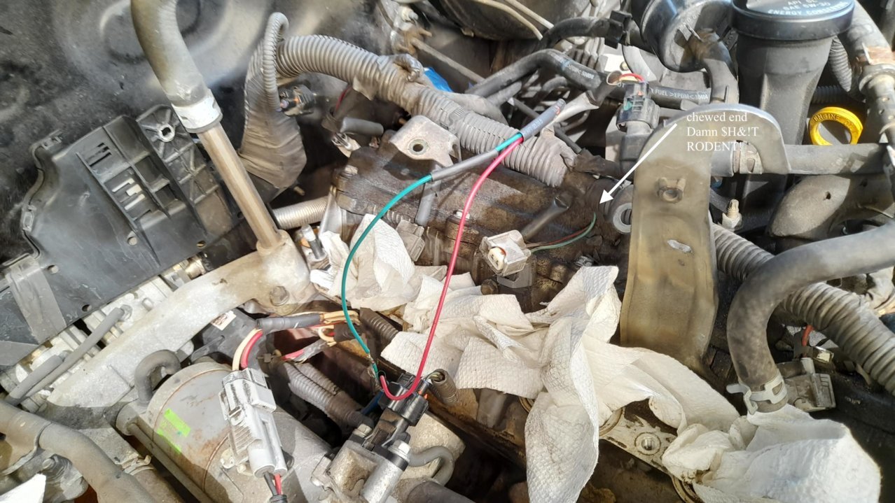

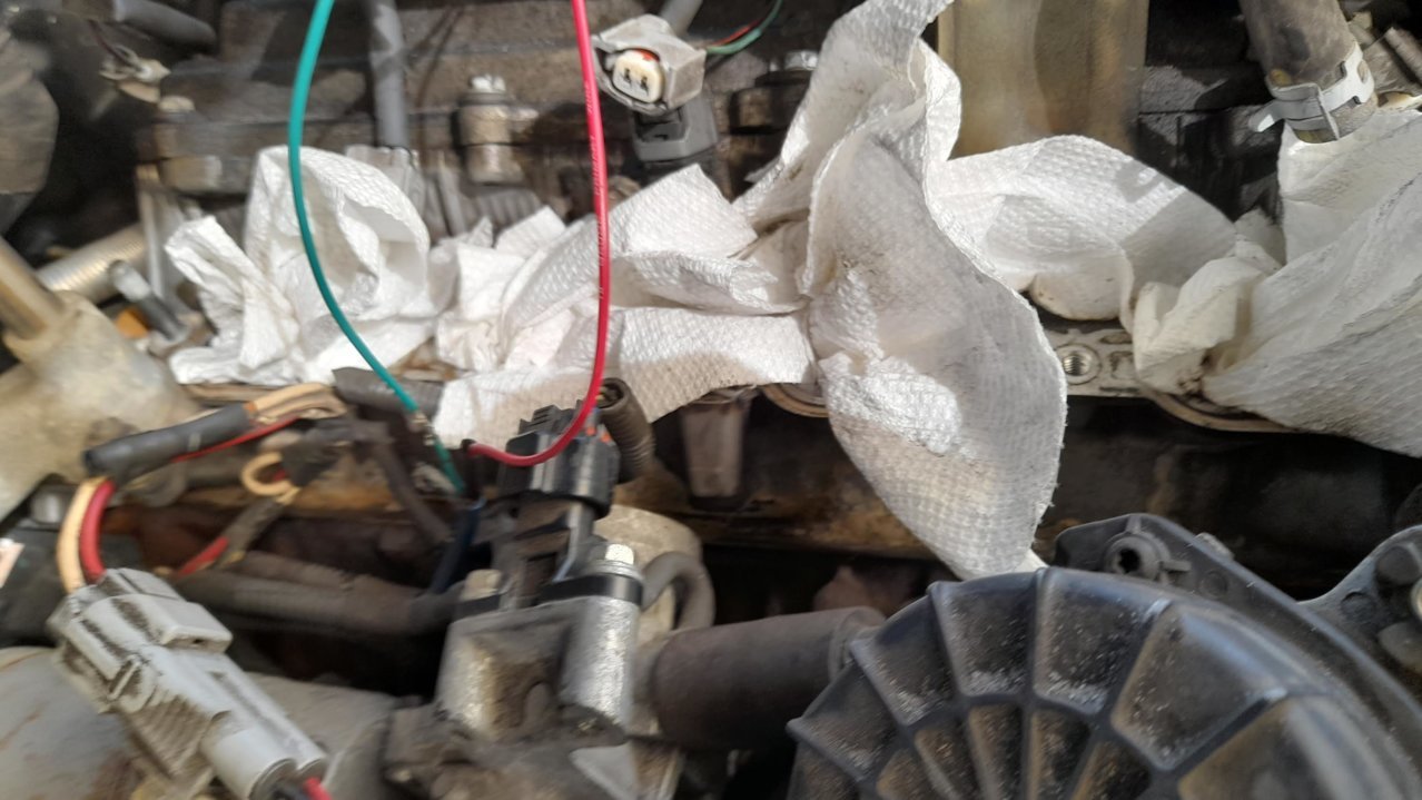

    Hello Everyone -
    Follow up from the continuing adventure of trying to save money and inheriting more problems.
    Got my truck out to my buddy's place in Port Charlotte this past weekend. He, being a former rocket scientist with NASA, offered to help because he had to rebuild an entire wiring harness for his MR2.
    The PDF document was a great starting point and the additional holes were plugged in by a guy who's got a video in three parts on this exact thing.
    I have attached a link to part one and this PDF document alongside this post.
    Some notes about doing the work from a professed shadetree mechanic:
    Be patient. Some of your plastic wire harness plugs are going to be very brittle and if you've never done the work they may be adhered in place due to heat and dust. We very slowly worked each of the plugs off where we had to disconnect any, by wiggling back-and-forth.

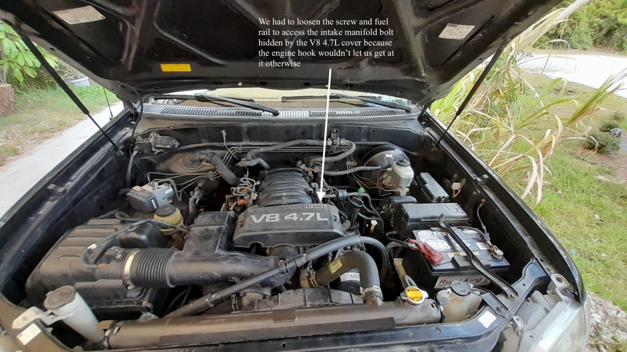

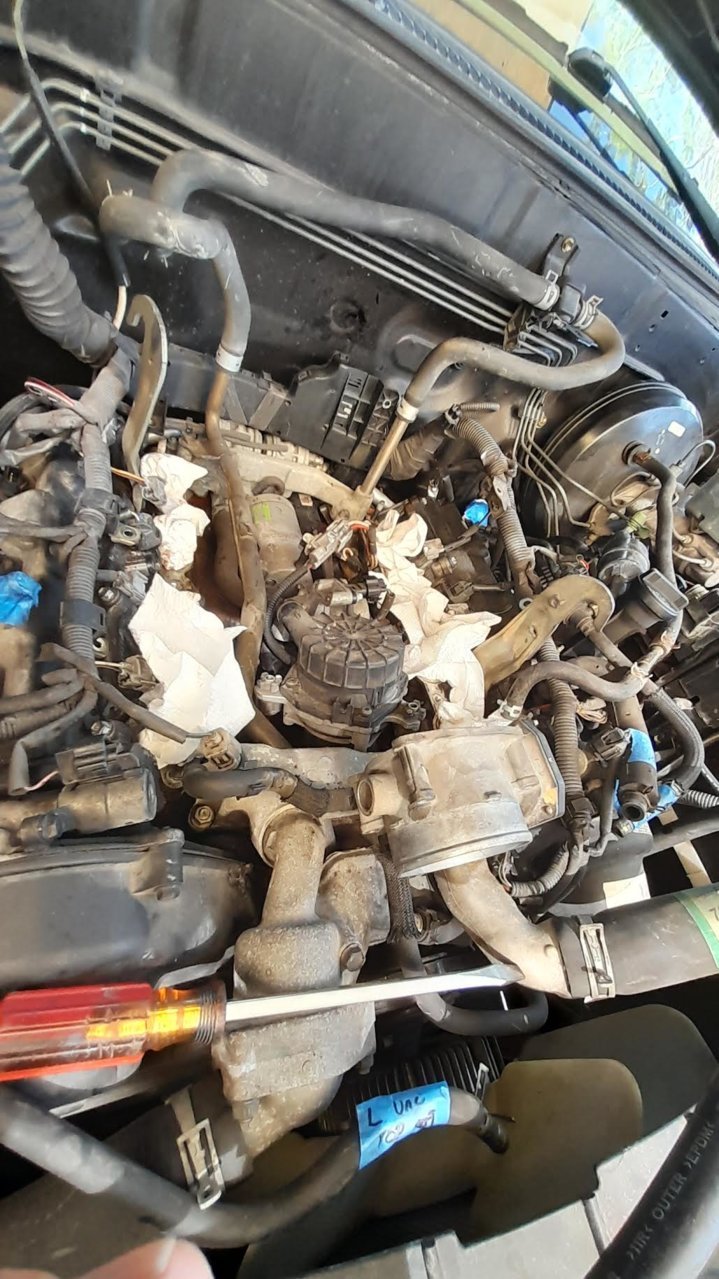

    When loosening the fuel rail, try to do it before lifting the intake manifold. I had the scare of my life when one of the screws came out of the hole and disappeared underneath. When I checked the intakes, a valve was open and my heart sunk into my chest. Short of a borescope, I knew my engine was going to die an untimely death. We got the shop vac and vacuumed the first massive pile of poop, I started looking around and realized from the PDF and the video there was more space. Underneath the blower and the antifreeze line was more debris.
    As it turned out, once the blower was moved, what had been the worst day of my life became the best moment of my life at that point when I saw the screw resting comfortably and another pile of rat poop and food.
    What my smart friend was doing with every screw was he had a magnet attached to his socket wrench so every screw came out and those that didn't he was able to extract with a telescopic magnet.
    We wound up not having to take apart the antifreeze lines or remove the blower. In the video the guy drains the radiator to disconnect that but it wound up not being a thing for us and my buddy was able to work around it.
    The throttle assembly in the back, held on by a single screw, and the wiring harness screw (back left corner as you are looking in the engine bay) have to be removed to get the intake manifold off.
    Plug the intakes as soon as the manifold is removed.

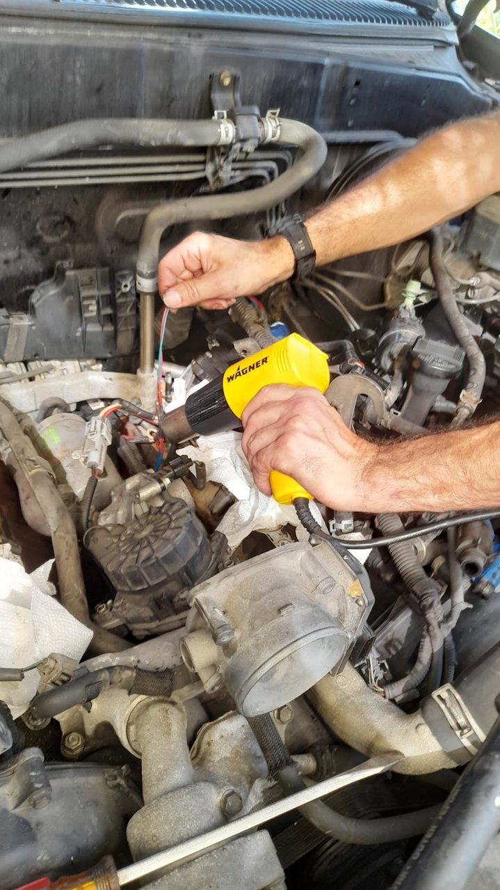

    The splicing itself? We picked up automotive heat resistant wire the next gauge thickness up, heat shrink tape, and high temp silicone. There was enough wire in the wire harness in the engine and the rodents thoughtfully left enough wire on the wire harness plug that he was able to splice without a problem. We used a soldering gun to solder the wire in place and then we used heat shrink tape to seal them. After that guy took a liberal amount of high temp silicone and coded the entire thing with it and once he had spliced both the red and green wires and everything was slathered in silicone and sealed, we sealed them together with another piece of shrink wrap for additional measure. Finally, just because, I used wire harness wrap over everything.
    For the hardware cloth, I wound up using a much smaller amount than I thought I would. I took two strips about 4 inches by an inch and I loosely folded it and then slipped it into a small 2 inch cylinder of the same material. I zip tied them to keep it closed and then as we lowered the intake manifold I allowed it to get sandwiched. I did this to both sides on the front. I didn't upload pictures of that, but I will.
    Tape everything. We used blue painter's tape and I took it a step further and for every hose I drew an illustration of the connector it went to. I know this sounds excessive but I didn't want any challenges.
    Every screw and nut and bolt we took out we put on the ground in order and corresponding to that side of the vehicle. In some cases, I labeled the bolts with the painters tape as well.
    The fuel Pulsator: not only is it critically important to make sure the washers are placed exactly the way they come off, but as you slowly and carefully turn your 22 mm wrench to tighten, make sure it pairs up snuggly to the outcropping or extension you are attaching it to. If these two aren't against each other, you may encounter a fuel leak.
    It took us 6 hours, but that included breaks for water, some quick food, panic scrambling to figure out how to get a screw out of the engine, and a trip to the auto parts store. Re-Assembly took about an hour.
    If I could wrap the entire engine and hardware cloth to keep the rodents out I would.
    I wanted to keep this as brief as possible, but if / when I think of anything else, I'll share here.
    The truck, I am happy to report, is back to my expectation of normal.
    I don't have enough to say as far as thank you goes, and I can't say it enough.
    Thank you.
    https://www.youtube.com/watch?v=TdDxNBER24A&t=541s
