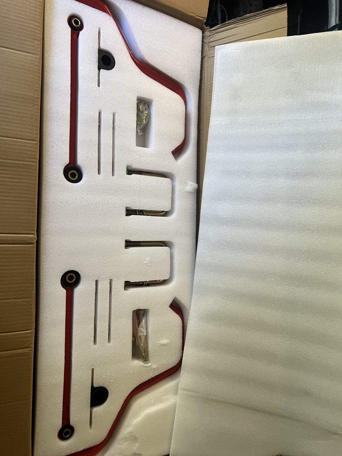

    Gotta say, it’s packaged better than most anything I’ve ever seen and there is a spot in the directions for those who have a tow hitch. Also pretty cool they put a direct email line for a full refund in the event Amazon doesn’t give it to you. Won’t be able to install it until Thursday as it’s 29* and breezy here at the moment.

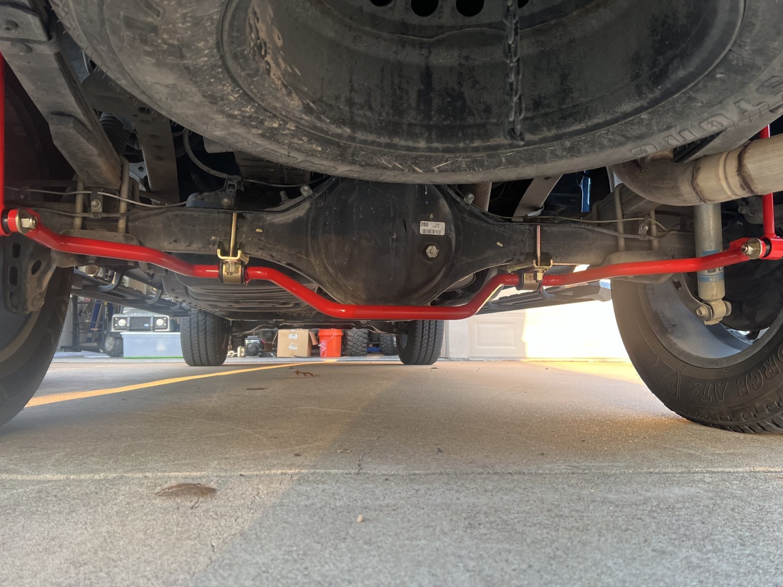

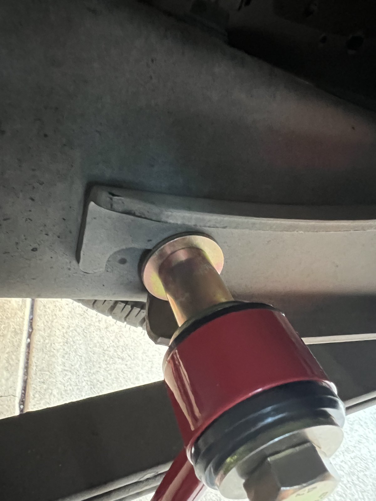

    Got it installed. About 45mins by myself. Pretty straight forward. Wasn’t a fan of how the instructions said to not put a washer in front of the spacer if you have a tow hitch but to do it if you don’t have one. They give you the hardware for both so I added the washer because the spacer is just slightly larger than the hole in the hitch.
    Also, the instructions don’t say to use a flat washer on the u-bolts but they provide them and lock washers. Not sure there is enough u-bolt length for all. I didn’t realize it until I had torqued everything down so I’ll try and zip those on tomorrow. Not a big issue.
    It doesn’t come with grease but it does say to grease the bushings so I put some Lucas red and tacky on them like I do everything else in the fleet.
    Overall, easy install and solid parts. Nothing to indicate it’s cheap or low quality.
    How instructions say to install links with a tow hitch.
    How I did it. This is how they say to do it without a tow hitch.
    Installed.

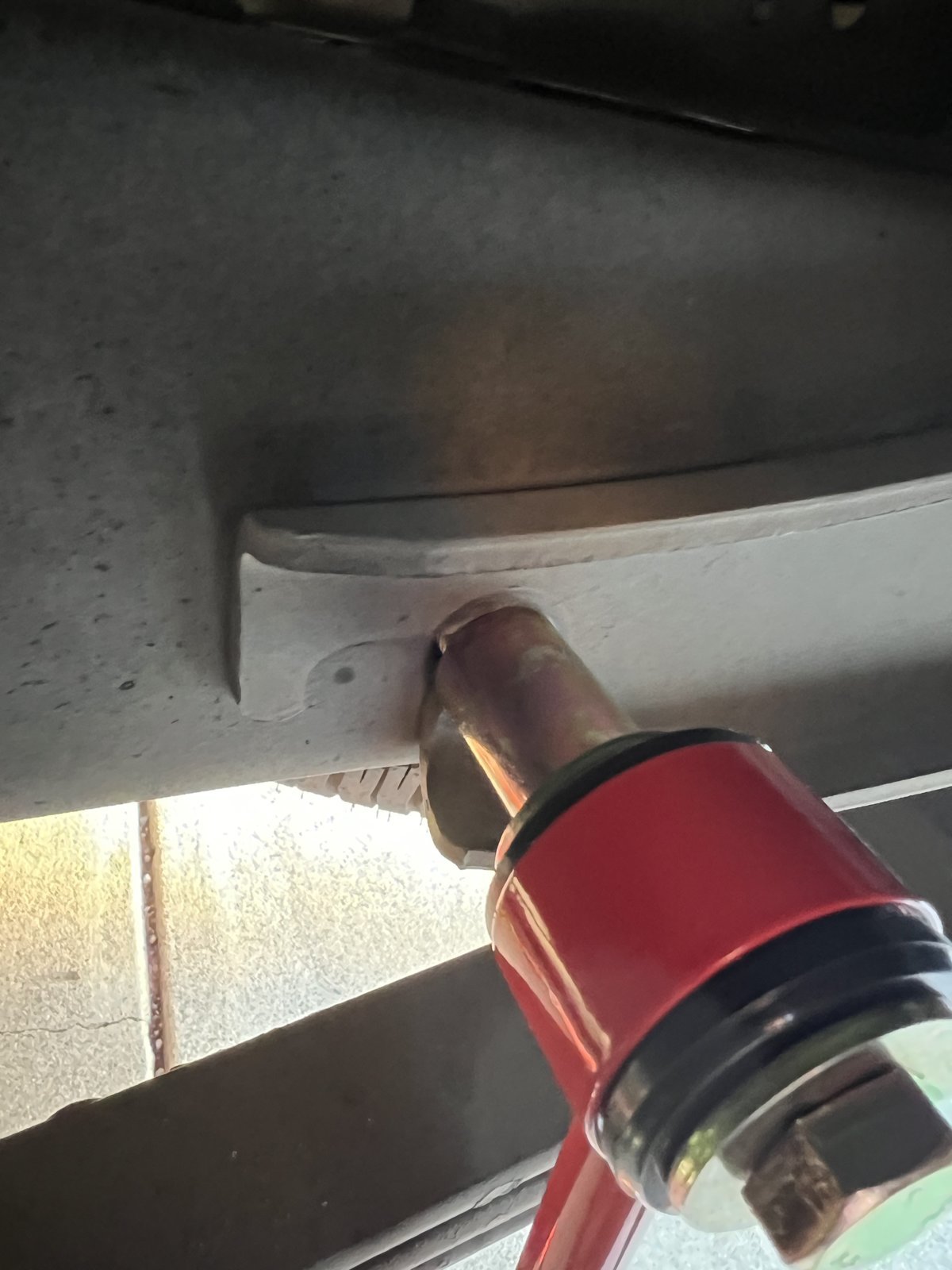

    Damn near identical down to the font and layout. The TRD one is wordier. According to the TRD one, my driver side u bolt is on the wrong side of the brake bracket. Not sure what half an inch of difference would make? I’d go take pictures of the instructions of this one but it’s already in the trash down by the street and it’s cold and I’m comfy.

    Decided to not be lazy and go grab the instructions.
    And in rereading these, they also say the driver side bracket goes on the other side of the bracket. Must have glossed over that part. What I get for rushing.
