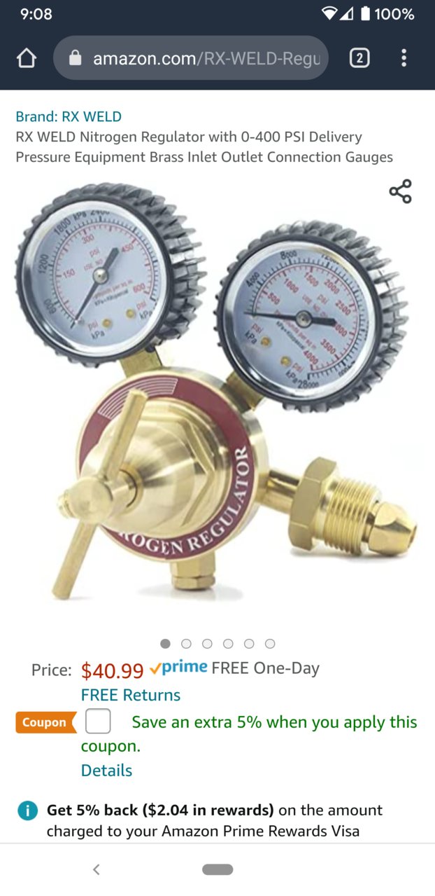

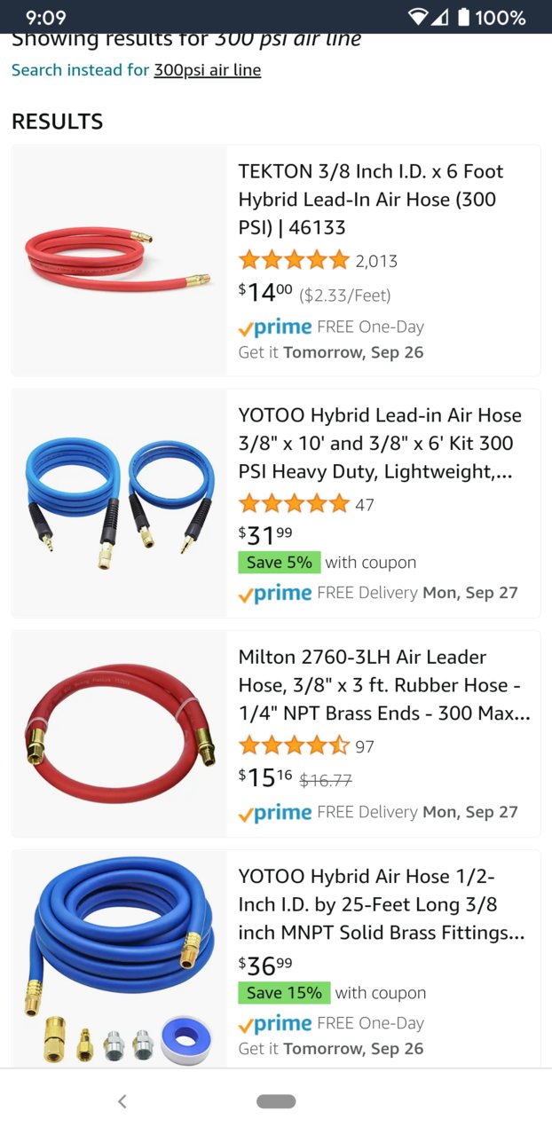

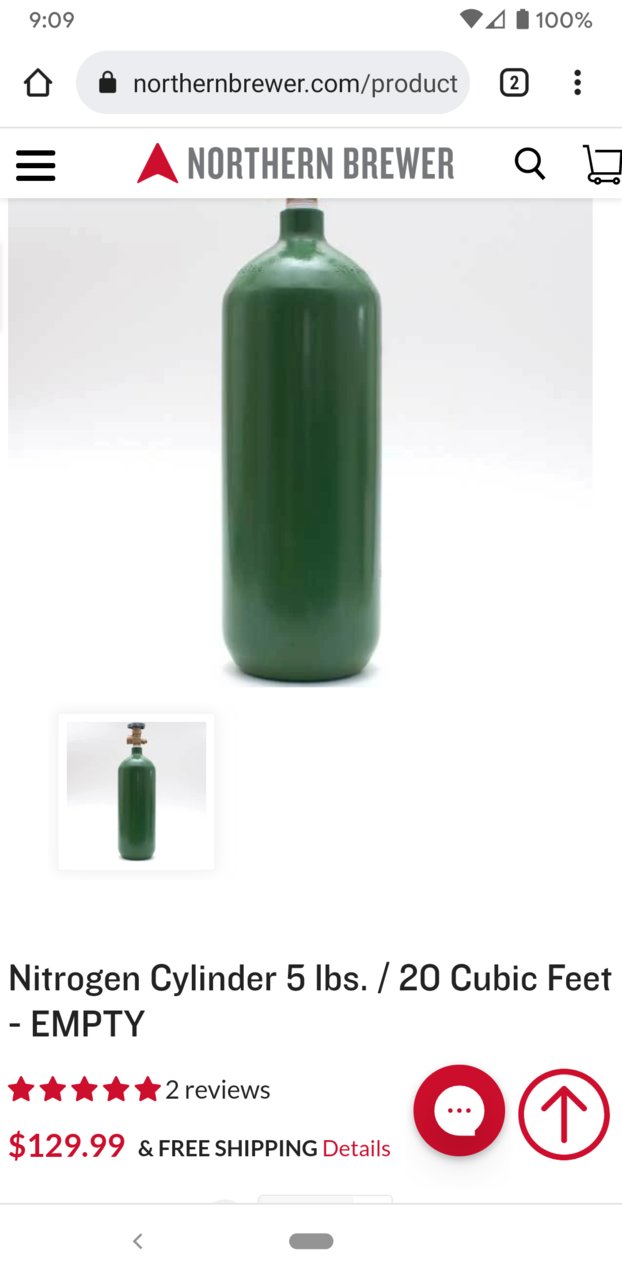

    Don't need anything fancy, this is what my setup is. Obviously everything after the regulator can be configured how you want, there's "no loss" air chucks and shit, personally I just have a regular chuck connected to a hose permanently connected to the regulator. Cheap and easy. Main thing is you want everything rated for 300psi or more, 300psi is generally the upper end that you'll charge a shock too. What's nice about the little bottle also is you can easily pack it for trips.
