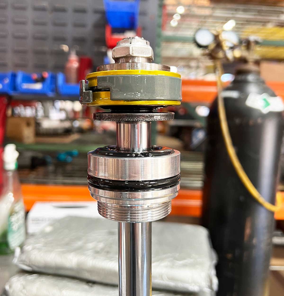

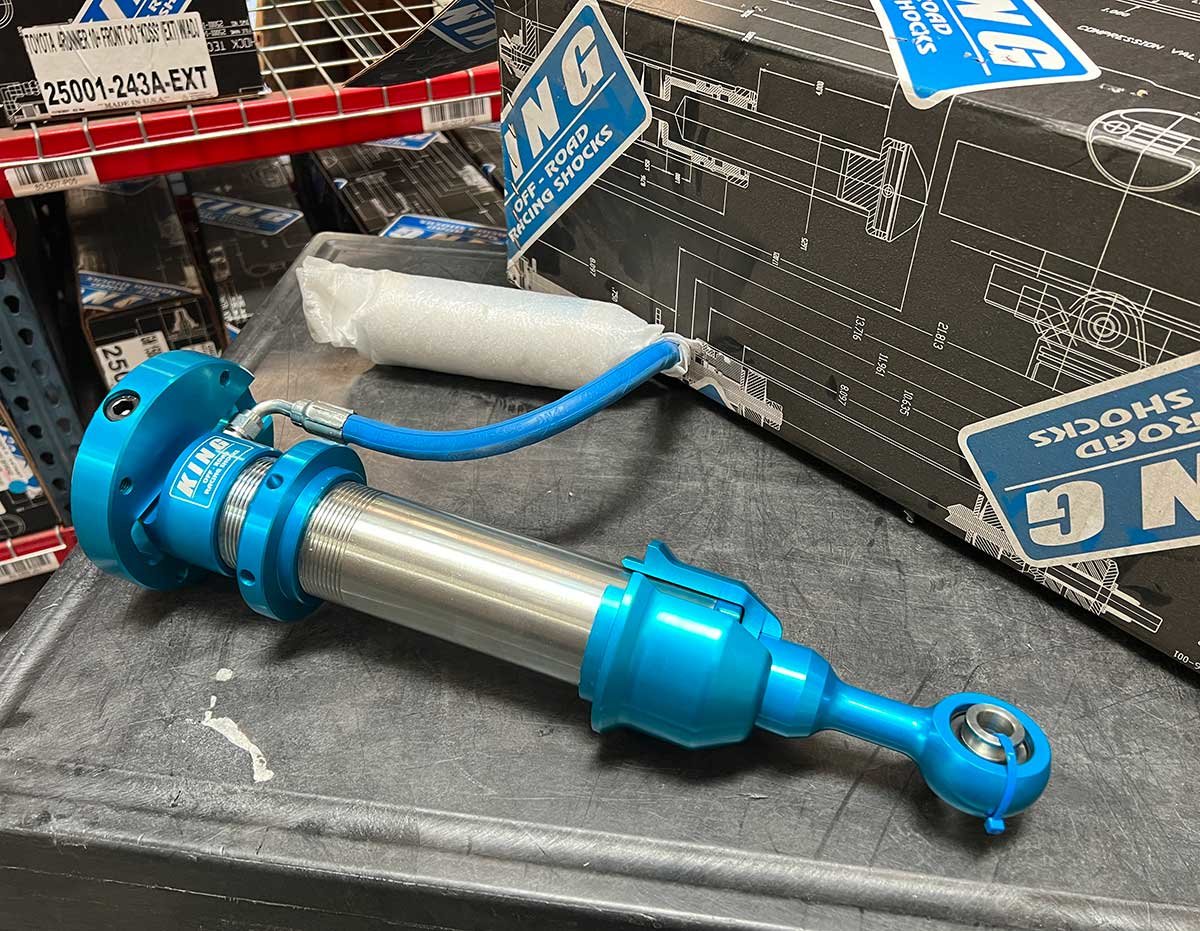

    UPDATE.
    Luckily we have a set of 2.5 DIA King Coilovers for a 07+ Tundra in stock (KRS-25001-143) so I personally went in back to open up the shock. See attached photo, there is in fact no spacer in these coilovers.
    I've been in talks with @Keithbickford about this as well. Hopefully he can report back if he finds something different on his shocks when he does a rebuild (fingers crossed thats not the case).
    If anyone else has personally seen something different with their own two eyes, please feel free to chime in. Hopefully we can squash this rumor once and for all.

    Thanks for looking into this. The lower portion of mine is silver. I’ll let you know if/when I open them up.
