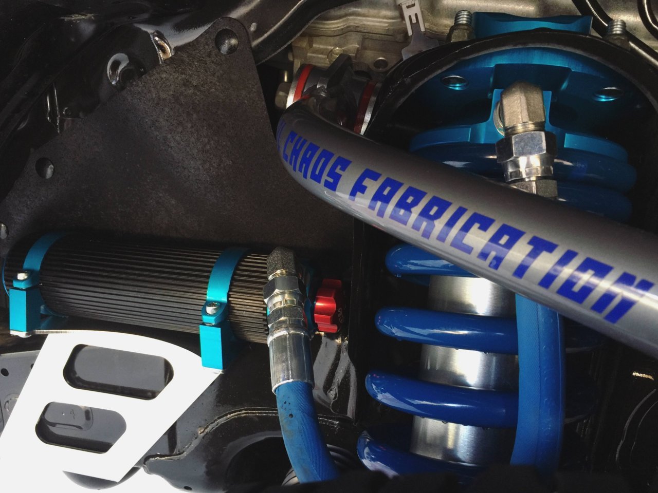

    King 3.0 come extended and recommend UCA
    here is picture of my 3.0

    @LBGlossWorks, badass! You got rears too? How much did you get them for? Is it making contact with your tie rods when turning?

    I have no tie rods issue at full lock, I paid retail and I’m running King 2.5 shock in rear.

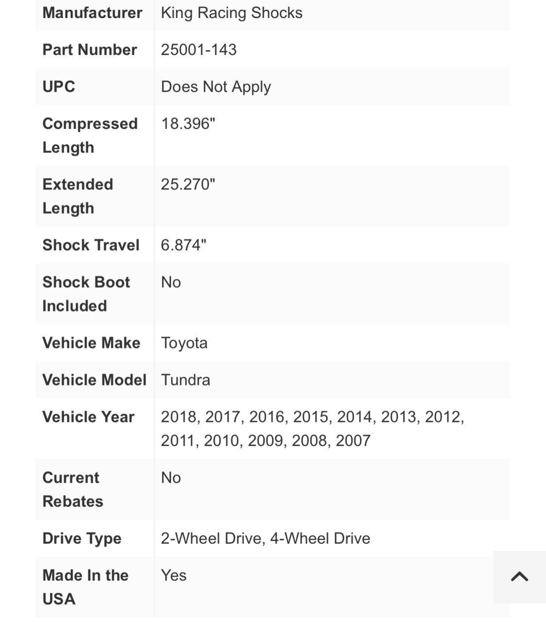

    -25001-143 King Coilover cannot be converted to a 25001-143-EXT. The EXT uses a different shaft and spacer <-- this is directly from our King rep about a year ago.
    -The 9" to 12" thing, no clue where those numbers are coming from. A 25001-143 coilover has about 7.186" of travel. This puts the wheel travel at about 10.56", extended travel (7.7" travel) pushes it to about 11.32" of wheel travel

    25001-143 King Coilover cannot be converted to a 25001-143-EXT. The EXT uses a different shaft and spacer.
    A 25001-143 = 7.186" of travel
    A 25001-143-EXT = 7.7" of travel

    Like mentioned above, you would need to measure the shock at full extension. You can reference the diagram below to help with where you need to measure. Then just compare those fully extended dimensions to 25.7" (this is the -EXT lengths) Its important to be very accurate with your measurements since none -EXT is 25.3"
