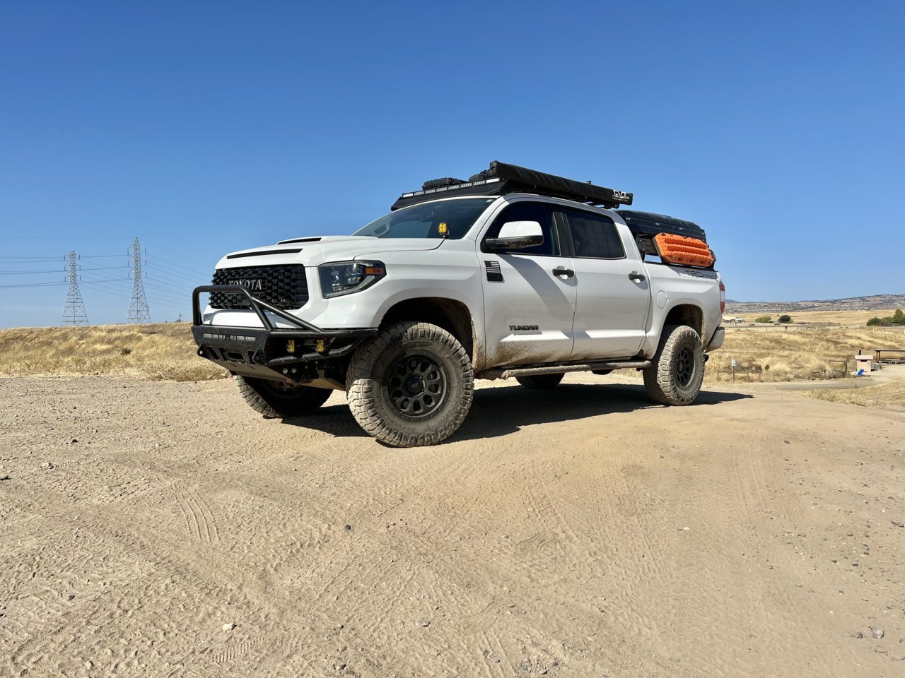

    Nice truck I like that stand.
    What shocks you have in the back with the U748?

    Thanks. I’m running Kings 2.5 with remote resi’s and adjusters all around.

    Stance is much better with the 700lb springs.
