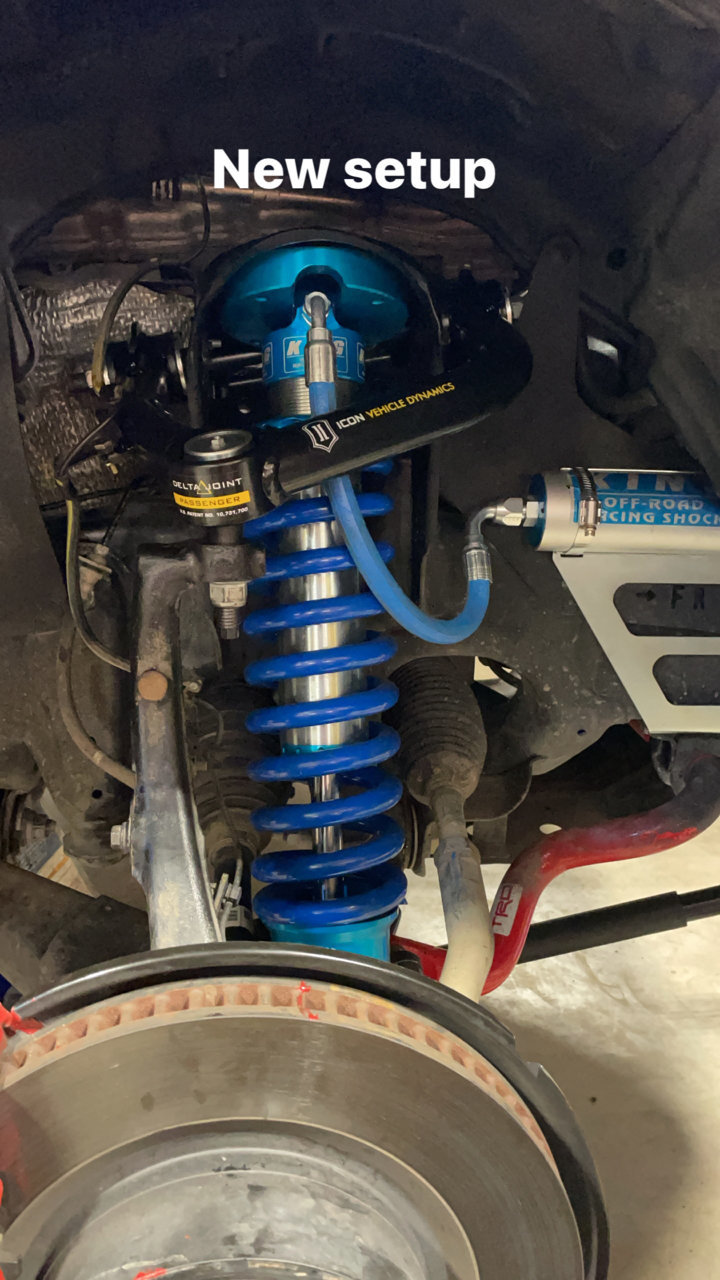

    Here’s a pic of the truck. I added some icon UCA which seemed to help things out about. Currently sitting at 5 turns on both springs. I’m going to be backing out 3 turns on each shock then get an alignment to see if that helps the ride quality.

    Here’s the set up
