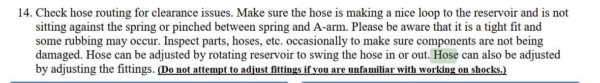

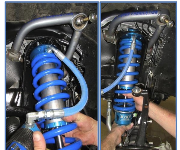

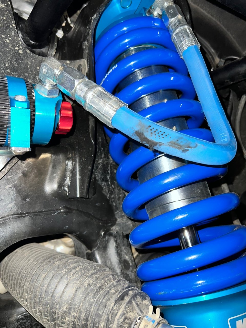

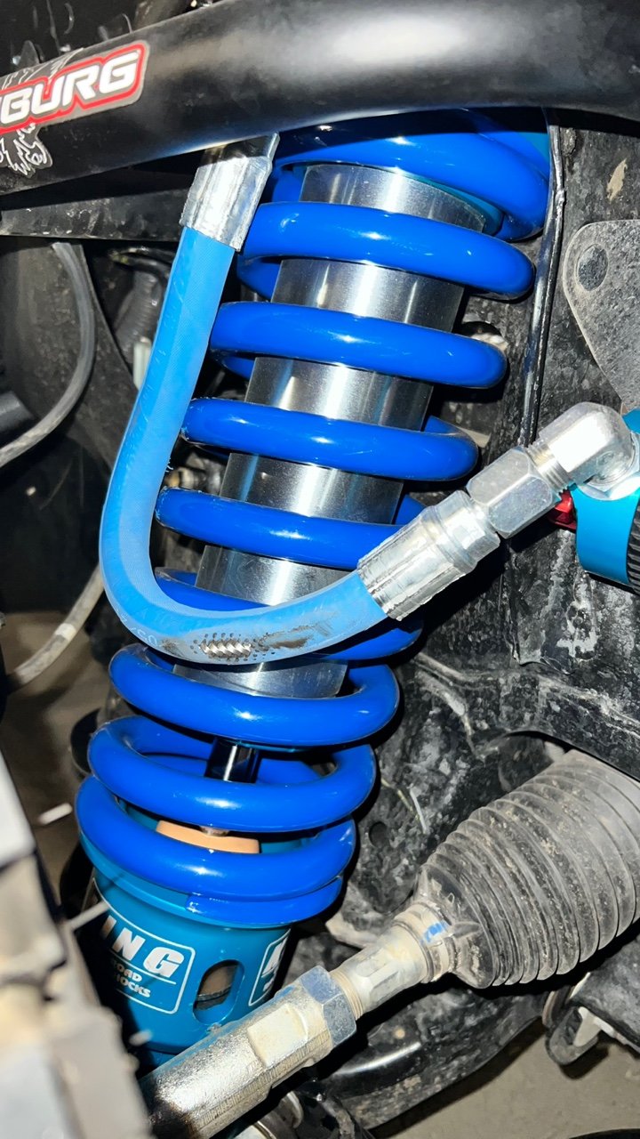

    Had my 3.0s for just over a year now and same thing happened to me but for a different reason because I have -15 offset wheels so they just clear them at full lock.
    Camburg clowned me by not giving me the longer hose like they gave you so the my Kinetik UCA's have the same effect on the hose but it's because my UCA is digging into the hose at full droop.
    So if anyone is thinks about buying these 3.0s from from Camburg, just make sure you tell them you need the longer hose option
