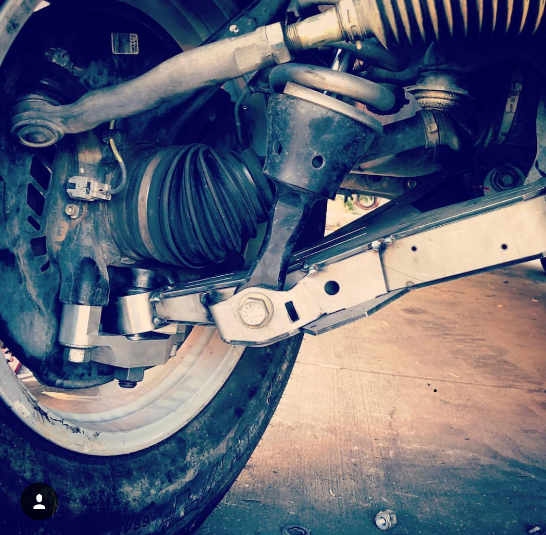

    Saw these today, stock length upper and lower control arms by LSK. They will fit 07- current Tundra’s.

    @ADSracingshocks - F 3 point ohh / R 2.5 - w/clickers @camburgracing - uniball UCA @rigidindustries - 40" amber/white split, Dually XL, D2 @coopertires - 35/12.5/17 STT MAXX @bayareametalfab - low pro bed rack @toyotausa - 17" rock warrior @sdhqoffroad - rock sliders, a-pillar @hondogarage / @apple / @gaiagps / @dualgps- navigation @wheelersoffroadinc - superbumps
    Yes but no.
    The amount of caster built into Camburg arms has been known to cause issues.....I still run them.
    They are 7+ cams nuetral. If you remove caster the wheel actually moves back to the cab mount. With that as well, may run into some contact issues with running 3.0s

    nice but I like the new offerings from TC better. LSK late to the game with Toyotas..

    Not necessarily true. I am not personally paying 2400 for lowers....let's see where LSKs come in price point.

    $3100 for LCA’s is crazy expensive! Add UCA’s to that and your at around $3900 for stock length arms. The TC LT kit with UCA’s & LCA’s is $3500. I realize you need axles if you have 4wd and glass but damn they are proud of those LCA’s.

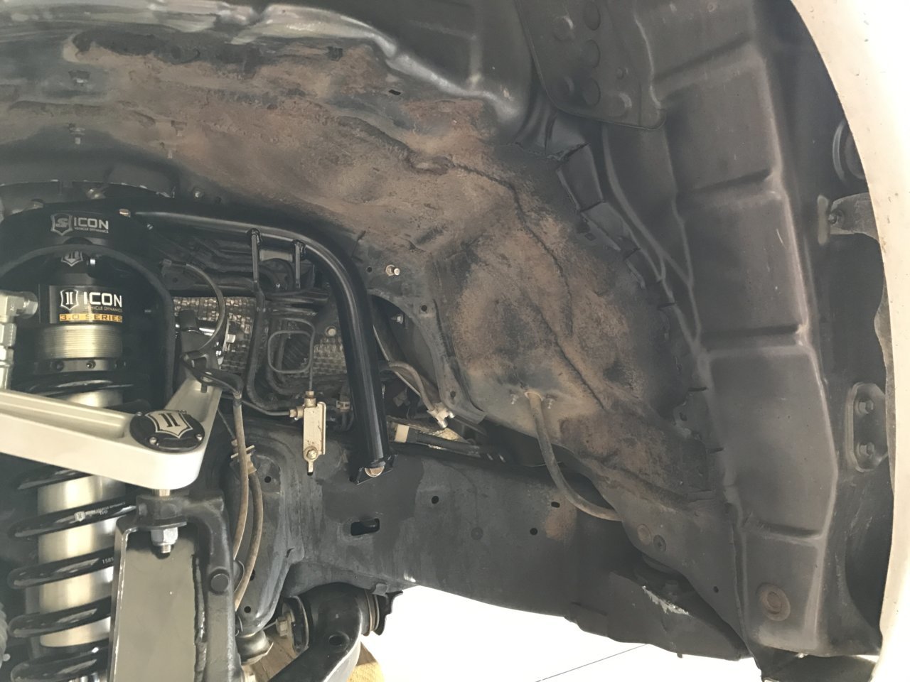

    I had to take a bottle jack and push my inner fenders up almost 1.5" all around and trim the forward fender mount. I also completely folded my rear pinch weld.
    But my body mount is untouched. I pushed my wheels forward all the way with the lower control arm (you have to make sure they are square to the frame so you don't have uneven wheelbase) and then had the alignment done using the upper control arms. I have about 7 degrees caster
    37's arent that difficult to fit whether you're LT or MT. You just have to make sure you have the correct wheels and alignment. Its not enough to say "I have 7 degrees caster". You can get 7 degrees in a lot of different ways. The key is to move the wheel forward and then achieve sufficient caster
