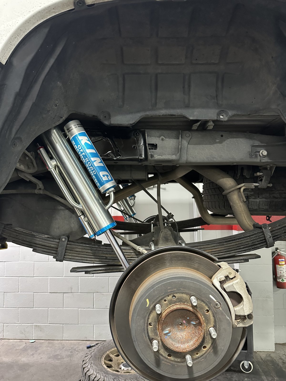

    how does she ride?
    Did you order the shock with the relocation mount? or separate
    wanna see if there is a remote resi option

    It rides great man! I ordered direct from Daniel at Camburg. Service was great and he answered all my questions. I got the kit and shocks together, the shocks are SPEC for this kit from King for Camburg. I don’t think Remote Resi’s are an option.

    you can indeed order smoothbody 2.5 or 3.0 x12 smooth body shocks for the kit.

    What are you seeing as a benefit with remote reservoir bypasses in the rear?

    Did you do the welding yourself? I've been trying to find someone local who understand the meaning of "cycling" the suspension but no dice.

    Rather than taking the leaf packs apart to max out travel, it seems like a fella could lift a front tire with a forklift till the rear tire just comes off the ground. Use the driver’s side for example. That would compress the passenger rear pretty good, and fully-ish extend the driver rear. Since the shocks are outboard of the spring, it’ll create a longer extended measurement for the shock than jumping the truck.
    I’d think if you set your new 12” shock to be a 1/2” from full extension at this point you’d be in pretty good shape. With the shocks both mounted foreword of the axle, you’re going to get quite a bit more than 12” of vertical use from that shock. Not saying what your travel numbers will be, just that a 12” shock will go a long ways like this…
    Obviously, the process above doesn’t take bypass tube location into account. I’m not sure if this will put you in the “ride zone” correctly…

    Yes I have a guy in the Monterey area that did the work.

    What leaf pack is that? I’m sure you posted it somewhere

    Deaver U748’s.
