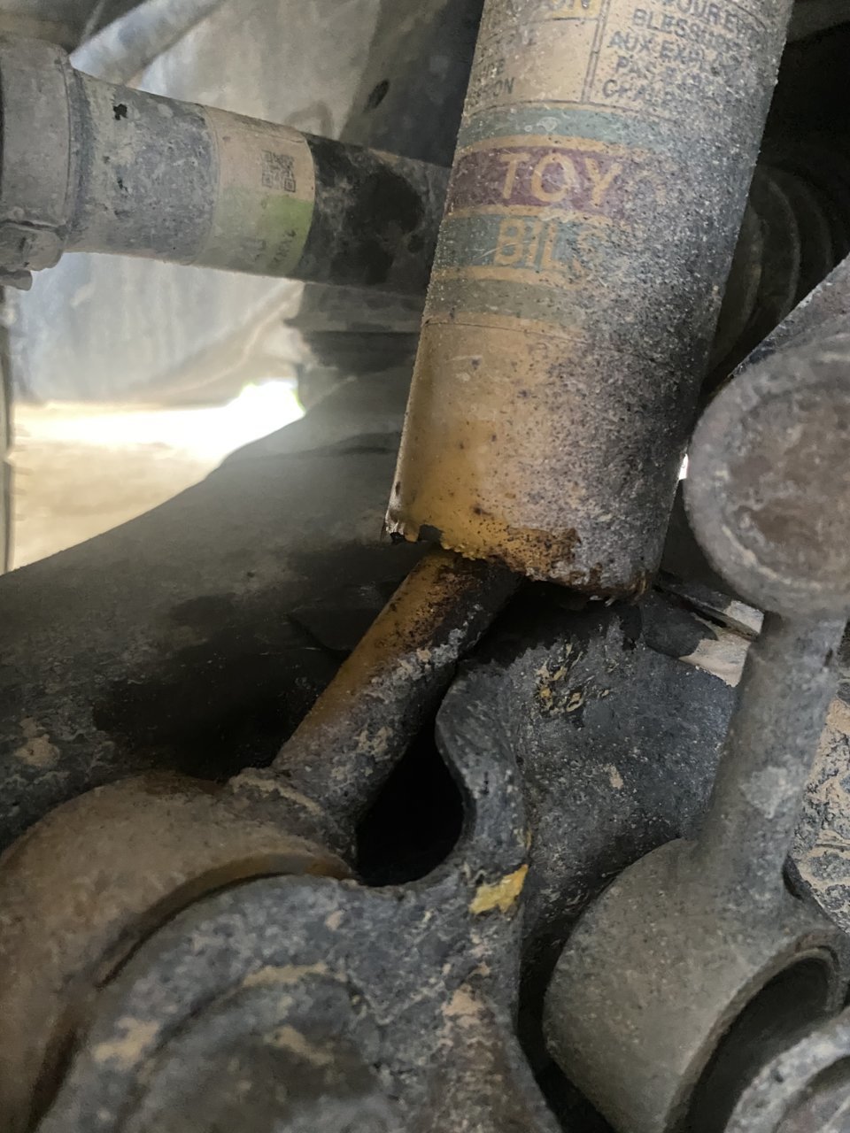

    Do you know the main cause of this shock failure? This may be more of an issue in regards to a spacer lift and not running extended length bump stops. Running Kings with stock bumps will be fine since their compressed lengths are similar to a stock length coilover.
    BigHornMtnTundra[OP] likes this.

    That is good to know. I’m not going to run spacers like king recommends, and am going to stay at the height they come out of the box. Hopefully they come set at 2.5
