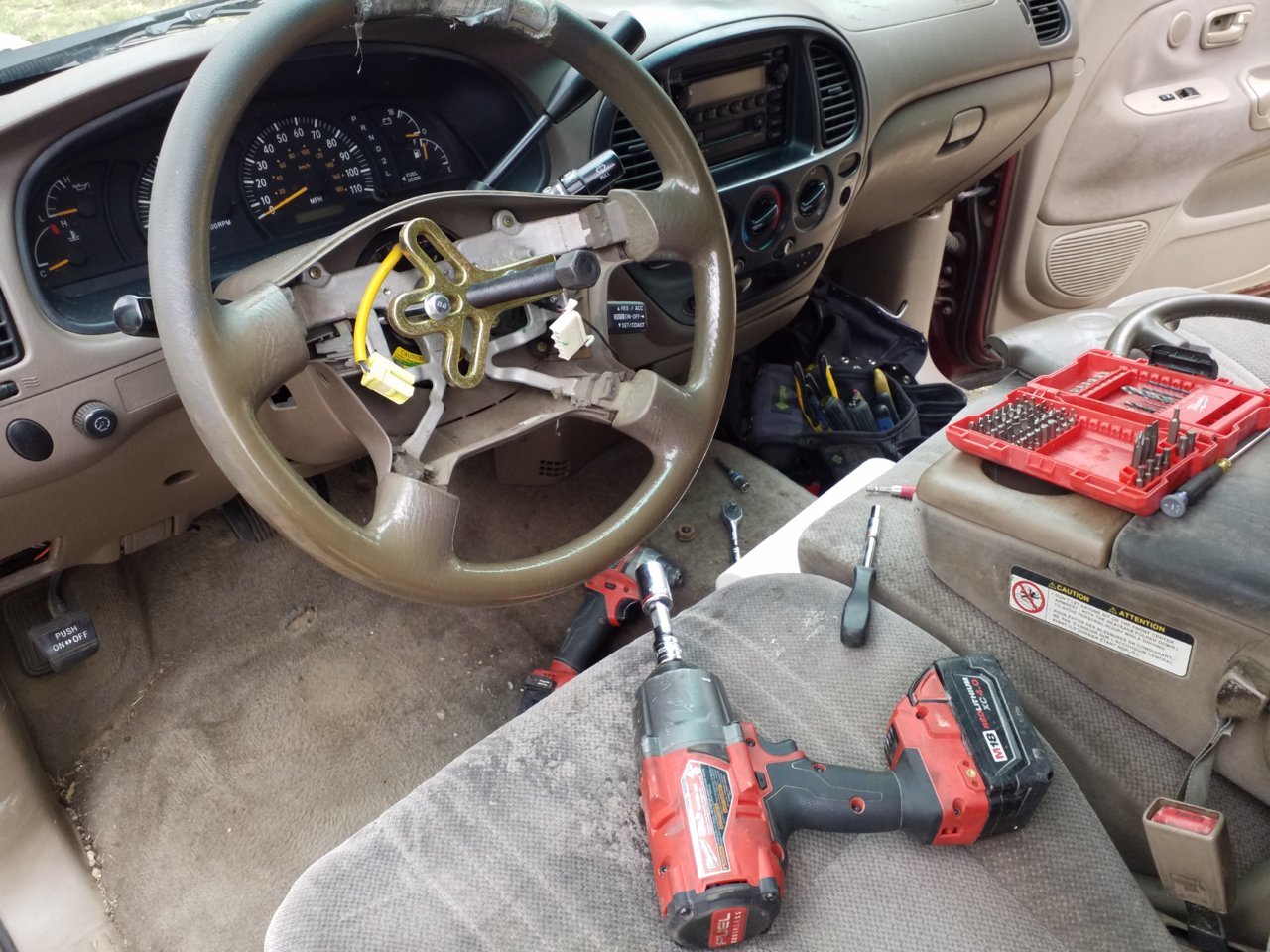

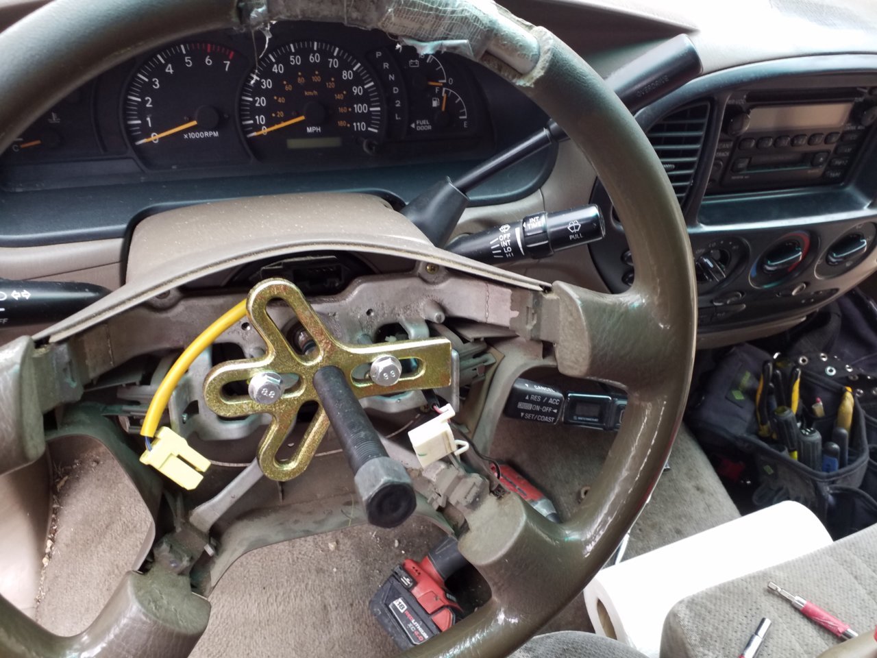

    It says use a steering wheel puller, but I just used a standard crows foot. It's a little awkward but it works.
