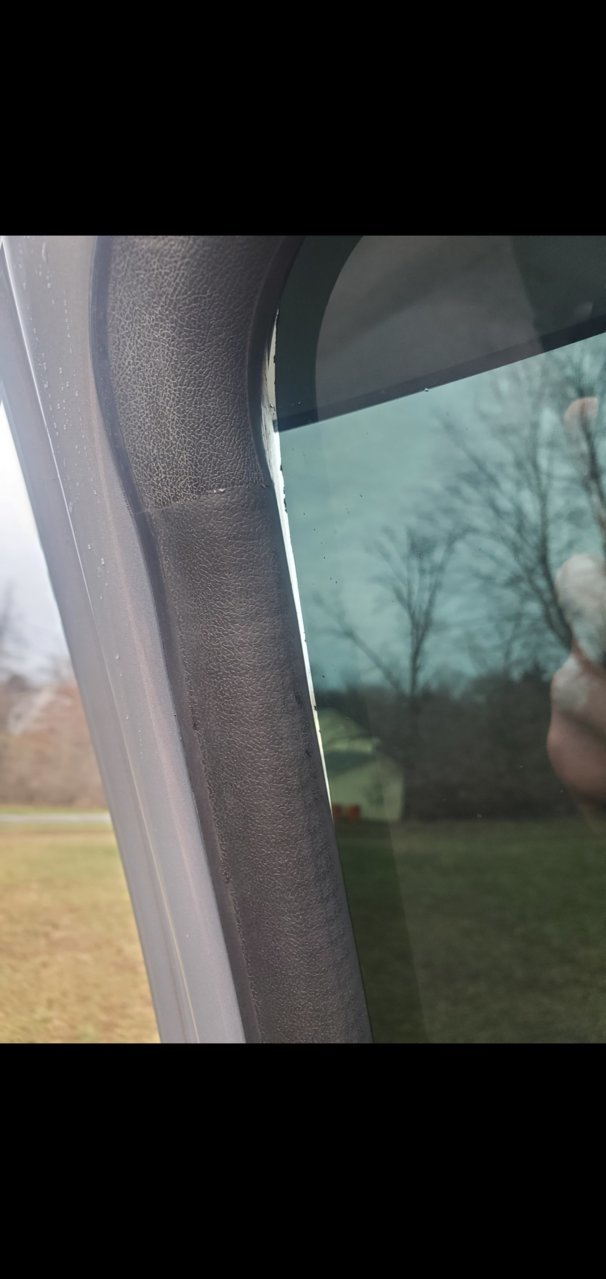

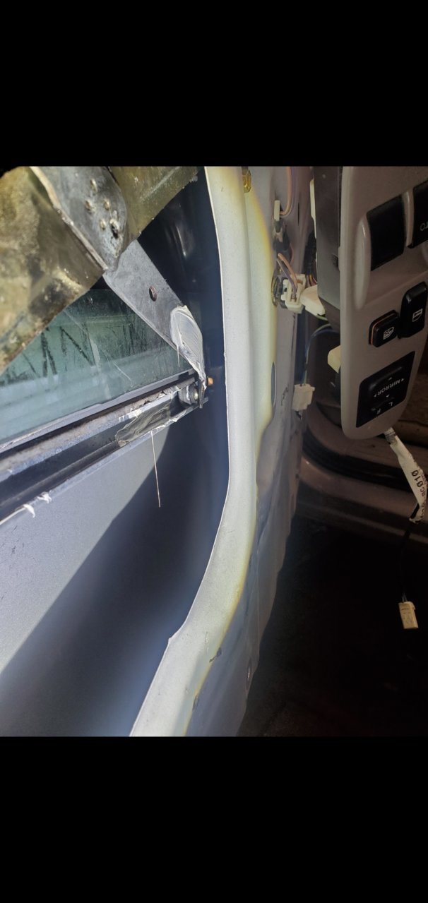

    Now I have to mess with the driver’s side window cuz it goes up a lil off track! Ugh

    Couple of possibles:
    https://www.tundras.com/threads/wha...-gen-tundra-today.2558/page-1330#post-2730901
    https://www.tundras.com/threads/wha...-gen-tundra-today.2558/page-1295#post-2691053
    There was another one on here recently, I can visually remember the picture of the window having a gap on one side, but can't remember who the person with the problem was.
