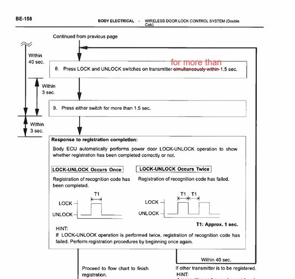

    So I've been struggling with my new-to-me 2005 double cab and getting remotes programmed. The car came with only one generic remote that had no markings or codes, either on the case or on the PCB inside the case. I ordered remotes and tried several different programming instructions, and none would work. I could get into programming mode with the attached document, but could never get the remotes to be recognized. I confirmed that my truck had factory installed keyless entry, but it has "KARR Security" stickers on the windows (?!?). Anyway, after many (MANY!) attempts, much use of expletives, and poring over forums and threads like this one, I found that the instructions are WRONG. When using the following modification (which matches the next step), I was able to program the remotes without issue. I hope this helps anyone else that might also be struggling:

    Guys...first thank all of you for your input and guidance! I was able to successfully add a BAB237131-022 key fob to my factory installed RS3000 (BAB237000-129). Of course, in order to program the key fob...I had to correct the wiring under the ignition switch since it was looped together. After that...worked like a charm. I did want to share an issue I discovered after successful programming. The range of my key fob was pathetic...like 1-2' from vehicle...and it was spotty reception. I tried extending the antenna from the RS3000, but no change...then I thought it may be the battery...so I opened the key fob. Inside there is a metal battery contact that is connected to the circuit board, which when closed is pressed against the circuit board. There is a thin dielectric coating to protect the metal contact from shorting against the circuit board, but the manufacturer must be aware of this issue because a irregular shaped piece of adhesive (definitely hand cut) was placed in this area as well. But as you can see in the pic with the red circle...the contact had cut through the original piece of adhesive and was allowing the contact to short out. I placed 2 layers of electrical tape, closed the key fob back up...and BAM!!! I can now lock/unlock from up to 50' away. I hope this helps someone down the road.
