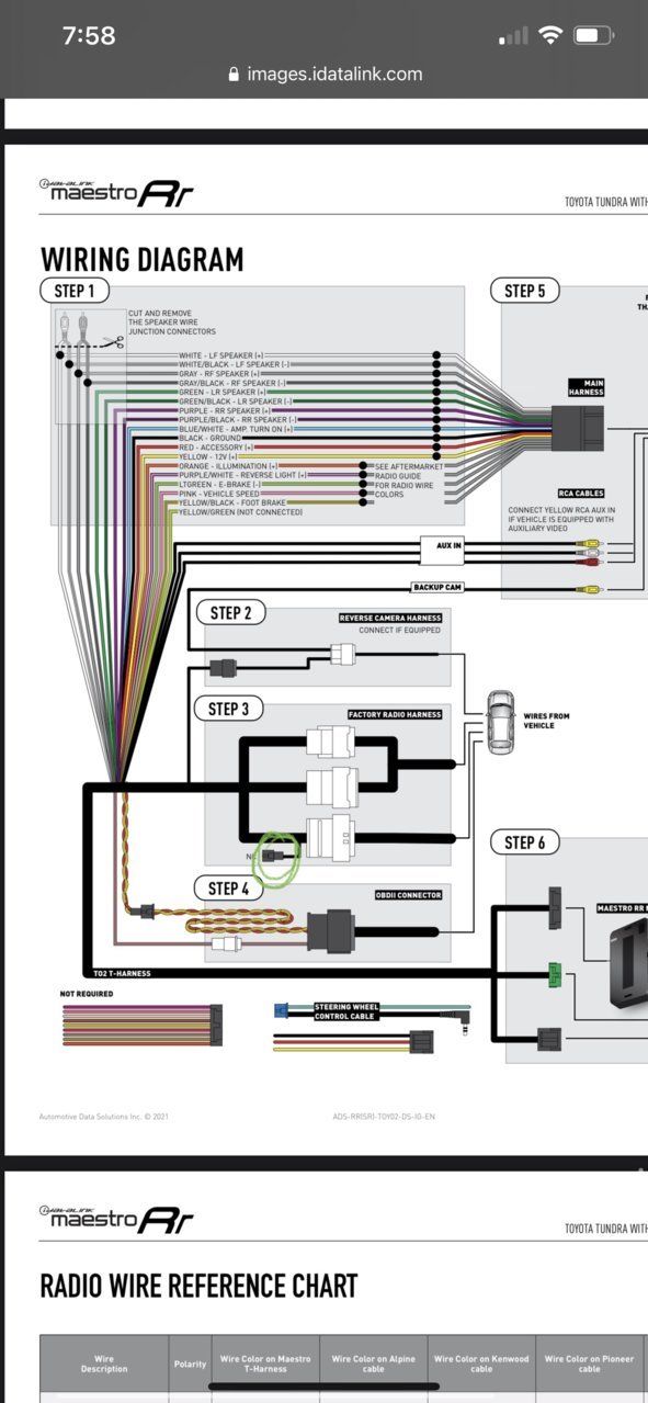

    Check and make sure nothing is plugged in where the green circle is...

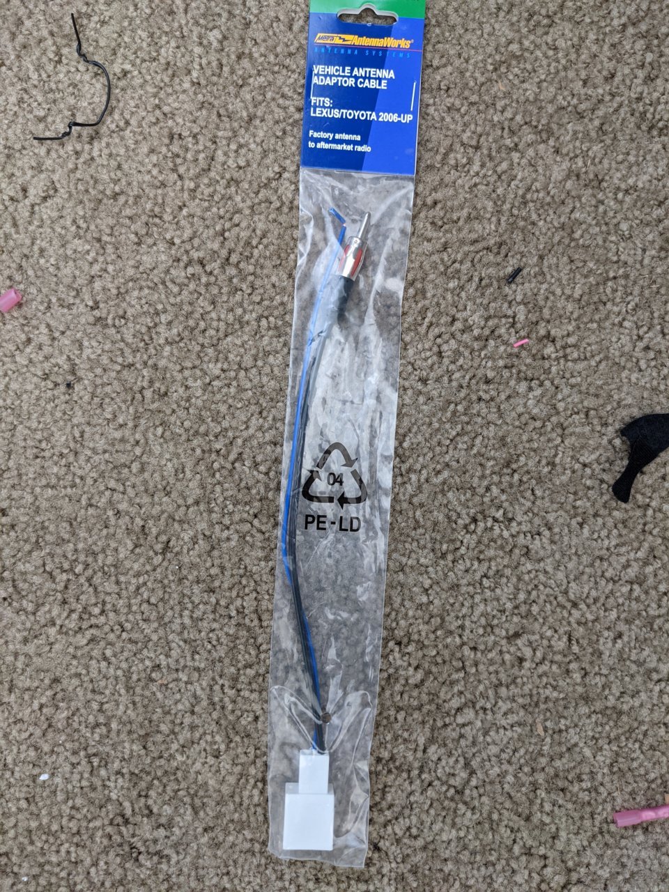

    I haven't put the harness in the truck yet, I'm wrapping all the wires to keep it clean.
    Is this cable required? If so, I have no idea how to hook it up.

    You should have a connector for that in the truck. It was plugged into the stock HU and this adapter will connect your antenna to the new HU.

    974
    Where does the blue wire tap to?

    Looks like I need to tap it here to ant cont.

    I left mine disconnected but I also don’t have the newer shark fin antenna. Not sure if it is required or not.

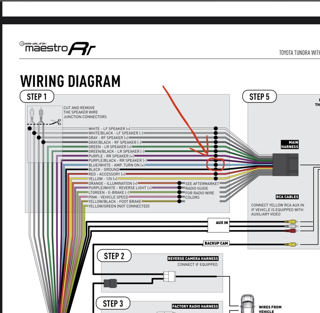

    Now for the amp turn wire running to the amp from the head unit, do I tap that to (p cont) on the kenwood harness or the maestro harness (amp turn on)?

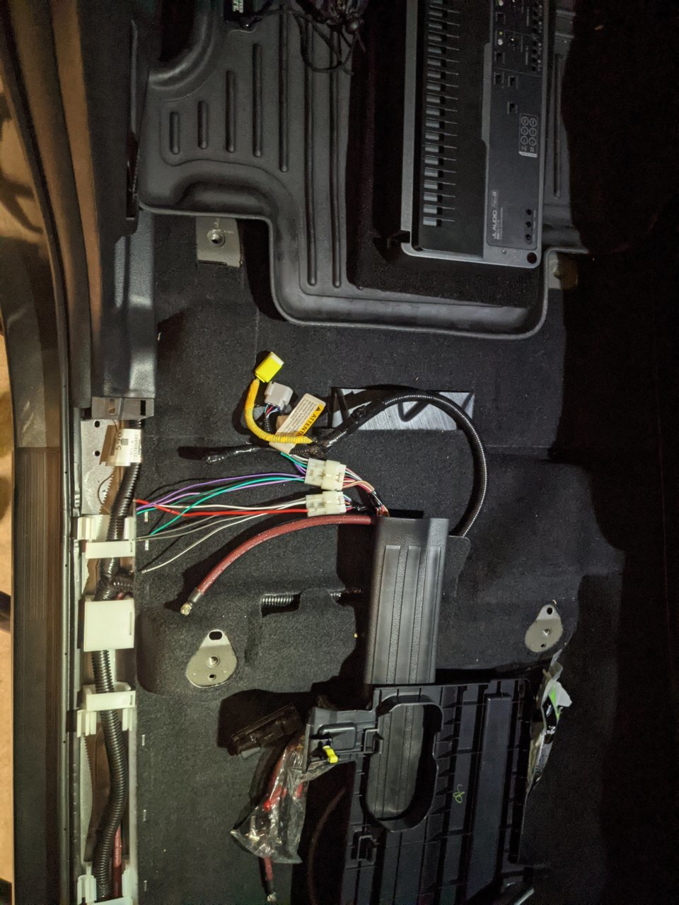

    Maybe @Danman34 can weigh in. I didn’t run an amp turn on wire from behind the dash - I used a wire on the Tech12volts underseat harness. I’m guessing you could group it with this connection or tap into the same wire.

    I believe it may be the (P Cont) on the kenwood harness so it will send the signal from the HU to the amp. If I tap it to the maestro I don't believe there will be a signal.

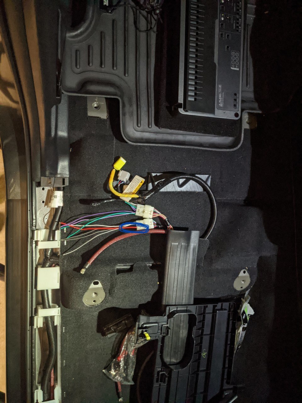

    Doesn't the truck have a remote turn on? Not sure which wire it is coming from the harness under the seat. Maybe the red wire? If that's the case I don't see why one would run a independent wire from the amp to the HU.

    Yes, the one circled in blue. That is what I used and why I didn’t run a separate amp remote wire from the dash.

    I'm going to just run it like you have it then, no need to add a additional wire. Thanks for the help today.

    That’s for a power antenna. Like an old school retractable antenna. That’s not the amp turn on. Run the amp turn on from radio directly to the amp. Do not go through the maestro harness.

    Which wire is the amp turn on for the kenwood harness? The (p cont.) wire in the picture is the only wire that is described to turn on the amp.
    Edit: I see we are talking about two different things. I hooked up that antenna wire to the Toyota adapter wire. What wire do I tap to for the amp?

    So for this adapter, the blue wire doesn't need to be tapped anywhere?

    That’s for your am/fm antenna. The male piece plugs into the back of the radio and the female connects to the factory plug behind the dash. You do not have a power antenna. The blue wire Is not needed.

    Okay, I'll cut the blue wire on it since I don't need it. Going back to the amp wire, so do I tie the wire from the amp to (p cont) on the kenwood harness?

    FYI...on my 2020 I DID need to power the FM/AM antenna. I got one local station without power and it works perfectly with power. Apparently, this was a change made for 2020.

    I confirmed with James at Tech12volts that the wire will need to run from (P CONT) to the amp itself.
