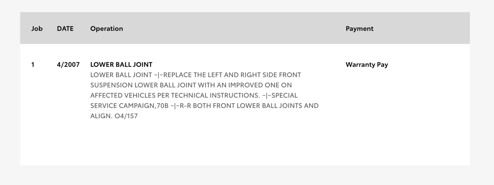

    Looks like LBJ recall replacement was performed by a dealer in 2007. I'll have them check it when they do the timing belt etc, and everything feels tight, so it sounds like I'm good?
    Do the improved recall joints have any known issues?

  8. Apr 2, 2024 at 9:56 AM
    #38
    badass03taco
    badass03taco New Member
    Mar 8, 2024
    #113307
    424
    2005 Limited Double Cab 4wd
    How do you guys look up everything that has been done to your VIN without taking it to the dealer? I have seen a few chime in before in threads like this and tell the OP what all has been done, are these people who work at a dillership and just being nice with the info or is there a way to look up everything that has been done to your VIN?
    I went thru the Carfax on mine when i bought it but it didnt have those details about the ball joints or any of the other TSB stuff. If i can look it up myself, does anybody gotta link?

  10. Apr 2, 2024 at 10:00 AM
    #40
    87warrior
    87warrior Whiskey Tango Foxtrot
    Nov 10, 2023
    #106686
    221
    Kansas
    2004 DC 2uz 4x4
    The recall ball joints will eventually be a problem when they wear out. However, your truck only has 60k miles on it with fewer miles on the replaced ball joints. I wouldn't worry about the ball joints for another 50k miles or so.

  14. Apr 2, 2024 at 10:14 AM
    #44
    badass03taco
    Mar 8, 2024
    #113307
    424
    5/2014
    04-06 TUNDRA RUST
    04-06 TUNDRA RUST ~|~ORDER KIT FOR DOD RUSTPROOF ~|~CERTAIN 2004-2006 TUNDRAS MAY EXHIBIT SIGNS OF RUST PERFORATION ON THE FRAMES ~|~RUSTPROOFED FRAME PER DOD RECALL OP: 3628C2
    does this mean the frame was coated with the rust inhibitor stuff?
    and this means the LBJ was done?
    11/2007
    70B RPL BALL JNT,CK&ADJ ALGN SSC
    70B RPL BALL JNT,CK&ADJ ALGN SSC ~|~70B RPL BALL JNT,CK&ADJ ALGN SSC ~|~COMPLETED 70B CAMPAIGN
  15. Apr 2, 2024 at 10:17 AM
    #45
    shifty`
    shifty` Just like witches at black masses
    Jun 20, 2020
    #48239
    28,344
    ATL
    '06 AC Limited V8/4WD
    Yes, and you're ineligible for any frame campaigns as a result.
