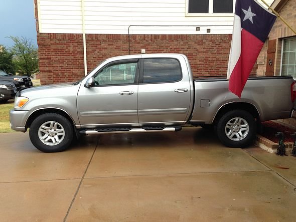

    Welcome to the forum @Bob71
    Your truck is a double cab.
    That's what the full 4 door Gen 1 Tundras were called.
    Funny you put 'New air pump' in your description.
    That was the only mechanical issue I had with my 2005 double cab in the 10 years I owned it.
    It disintergrated at 90K miles just after the ext warranty ran out.:D
    Also the the ball joint recall early on.
    Besides that it was a great truck until the accident..:thumbsup:
