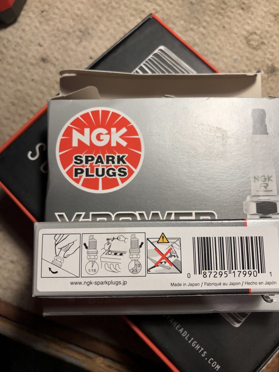

    So, what we've learned thus far (that's part of what this forum is) is that apparently there is a difference between the '04 and '06 manual?
    The spark plugs on our trucks need to be checked/ re-tightened in 5-7000 after installing.
    Not, to assume anything. Even if it's in a picture, it may not apply to the current situation. It may be just " in the picture".
    DON'T use anti-seize on spark plugs or lithium grease.
    Question EVERYTHING

    True, reduce torque buy30-40%. Bolt tension and torque are not necessarily the same. Dry bolts have a lot of friction and the torque is being used to overcome the friction to get the proper tension. I lubricate because I want them to come out next time. I've worked in some industries where the axiom was tighten till if almost strips and back off a 1/4 turn.:eek2: :D Also, people need to be aware of the fastener grade not just the size.
    As far as plugs, you don't need a torque wrench if you're experienced. I run the down till the washer is crushed then give it another bump of about an 1/8 of a turn. I have never stripped a thread installing a fastener unless it got damaged from being seized on the way out.

    Just a thought, but perhaps the reason the plugs are needing to be retightened every 5k is because they aren't being properly tightened. I don't think thats normal to need to retighten them.
    I trust a torque wrench more than I trust myself. I'm not a pro, barely an amateur. :D
    I just got a new torque wrench because I didn't trust my old cheap one which I had dropped. I'll give it a shot when I replace my plugs soon.

    Thats a wide range. Guess its a matter of getting it close and rolling with it. I’d stick it at .041 ‘betweener’ range. Max range is way off, but will still work in third world.

    I think that's probably a safe assumption. My train of thought also. But it can't be a bad idea to check them. It's not like the FSM has all the correct info 100% of the time. And the expansion and contraction sort of makes sense.

    They loosen due to laws of thermodynamics. Everything is subject to them. I’ve changed many plugs in Japanese cars (4 cylinder) and some were slightly loose at 15-20k changings. The Tundras half are slightly loose at 8k and the others good.
    30k platinums put in by mechanic were all very loose when I replaced all my coils. I thought they didn’t install them properly! I put new ones in and for grins have gone back to find they are slightly loose so blame myself! No torque wrench here, but did follow NGK hand model instructions. They know best!
    Its our engine design and the deep tubes in which the plugs sit why they loosen. Good thing about knowing this is it gives us opportunity to check the engine health via random plug checks during periodic tightening.
    Another thing not mentioned on this thread is plugs gaps will change over time inside the engine due to Thermodynamics. This is the reason I switched back to 2002 spec’d copper plugs as they are cheap and need replacing @20k miles. I don’t think the 05-06 DC have any other option but the 90k miles platinums cores.

    UPDATE: Due to the laws of thermodynamics and a handy dandy decoder ring, I did decide to pull all of the plugs and re-gap to .044.

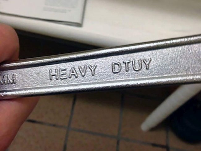

    Agreed, home mechanics get the tools that can be afforded and get the better tools as they go along. Craftsman is the most reliable low cost tool on the market that's less bound to have an open end wrench spread or a closed end wrench strip like cheap sockets will. Cheap sockets will also split/crack, and bust a knuckle as quick as the cheap wrenches will.
    The only people I've seen fetish over something are the affluent. They ask around mechanic shops to find the best, Snap-on, and purchase them because they can afford it. Yet they never will get their cash cost return from them. They know this and don't care. Good for them.
    The professional mechanics get Snap-on or the lessor cost professional tools being MAC Tools. The professionals don't fetish over the tools they get, but get them, forget about it and move on for the tools needed. No need to grind down one of those wrenches thicknesses to make it fit, or resort to using a stamped thin cheap metal wrench.

    Your darn right...Why show that cheap arse chincy thin metal piece excuse of a wrench in there...To confuse me! Mission accomplished.

    Their sockets are OK, their ratchets stuck big time. I think Husky is a lot better when it comes to cheap tools, but at this point in life I'm not even sure what brands are all in my tool box. Its a mix of what I haven't lost or broken over the years, with a handful of individual sockets and such that I've bought at autoparts stores for specific jobs. Your likely to find an Evercraft ratchet, with a husky extension hooked up to a craftsman socket as you are any one brand just because that is what I picked up off the bench.
