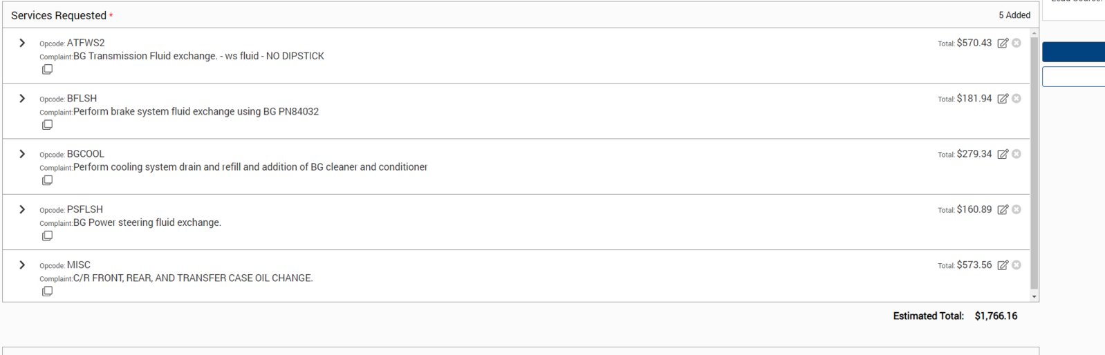

    All fluids exchanged besides oil. 2006 toyota tundra double cab. See attached.
    Thank you

  2. Mar 4, 2024 at 9:31 PM
    AZBoatHauler
    Aug 13, 2019
    #34576
    9,067
    So.Arizona
    Any chance you can do them yourself and save about $1,300?

    lots of dents
    It’s not uncommon that a professional brake and power steering “flush” consists of just using a turkey baster to empty the reservoir.

    2003 Tundra AC V8 4x4
    Most of these are basic maintenance. As a comparison on the labor vs parts, the front / rear diff and transfer oil changes take about 6 qts. of oil IIRC at about $10 each and new washers torqued to spec, so like $65 in parts/fluids.

    2020 SSM 1794 4x4
    Having the dealer do basic maintenance is insane. For those things you can't or don't want to do yourself, you can save 30-50% by having a reliable local shop doing it.

    Up to date maintenance
    I judge that quote as not surprising and reason number one why I do all those things for our vehicles.
    None of those jobs is hard or takes special tools.

    My country step-dad would call that "highway robbery"...
    All of that is work you can do yourself in a driveway. 5-6 years ago I had barely used a wrench and I taught myself how to do all this by watching YouTube and asking questions on this forum.

    I'd be planning on swapping those fluids out myself.
    Those prices aren't surprising to me though. A family member just paid the Subaru dealership $500+ dollars to swap their transmission fluid. I told them that they'd save quite a bit doing it themselves, but they didn't feel up to the task.

    06DC2wd
    Uhhh looks like theyre using BG products. Id say thats pretty fair considering the price of BG products alone.

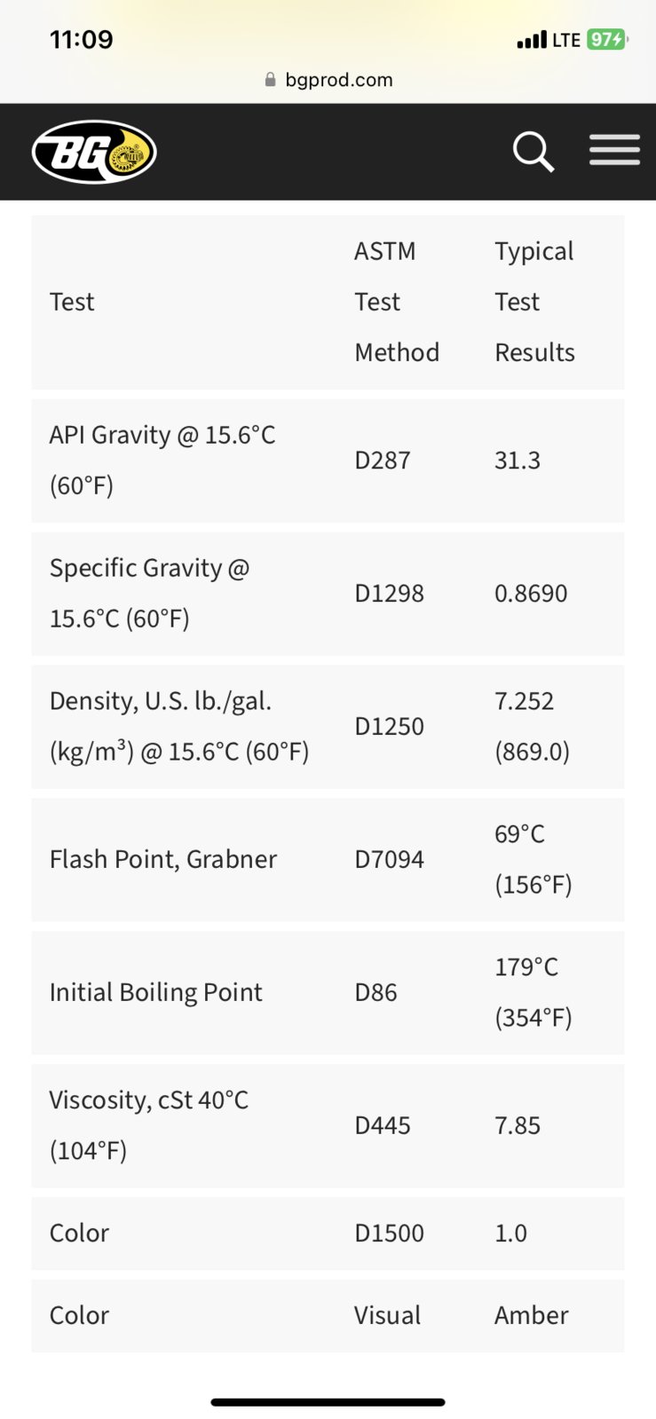

    06DC2wd
    American Society for Testing and Materials Also known as ASTM. They test damn well near every fluid you've ever used in your vehicle.

    Aware of ASTM.
    What specific ASTM tests are there with regards to engine / transmission / cooling system cleaning products, and where are the BG results that show they were exceeded?

    06DC2wd
    ALL of the tests done on BG products are listed in their product description. Along with the test type and test results.
    example 1: https://www.bgprod.com/catalog/gasoline-fuel-system/bg-platinum-44k-fuel-system-cleaner/
    Im not gonna go to ASTM's PDF files and BG's product descriptions to do all the math. You dont pay me lol but feel free to go through and take a look yourself

    2019 TRD Sport
    none of those astm test results shown relate to a products cleaning ability.

    06DC2wd
    i guess you're just gonna have to contact a BG rep. And go see a demo for yourself? Since you seem to be less inclined to offer some sort of constructive conversation.
    i simply stated the tab was expensive due to BG products being used. And their products are NOT cheap.

    2019 TRD Sport
    I have seen BG products in action, witnessed the BG rep dog and pony show, and read their sales materials. That is why I said their products were not anything special, and dealers sell BG because it helps with the profits. The main points the rep made and the brochures was how much more the shop could make by upselling this or that.
    The BG sales materials were heavy on the BS and extremely light on the technical details as to why their snake oil would be worth so much more to the consumer than what was currently offered.
    BG is expensive because there is a LOT of marketing behind it, not because the products are great.
    You boasted about BG passing ASTM and industry tests and whatnot, and clearly that statement couldn’t be backed up.
