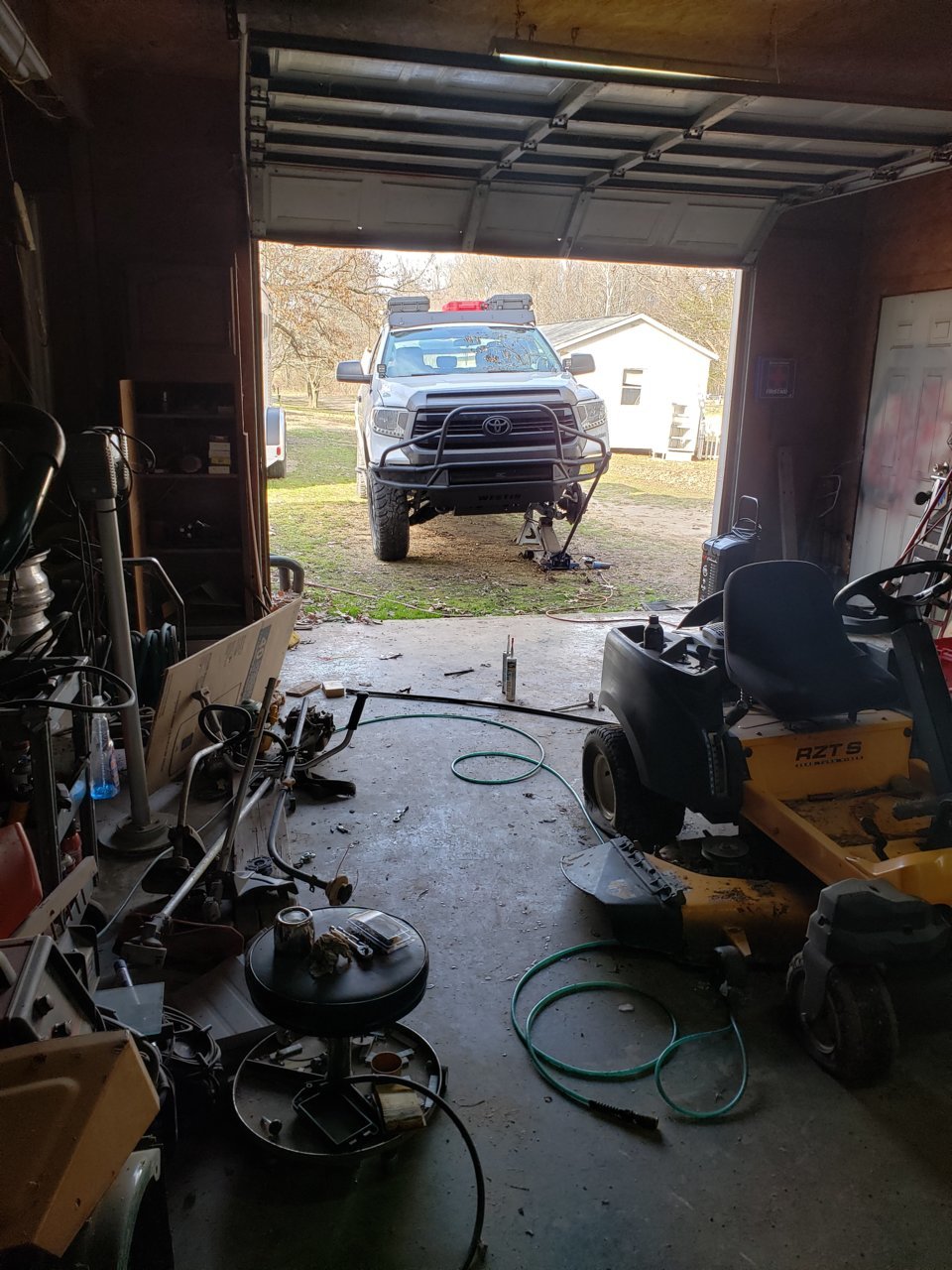

    So much more room for activities now....... 37's goin on tomorrow morning :transformer::muscleflexing:20200209_145422.jpg 20200209_144531.jpg

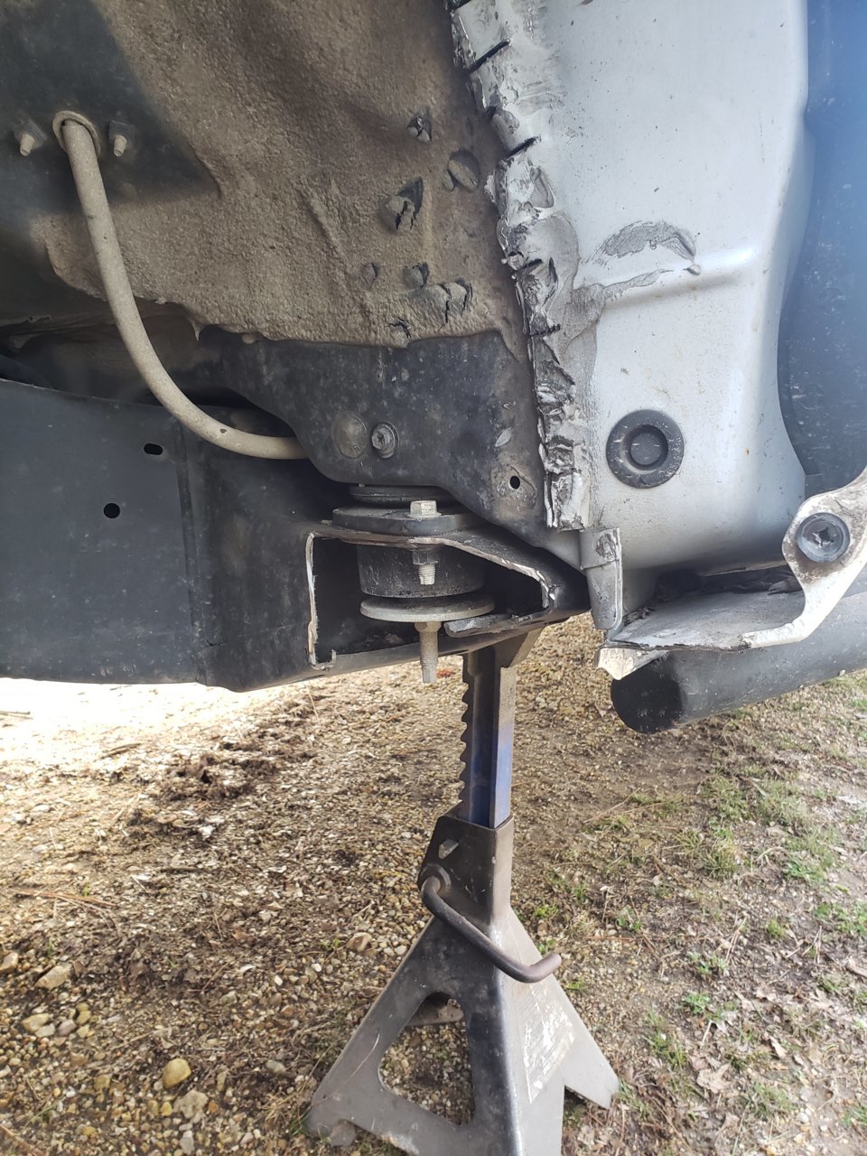

    2.5 fox 2.5 ads triple bypass T/C uppers Nfab front bumper Westin rear Bajas Rci skids All pro sliders Icon rxt leafs Stt pros Method 701s 37 Mickey Thompson
    How was the pinch weld I need to do that next

    It was easy, just ran a bunch of cuts stair stepping up the pinch weld and then hammered it flat, still gotta take a heat gun to the fender liner tomorrow when my tires/wheels go on and use some self tapping screws to hold the inside edges down. Hardest part was hitting it with a hammer at that weird angle, as you can see I missed quite a few times hahaha

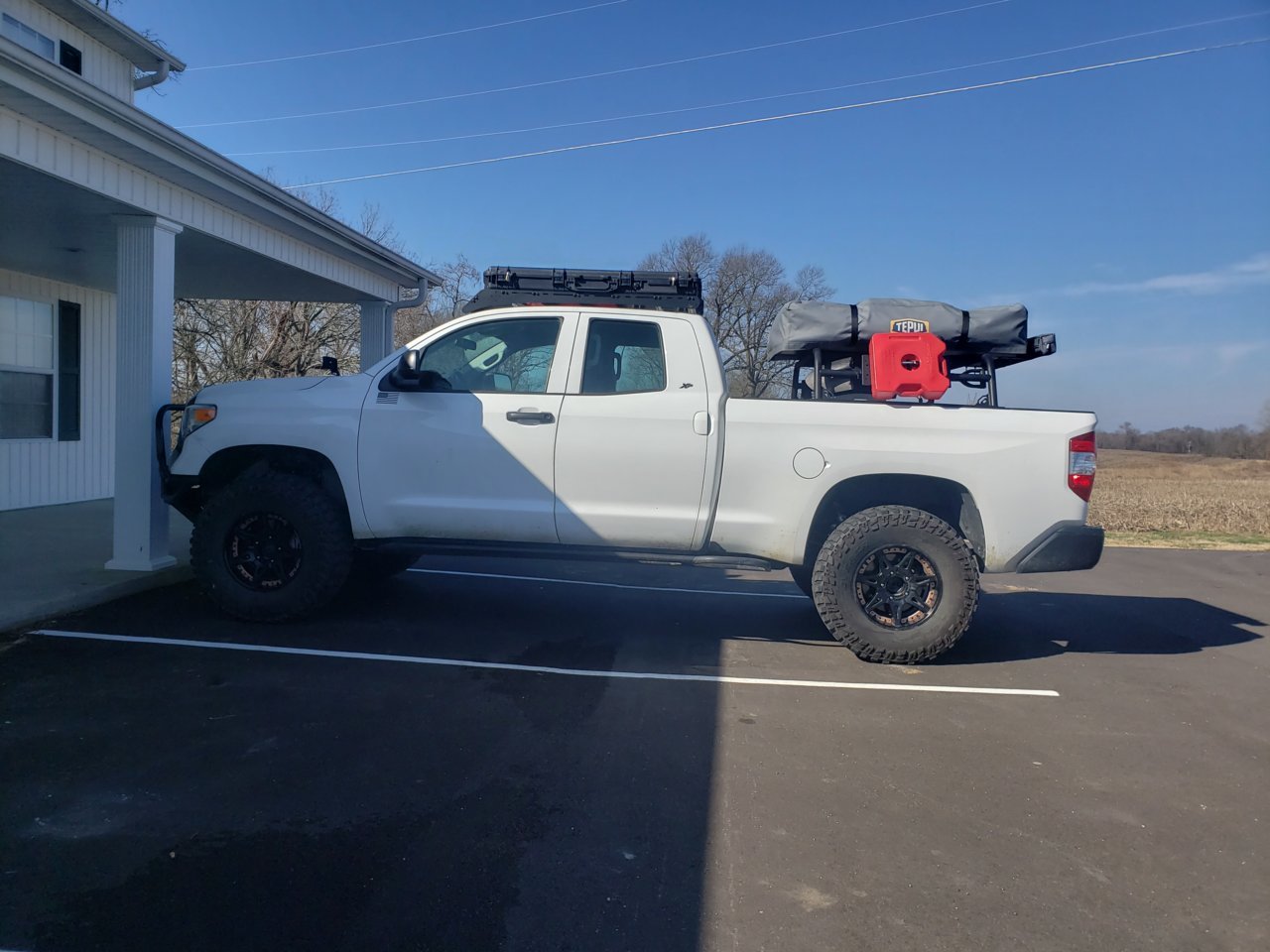

    Got some rear height added to bring it back to sitting right and not Carolina Strutting, and got the new wheels and 37's on, also added a toytec shim to driver side to fix the lean

    So that’s just bilstein 6112/5160 with the add a leaf and shims in the front? Did you do shackles? How do you like the ride quality? Exactly the stance I want and about to Pull the trigger

    Yes, 6112 in the front on highest setting with one toytec shim on drivers side, 5160 in the rear with icon/deaver leaf expansion pack and a toytec aal. Stock shackles. Rides fine, feels like a truck haha.

    I did the toytec aal today in addition to the 3 leaf expansion pack I originally put in as a stop gap for ass end sag. I keep the decked drawers and rack/rtt in the bed constantly as well as a full size spare so just giving the pack a boost. The expansion pack gives about 1.75" lift on it's own but with all the extra weight it was sagging some so I did the aal as well to bring it back to 1.75ish in the rear. Going full custom leaf pack down the road

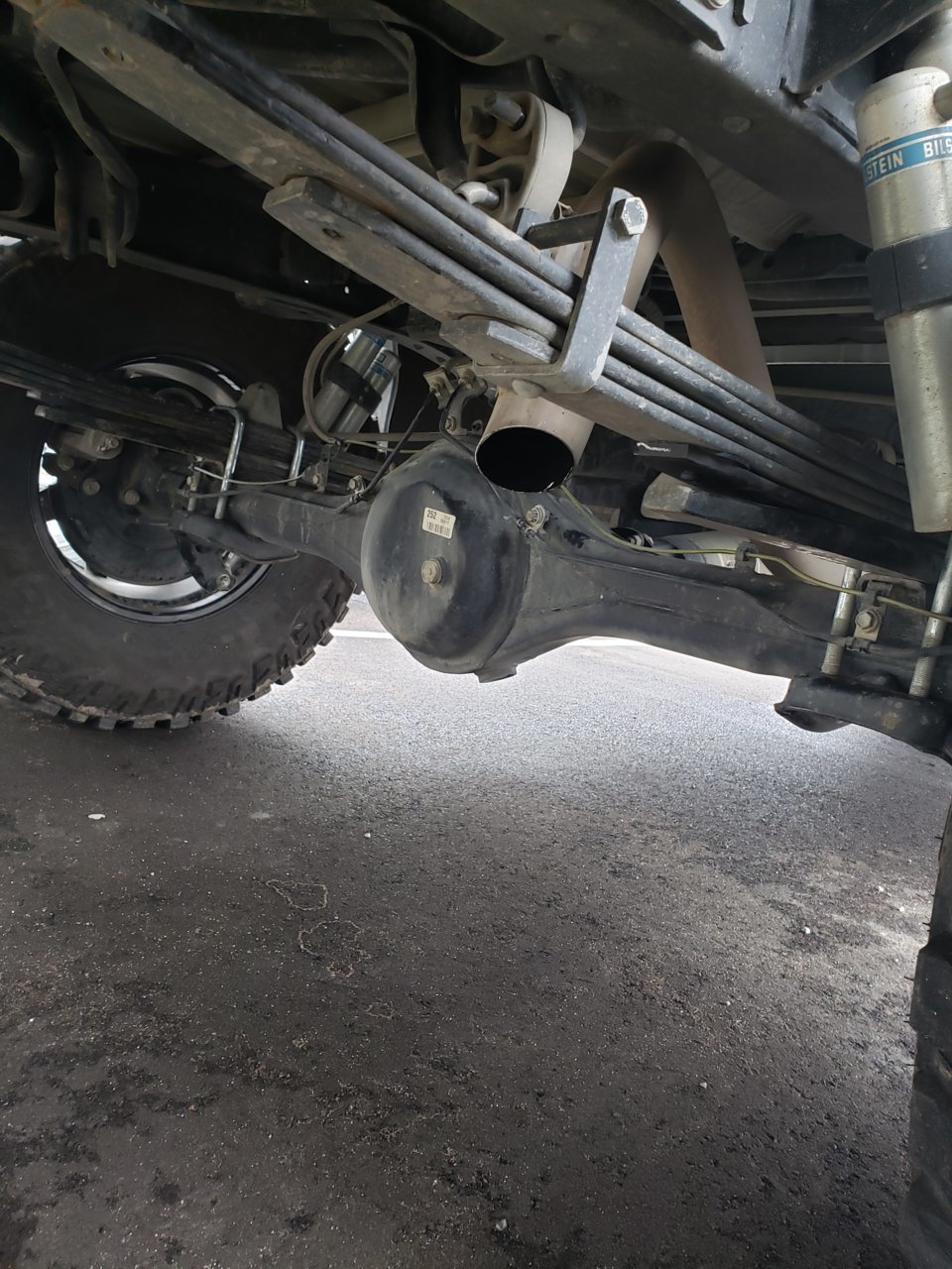

    Oh yea, cut the exhaust too, will get pics tomorrow

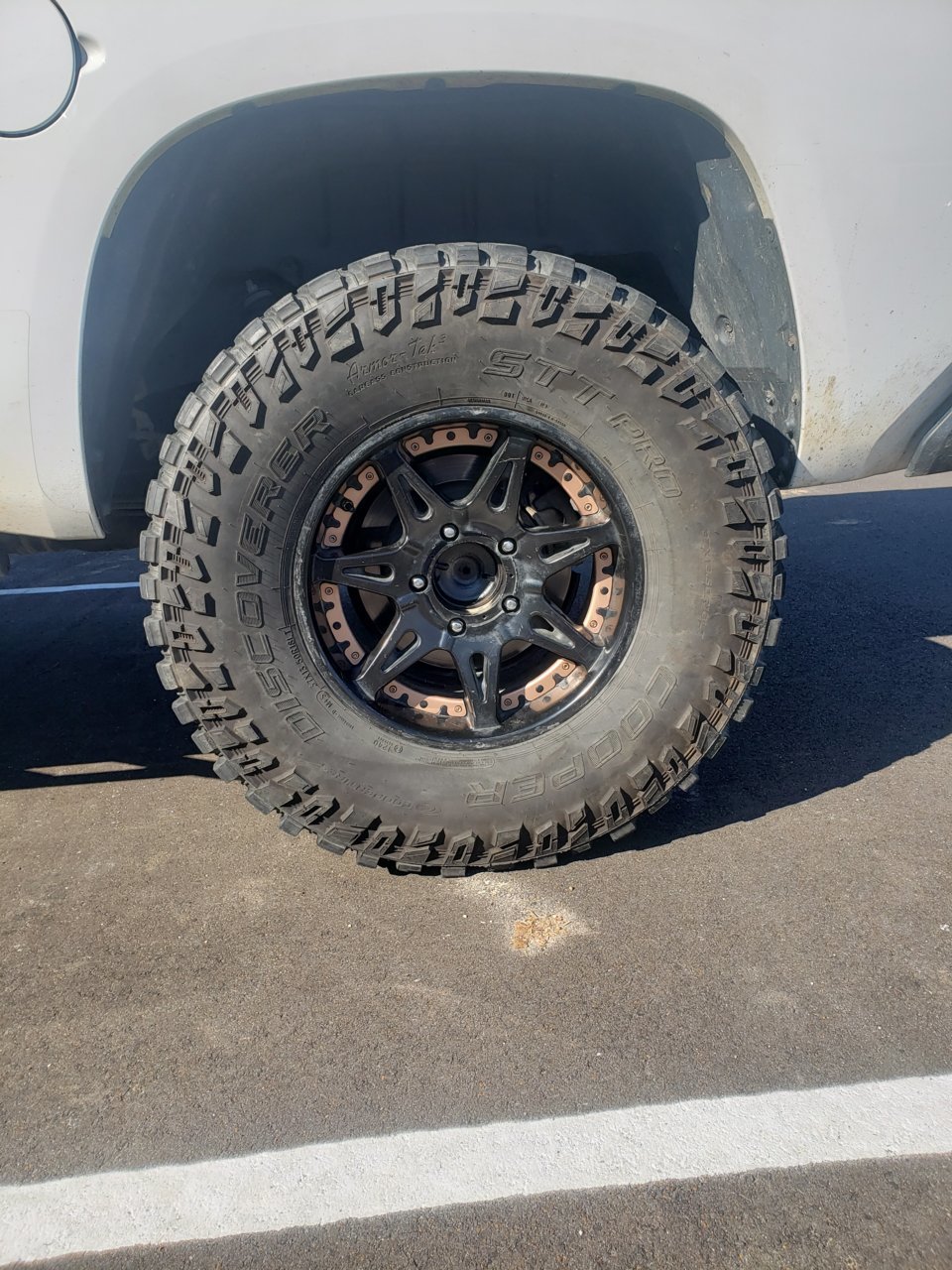

    Painted the accent pieces in the new wheels bronze last night, kinda like it.20200219_101252.jpg 20200219_101317.jpg
